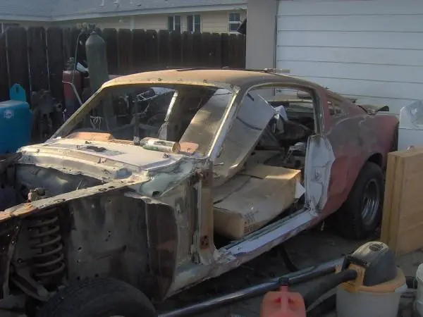

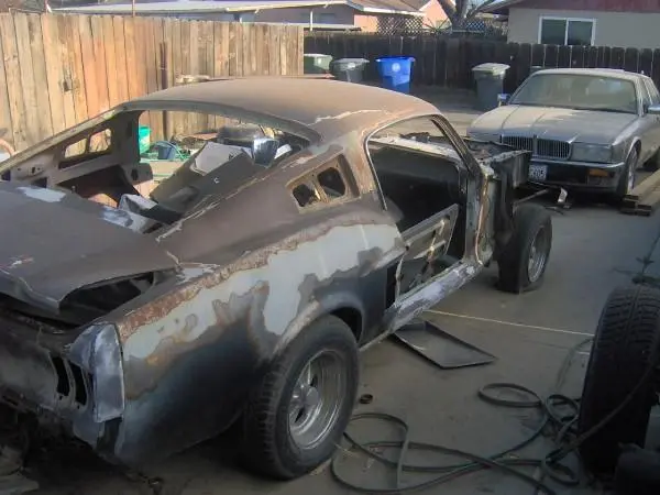

here are a few pictures

I can't tell if it was any color to be honest. it looks more like a light shade of surface rust.
I plan to get the Marti Report.. then i will know more..
