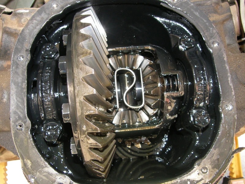

Is this an 8.8 Trac-Loc? '93 Mustang LX 'vert 5.0/AOD.
I'm doing bearings and seals as we speak. Need to know so I can add friction modifier in necessary.
Thanks in advance!

Definitely Trac-lock - you can see the clutch plates and the spring to preload the clutch packs.
