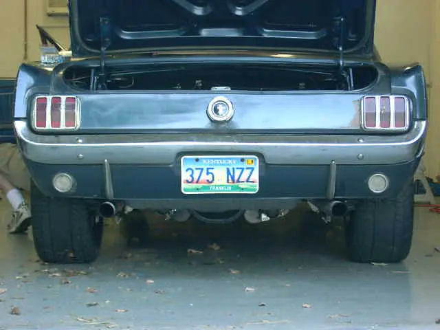

Good photos.
Have you driven the car yet?

Not yet, I have to adjust some rockers. I'll let you know if it swells enough to rub. I think if it does though I'll have enough play that I can hammer it a little more to make it stop. If these where slicks there would be no way. I've seen guys with less room inside and more hp not rub though.

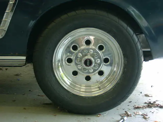

How about a pic from the side.
I'd like to see the sidewall buldge.

This is the only one I have...it really doesn't show it that well though.

IF it does swell,it would be in height,not in width,so you should be coolIif yours rubs where mine did on the inner lip where it kicks out,I "moved" mine back a little and didnt rub at all today.

Its mainly a drag car weekend warrior. I would never run this setup on a open course or whatever as I think if I tried hard turns on them they MIGHT roll like 70vert said through his research but would they roll over enough to be dangerous, probably not. The smallest recommended rim for this tire from bfg's website is 7.5 so I'm a half inch off on that but I can't count the number of people running tires that are 1-2 inches bigger than the smallest recommended rim for them at the track with way more hp than my car.
It doesn't really matter I just wanted to post that I did it, it can be done and what mods I did to do it.
If it just swells in height I'll have pleanty of room. My only concern is that I do drive it on the street but I don't drive it mach 3 around curves. For one I have skinnys up front and they really don't like that much secondly I just don't want to take the chance with my car so I take it easy around sharp curves. So hopefully it won't lean into the inner fender.

you got lots of rubber on the road, there's very little "cupping" from your measurement, and that little bulge in the sidewall isn't a bad thing for drag-style launches. So I'd have to say sounds like you'll hook up real good with that setup, and congrats for pushing the boundaries - I wanted to prove everybody wrong and get 275s on the front of a '70 but no way - I tried my rear 275s on the front first just for giggles and there was no way it would work without basically adding fender flares.
