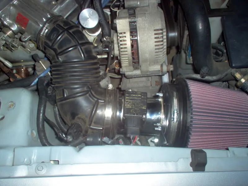

Here are the pics....

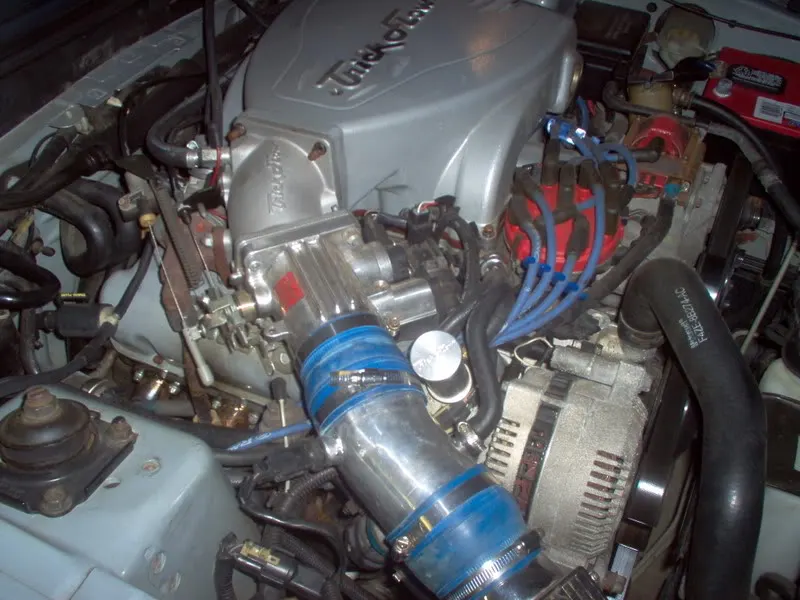

The old CAI.
the new K & N..as you look...see that the Granitelli is pushed far into the adaptor
old set up...
see the reducing end of the MAF.....

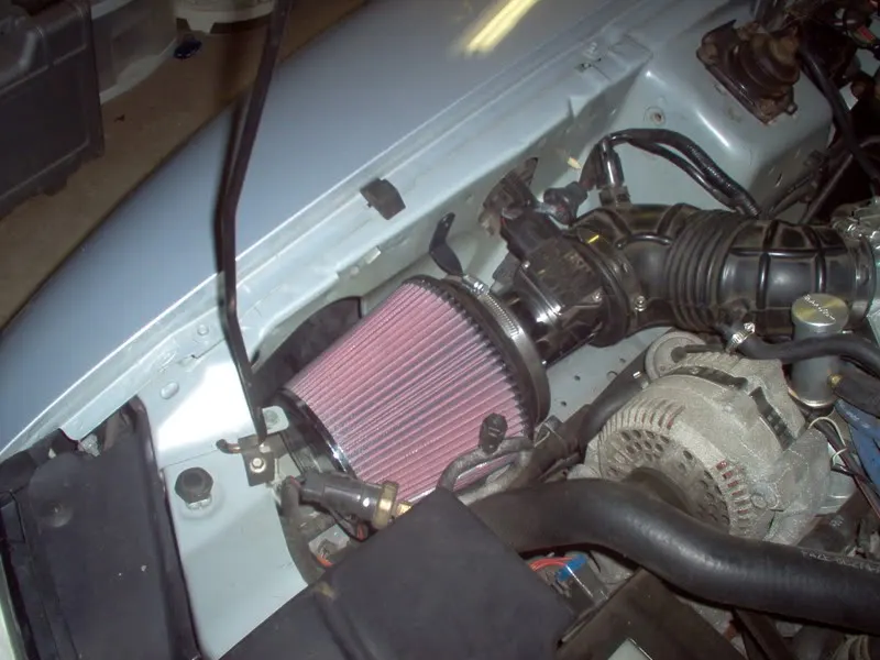

Hey Will. Ya know, I'm slow and still a little lost but I dont see anything really concerning in terms of the actual ducting (it being pushed or bunched up, etc). The underhood-filter and turbulence is still in my mind though. I still might try clocking the meter a bit and see if it helps. Or rig up a shield of some sort (driver side of the air filter. I think cardboard would work for some OhighO desert testing. :D ).

I don't think I am conveying my thoughts properly JT.....the old piping kinda bunched up...that why I cut the 90 bend out of the fender and ran it straight.......the issue I am questioning now is that MAF is about 2 to 3 inches into the stock tubing and I'm not so sure is it sealed 100 percent under heavy load....It runs fine daily playing......the time it does see...but when I had my foot through the floorboard at hi rpm it made a kinda popping....like one loud burst of air...the car hesitating just for second and then shifting...it did it once each run...3 out of 4 times...whether I manually shifted or left in D.....once 1st to 2nd and then twice 2nd to 3rd gear....may have have a experiment....and for that.....I require the track......
this is the best pic to show it.......the part of the MAF that enters to the left is 2 to 3 inches into the black piping.....the diameter is way to small at the end and it then expands and a small angle.......I have the bolt as tight as I can get it but not sure if it is a issue at WOT......

For quick diagnostics, I'd consider taping the crap out of that connection (to try and increase the certainty that it's air tight).
More permanently (but not expensive): The only thing I'd be able to cobble together is: to measure the OD of that MAF housing. Then hit the home store - see if the plumbing section has a rubber doo-hickey (Fernco type connectors). Put that one the MAF flange and slide the whole enchilada into the rubber inlet tubing.
As it is now, I can imagine that you could see possible seepage (unmetered air) during transient throttle maneuvers.

The plastic thing in the bottom left corner of this pic (it goes up the inner fender) was what I couldnt figure out before. I dont think I have one of those. :p
JT......the Red Green comment was about the duct tape.......every time I watched him he fixed something with duct tape.........he cracked me up :rlaugh:
the black piece covers my head lights and goes all the way across.....you can lift up the corners to get the headlights.... iirc.........my old 6 vert had it too....
