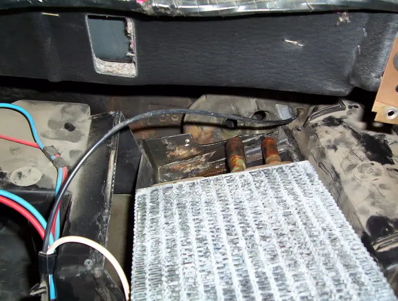

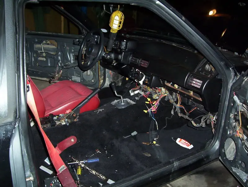

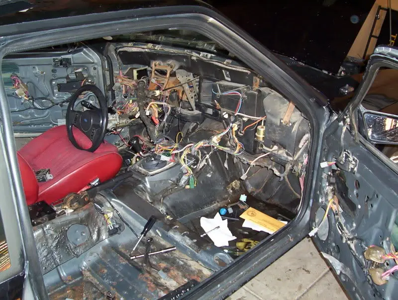

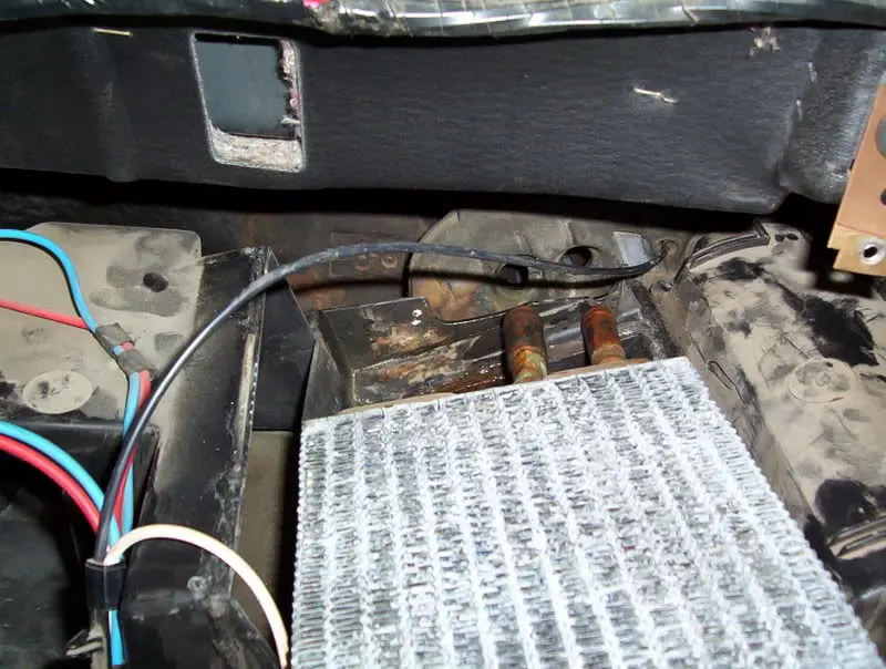

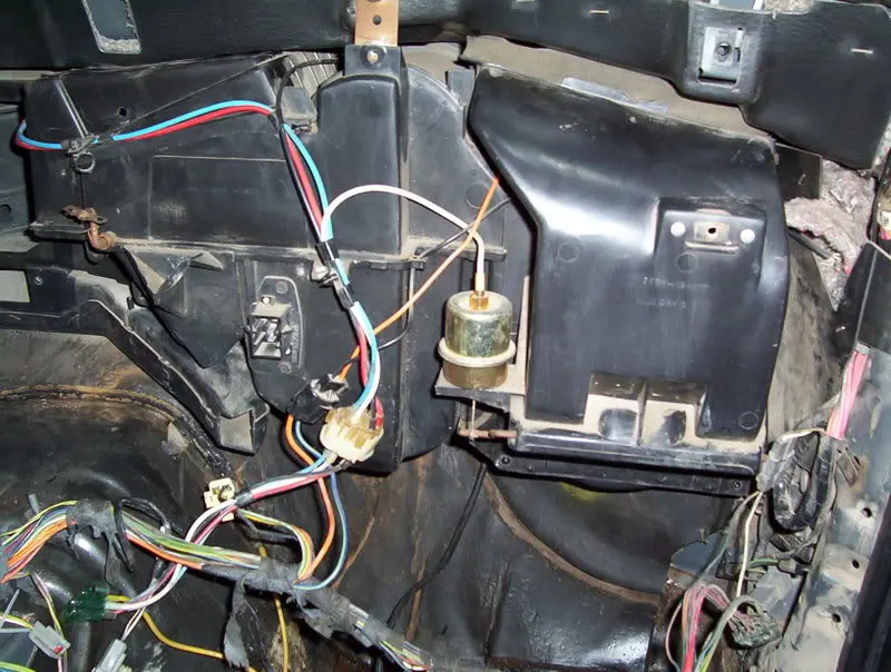

well as they say the heater core takes like 5.5 hours to do. I think not. I did it in 2 hours. That is including painting all of the interior. first I removed all the int because I am inst black everything this weekend. Those pics will come Fri or Sat.

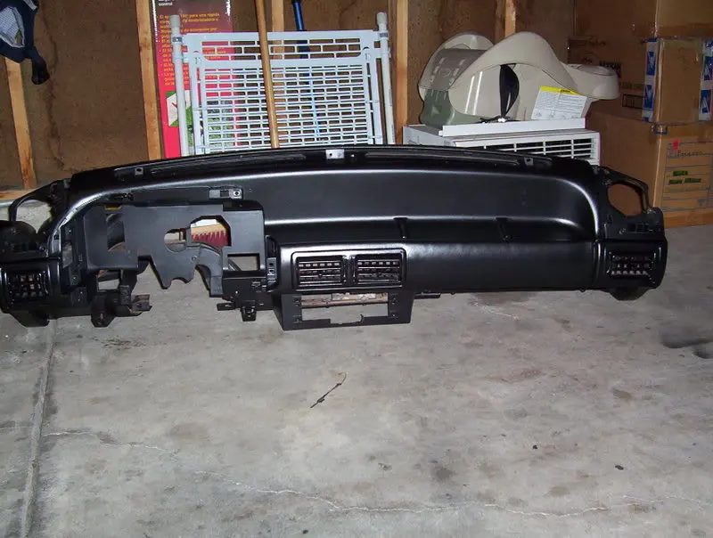

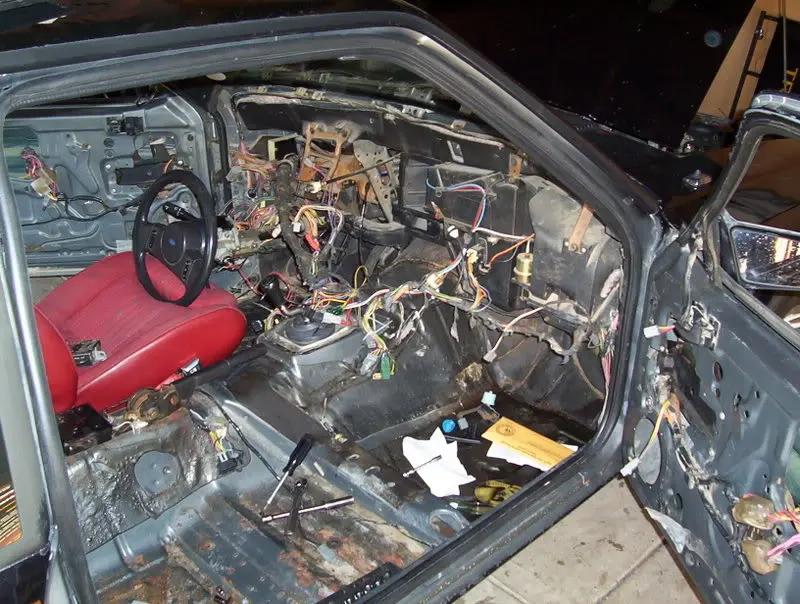

First I pulled the whole dash out. Took like 30 min to do. Reall easy

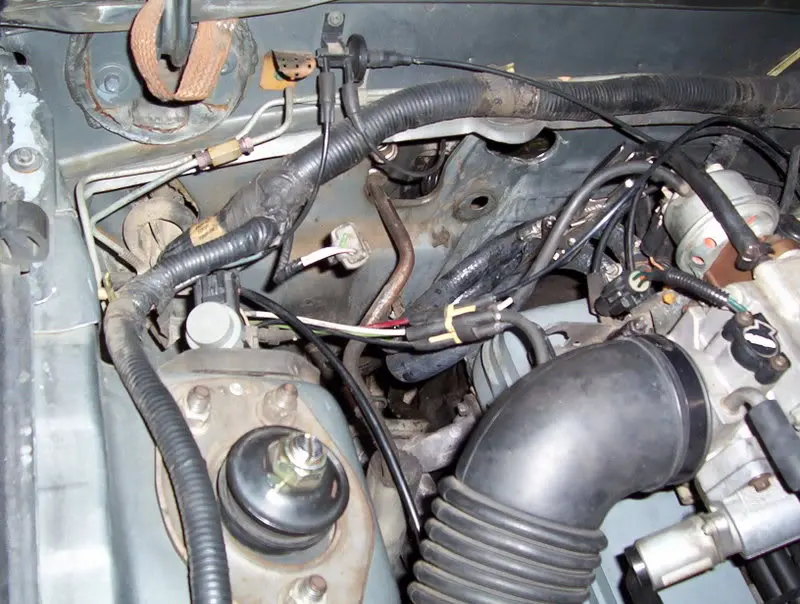

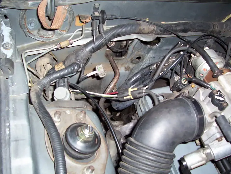

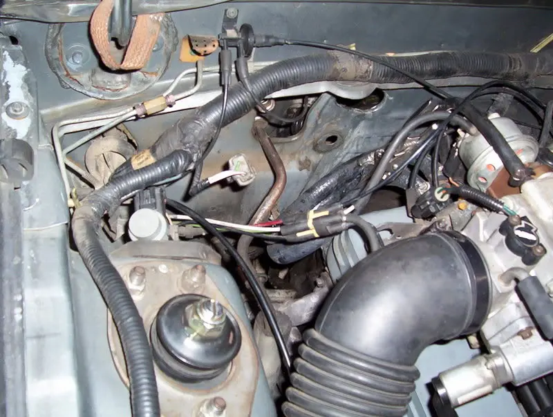

second I went into the engine bay and clamped off the heater hose lines from the intake. There is no point in draining the entire cooling system for a job that doesn't need it. I just flushed the whole system last month. I removed the a\c canister and layed it over by the compressor. I am converting from R12 to 134A. and now is the time to do it.

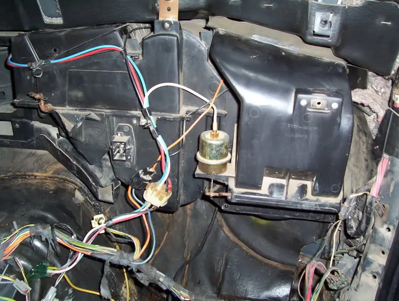

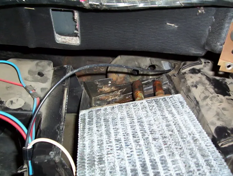

third I pulled the entire assy into the car and had access right to the top of the core. Easy as pie. replaced the core and cleaned out all the dust inside the assy.
Finally I just put it back together and wa la. One changed heater core. I am gonna clean all the inside bay the firewall and all the harnesses and all that crap before I put it together again. I also am gonna wrap my ducts with tape to prevent leaks. I also used high adhesive weather stripping glue and sealed the entire fire wall around all components going into the engine bay. Make sure it is water tight before the new carpet.
I will post pics tommorow of the carpet inst and the black int. I still am waiting for the headliner and the seats to arrive. All else is gonna be good. Sorry for the long post but its resto time. :nice:

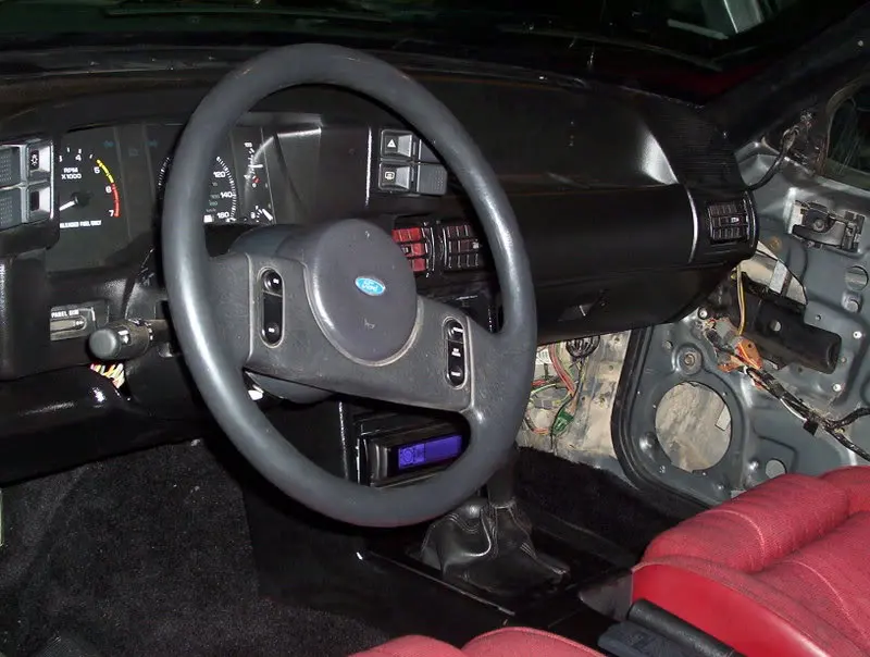

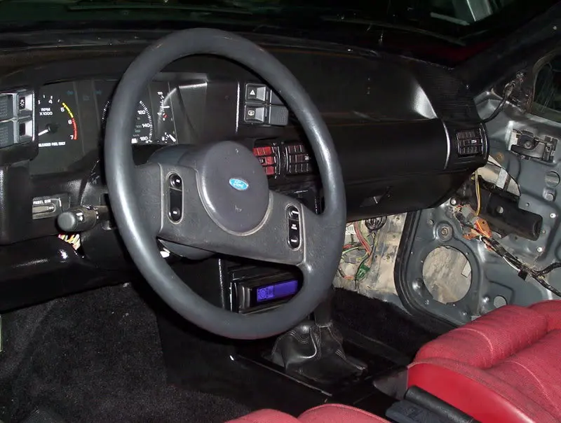

I did it in 2 hours. It isnt as hard as everyone says it is. People leave there dash in which makes it a pain in the but. If you do what they do and hang it half way pust pull the other 4 screws and pull it out. gives you access to the whole thing. I also removed the bolts that hold the assy from inside the eng bay which allowed it to fall into to cab. Putting the heater core right there.

30 minutes to pull the whole dash out.
How can you remove the entire dash that fast,there`s tons of stuff to disconnect?
Hope it goes back together ok with no left over screws.

The first time you do it, if you do it like the books and write-ups say, will take about 5 hours. After you do it once, or if you listen to the right people off the bat, it takes like 2 hours. There are alot of corners that can be cut. If its just a heater core and no ac all you have to do is get the dash pulled out enough to reach the heater box.

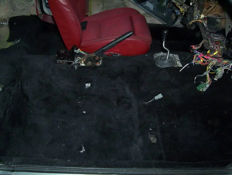

interior is going in

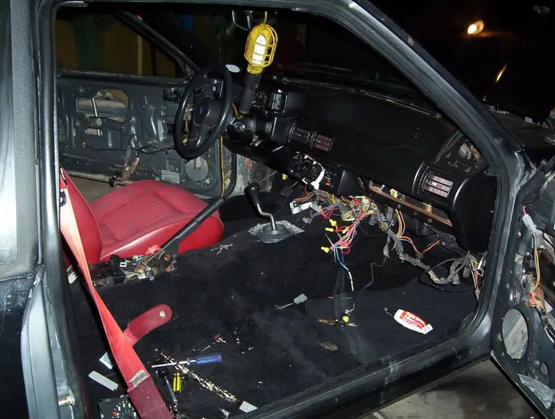

Well I got the core done and the rest painted and started to do the inst this weekend. Took the car out to my garage that we all use. It is an 8 car garage with 2 roll up stalls and we are gonna put the booth in the back corner next to it we are putting the lift.

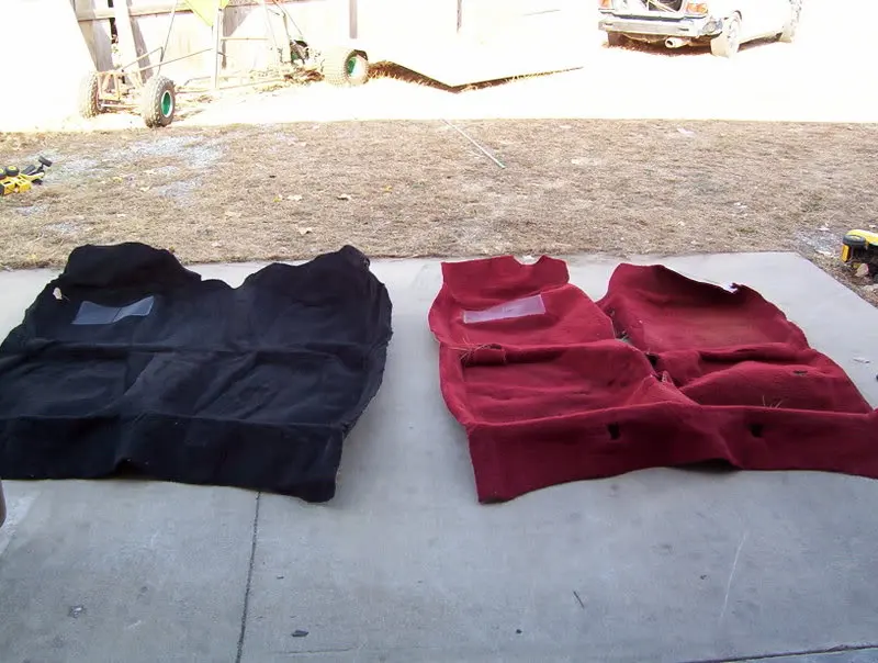

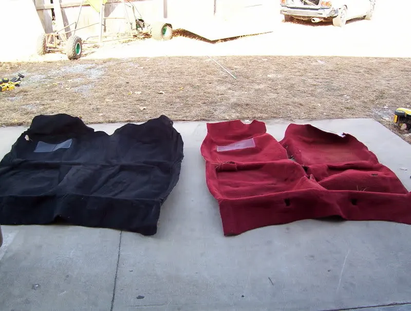

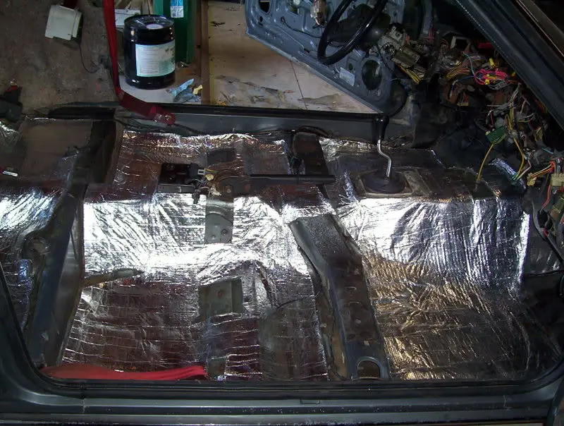

new and old carpet

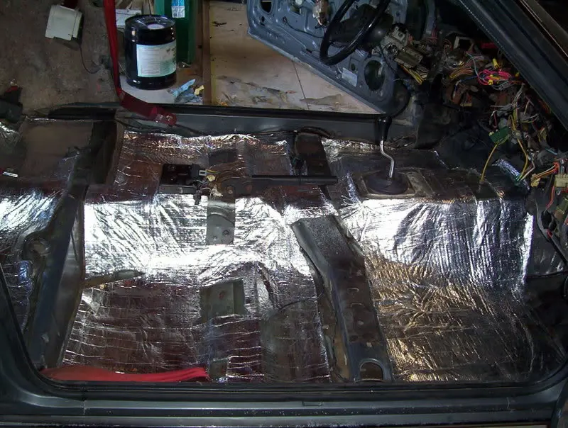

dyno mat installed

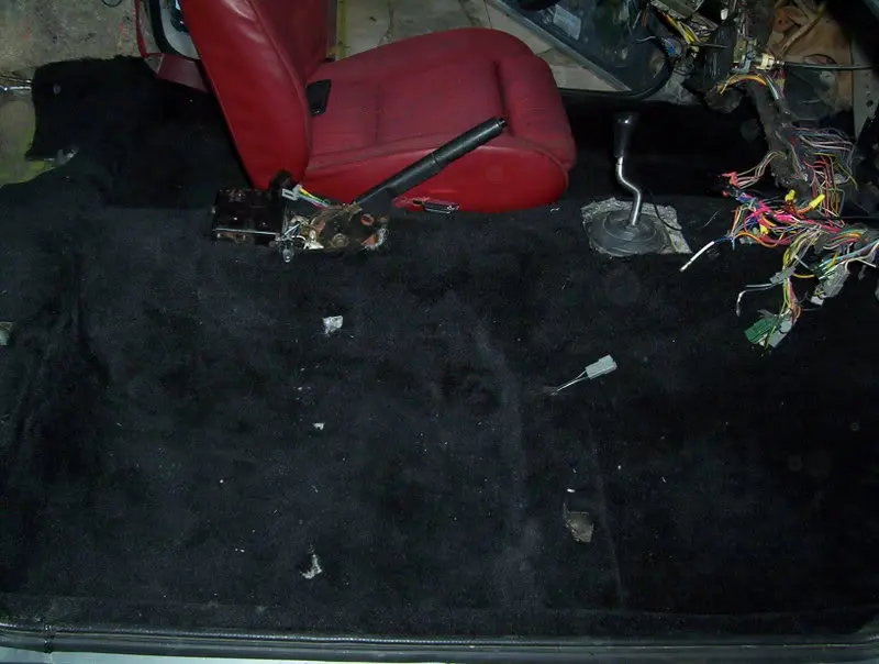

carpet layed in and installed

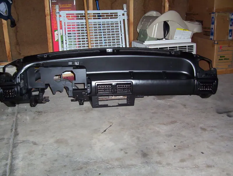

dash painted and ready to inst
ass it sets as of now.

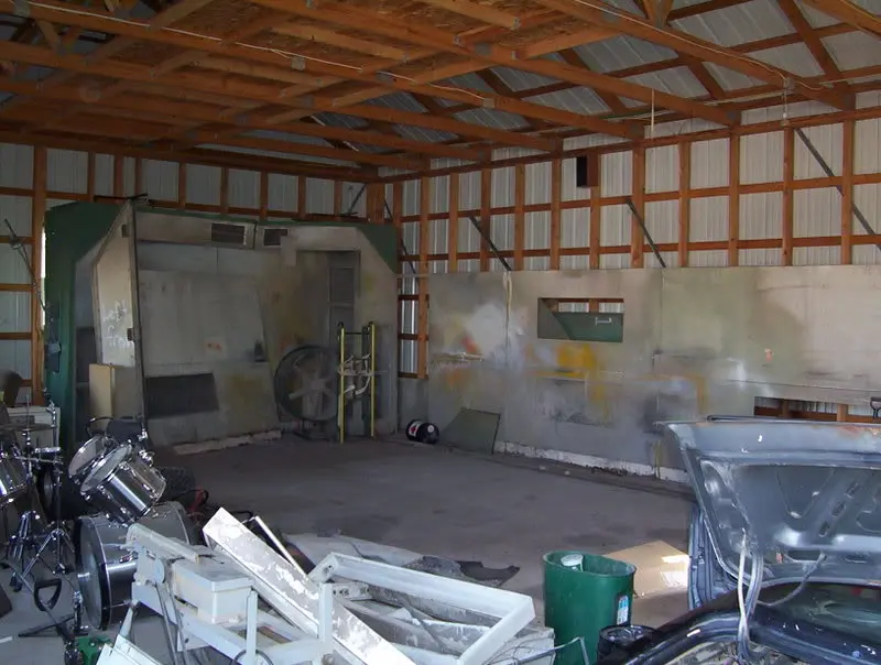

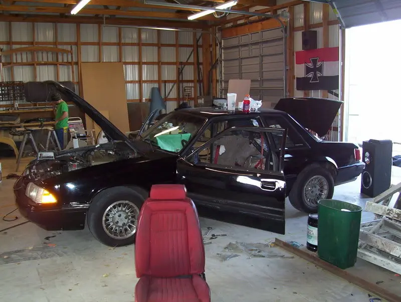

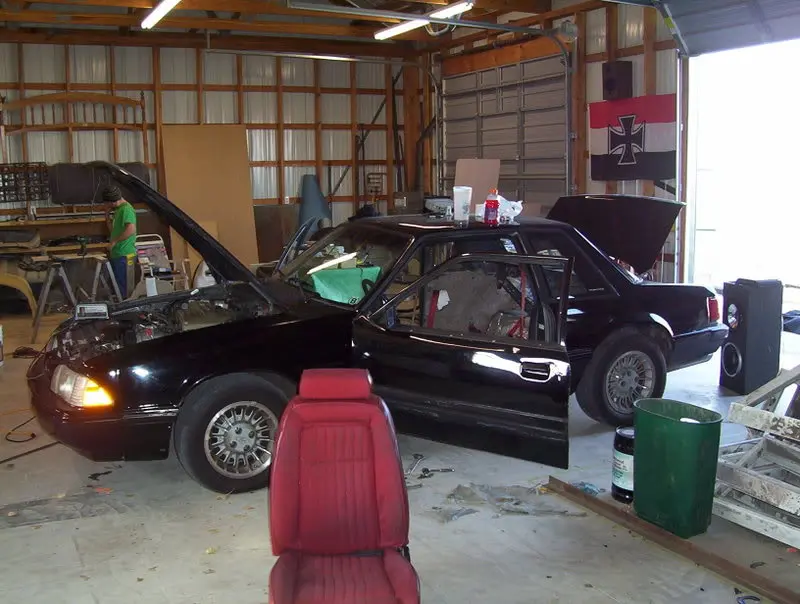

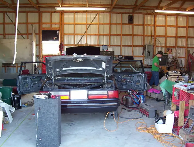

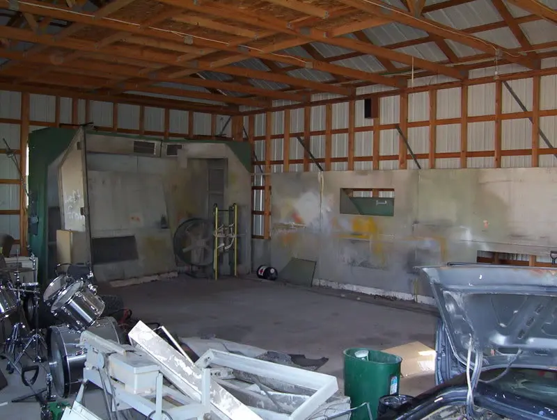

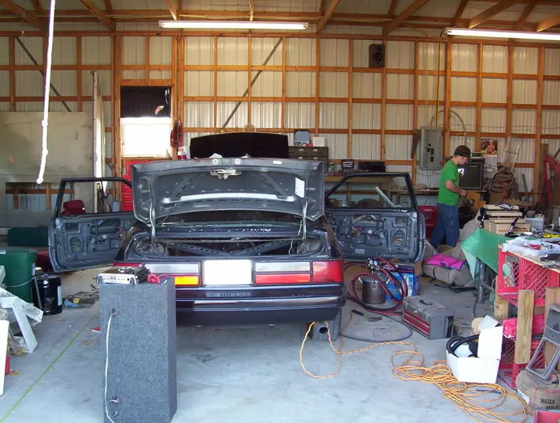

The wife works and I have my son so I don't have time to work on it today. I am replacing all the screws and any bod mounts and getting the harness all tucked up good and out of the way and replaced a lot of wires that were looking pretty gaggly. here are some pics of the paintbooth that we just got and around the shop of some of the other guys projects and interest. The honda has all gator int. and shaved everything. Once we get the ducting for the booth it will be the first to roll is. Mine is gonna roll in this spring. I need color inputs from you guys.

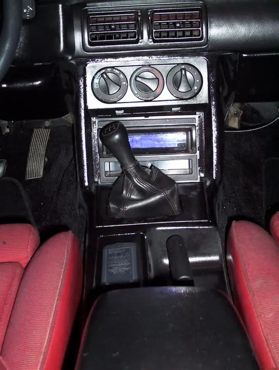

int almost done rims next

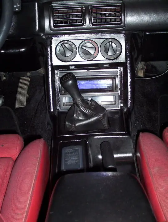

well I still am waiting on the door cards to come in. I am getting the red fabric removed and black inst with the pony emblem stiched into it. Also on the bottom where that pocket was I am getting it make smooth. Need the headliner and the kinckpanels also to be put in. I know what you are thinking. RED SEATS WITH ALL BLACK. They are gonna get changed. I am still shopping for the ones that I want. I have sat in some nice seats and some bad ones to. It all takes time. Now onto rims. im thinking 16's http://www.americanmuscle.com/16x8-4lug-cobra-r-silver.html
I dont know if i should go chrome or not. Way to expensive for me right now. I am leaning heavily on those though. I am also for christmas getting the whole billet package for the int. the vents, a/c knobs, window and lock switches, shift foot bezal, and door seal plates. I just got the int in last night and couldn't wait for the drive. The carpet needs vacumed out though. It is so quite inside my car now that I have all that new mat and carpet down. It is dusty from the roads down to the shop last night. Sorry for the dirty look on a new int
