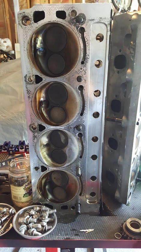

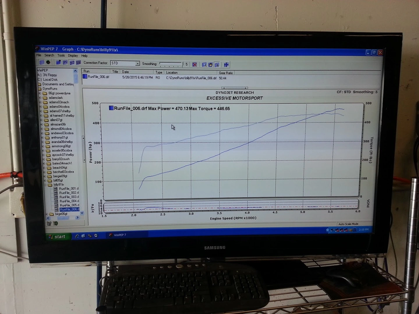

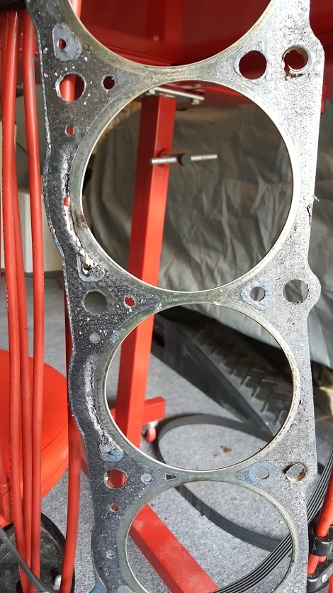

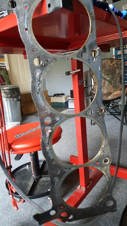

My set up is typical cookie cutter simple, why do I keep blowing my head gaskets??? This will be the second time in the last couple of months. Do you think I should get it retuned? Last time it smoked the gaskets between 3-4 and 6-7 and I think it will be the same case this time.
AFR165 heads
9333 PT1's
306 bottom end
block appears fine
Custom dyno tune
Aeromotive 340 pump
42lb injectors
Autolite Copper plug gap at 28
AFR guage is reading 12.5- 12.9 when in boost
about 12#s of boost
This sucks..... I need a guru, Please discuss

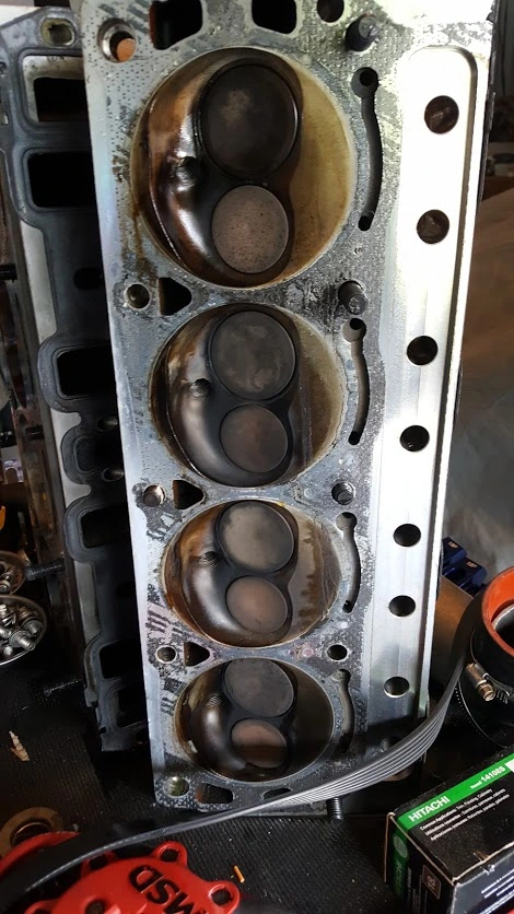

Smoked!
The same as last time.... between 3-4 and 6-7. I believe its running lean at high rpms. I will be straight edging the block tonight and I need some more information.
