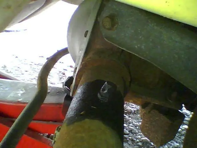

this may not be a huge deal but up and under my newly purchased 99, its pretty rusty. the floor pans/body looks fine but like the axle, control arms, bolts and nuts, etc are definetly brown :( . i crawled up under my 95 to compare....its quite a bit cleaner than the 99 with the axle and such still being black. there is 0 rust anywhere on the exterior of the car or inside the trunk, jams, etc on the 99.
i made another thread asking about a leak on my rear axle. i took a pic to show it but look at the axle and the rust. is that normal? any of your cars look like this underneath? the car has been in KY for the past 4 years and kept in a garage, previously was in MO and IN for a short time.
can i get my car undercoated? will this stop the rust ( i know it will look better ) ? what do they use when they undercoat?

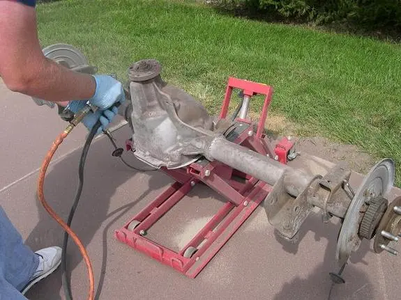

Best bet to get it REALLY clean is to sand blast it, prime, then seal. Good luck finding a auto or body shop that has a lift and is willing to let you blast in their shop, or has the facilities to blast an entire car when its still put together.

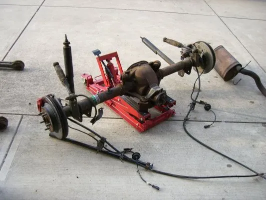

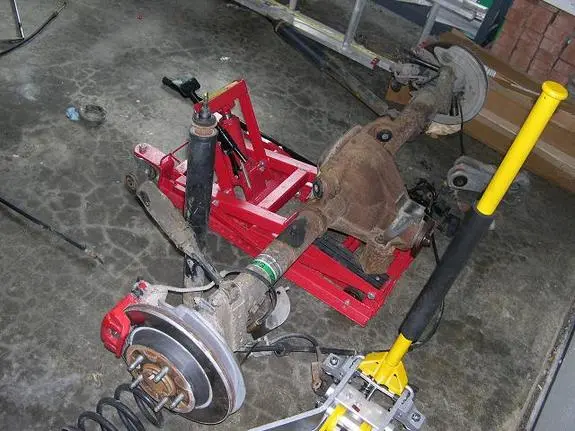

I worked on a 99 once that literally had rusting floor boards, and the exhaust was so rusted the brackets no longer existed, just the pipes were holding the whole thing onto the car...oh and the kicker! LOL... I had him pull the e-brake, and SNAP he ripped it out of the floor pan!!! :shock: i took the rear end out of it, and 5hrs of media blasting it looked pretty good...
Here are some pics for reference of how rusty even a 99/00 can be when neglected:
^^very eww...
^^so nasty! (also, notice the vent is just like yours, previous guy overfilled it!)
^^Halfway there...
^^reprimed, then painted, then installed (later I built it, then sold it haha).
Good luck, and also if you're really afraid of super rusty spots wire brush them down to bare metal, then prime them with a rust cover primer, then paint them with a rust cover paint - they will slow the decay and help keep your car from becoming a big rattle box.
