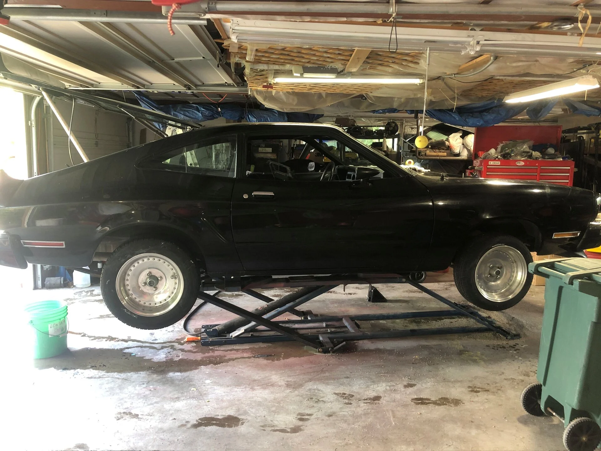

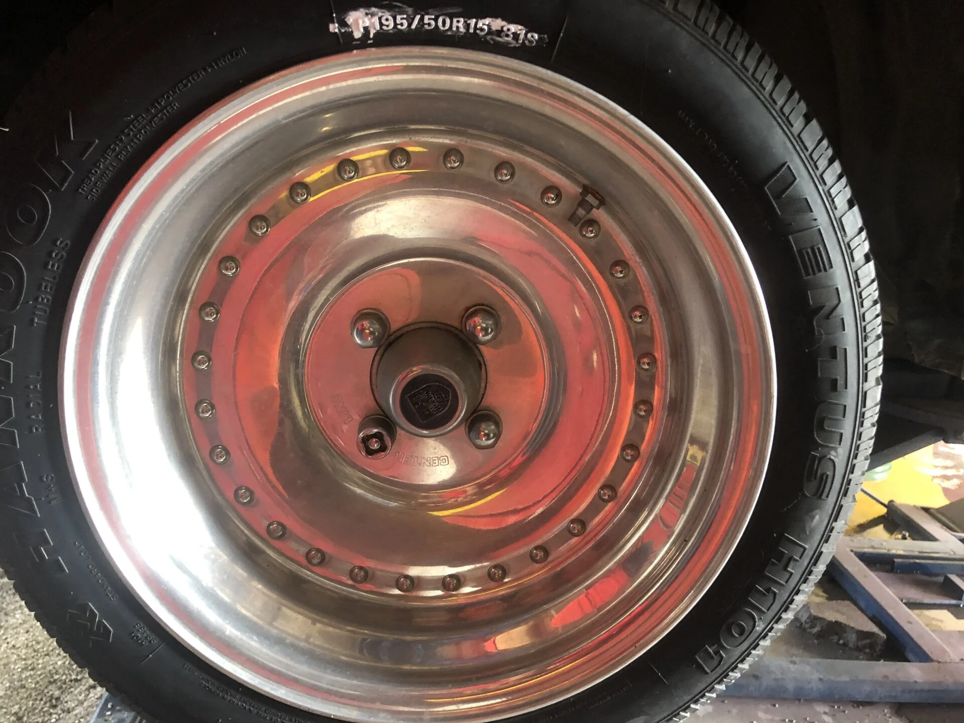

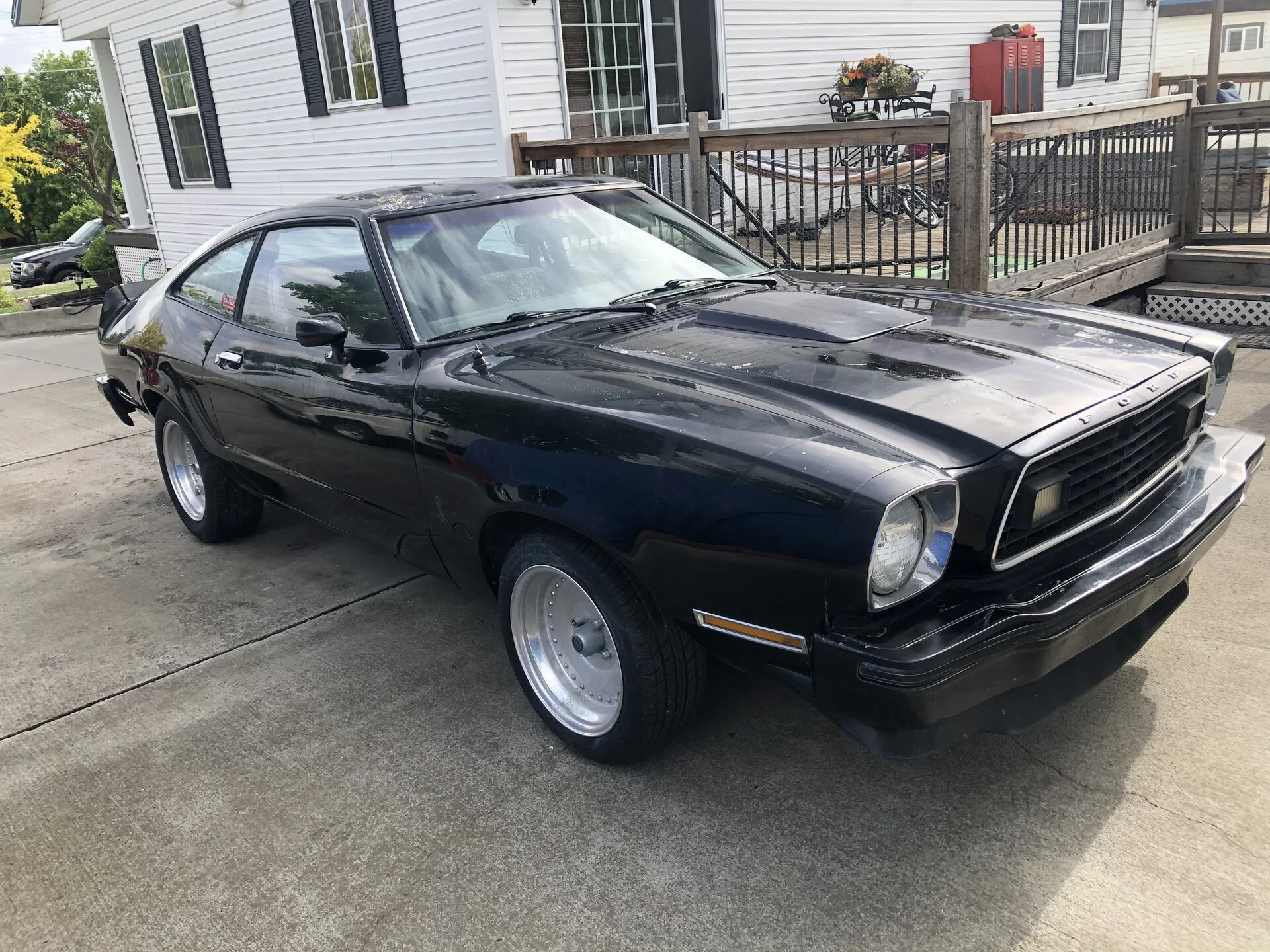

Larry here from Oregon. I have started a new thread, as least I think I have for my King Cobra build here in Oregon. Update for new readers, or is the correct verbiage Threadies?? Bought car in Washington state and bright here to Oregon. I was working on my 79 Pace car but painted it a ruby red and HATE the color. Then this ii came up for sale from a buddy in Washington. Wife told him to select a car to sleep in or get rid of at least one.......been there myself. So I bought it. As shown it is all black with 302 and OEM interior. Car is very straight. To he honest, it is impressively straight of a car this experienced..... Clear is coming off. Pulled engine and transmission. Engine is a resent rebuild. I have a professionally rebuilt T-5 to install. Will be painting Ford Triple Yellow. Using urethane paint and clear. Never been to painting school, self taught but my mentor said painting over the OEM paint that does not show metal is the way to go. Installing Edelbrock heads and MSD ignition. When I owned an LED brake light business I designed a dash insert that would replace gauges with either VDO or Autometer gauges. I like the rims but need to get them polished. Want raised white letter tires. Typing correction does not work. Photos attached. Engine is pulled, getting ready to start body work. More photos to follow.

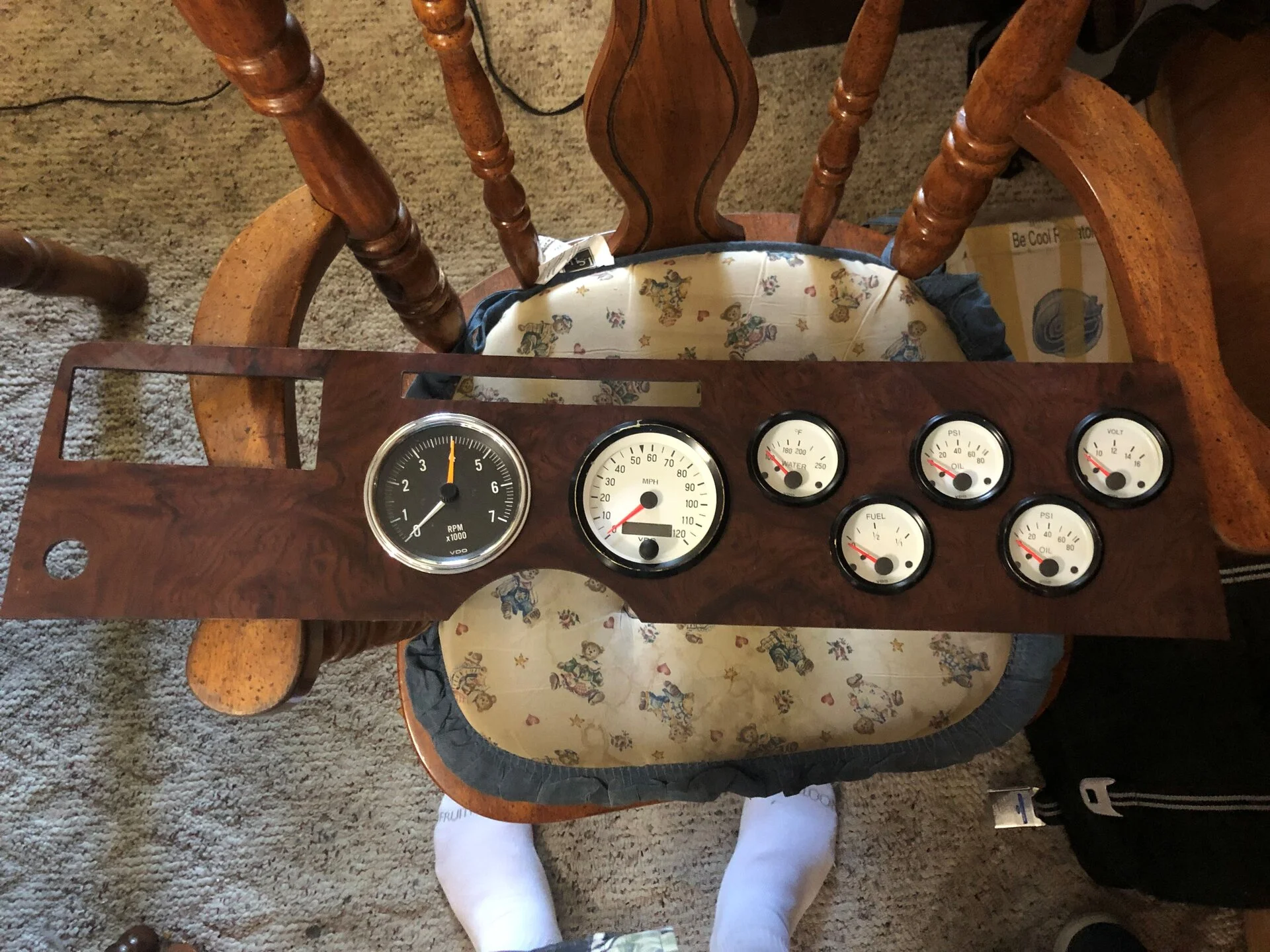

OOps forgot. Can anyone recommend a set of coil overs and tubular control arms? Thought a search would be easy but there are so many. Not building a race/drag car, just a nice show and good driver. Just ordered Edlebrock heads and CDO tach for my dash. Hard to find the one I wanted, so bought today just incase VDO does not make the cockpit tach anymore. Looked on their website but did not see it. Only the black cockpit gauge.

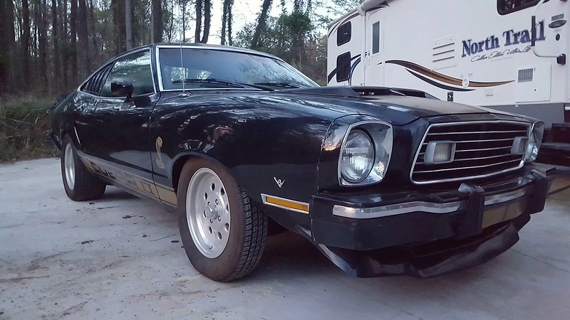

My front end is similar too. I used polyurethane bushings everywhere up front, bought replacement front springs (I asked for 4 cylinder springs, but I don't think they sell different spring rates at the parts stores...) and cut about a coil from them before installation with standard issue Monroe shocks. It isn't a soft ride like it was stock. Obviously, looking at my car's set up, it's NOT built for cornering but it doesn't do too bad on the road even with the skinny tires on front. The rear is completely stock - rubber bushings everywhere, stock replacement springs, standard Monroe shocks, etc. The only thing different from stock is I replaced the spring plate with Southside Machine lift bars. Apparently they don't make them anymore, but here is a pic of what they are from another member here on Stangnet, @parthos
And a gratuitous pic of my car for reference. ;)
