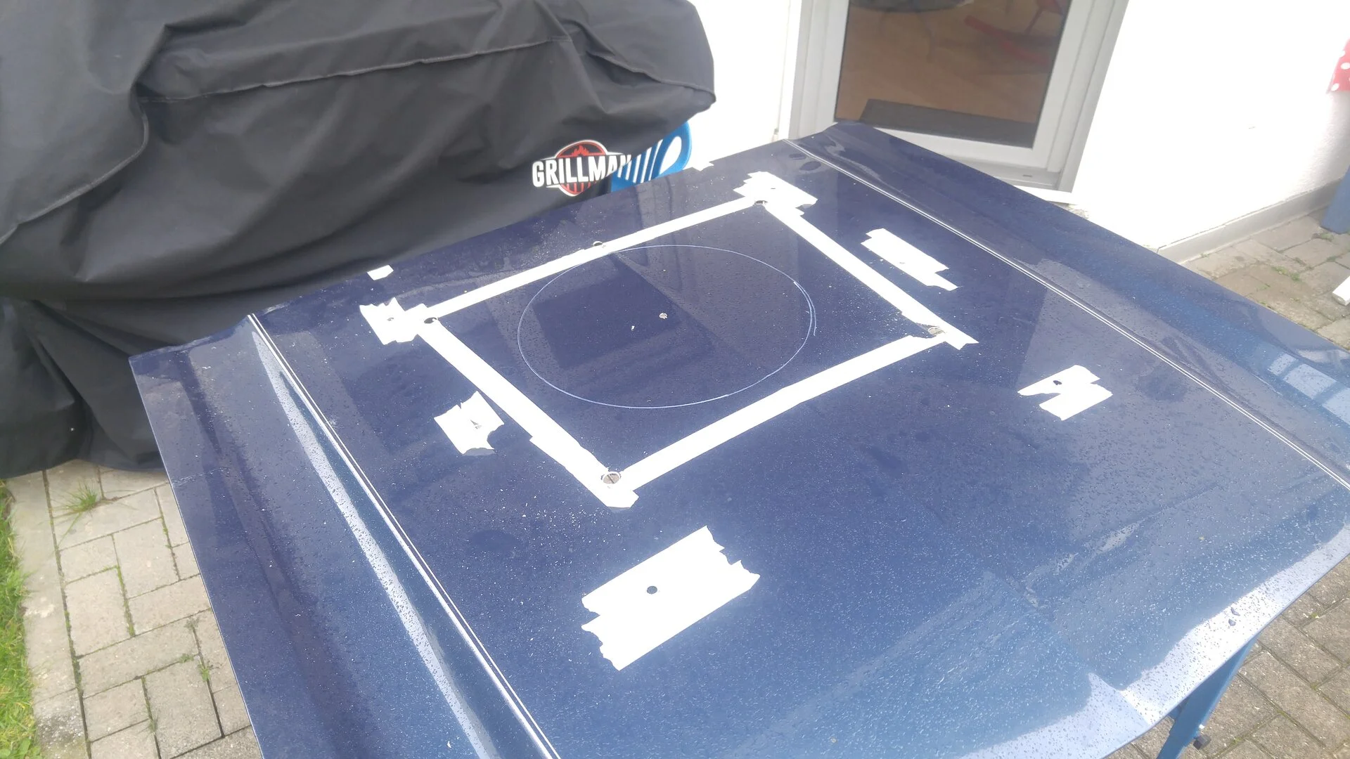

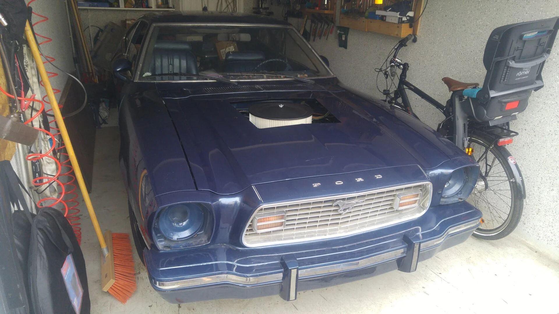

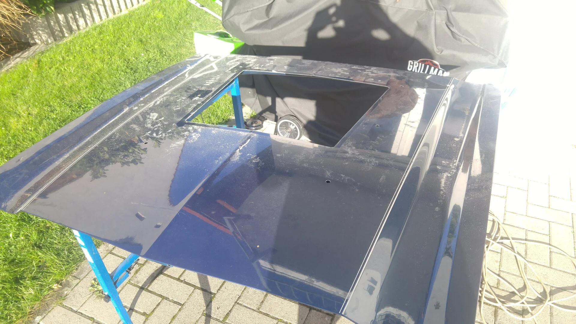

Topic 1. I know this may be, only spoken in low voices, and in back rooms, but has anyone cut the hood under the air scoop to increase airflow? Just wondering. Was cleaning my air scoop/hood today getting ready for paint and the idea crossed my mine.
Topic 2. I always liked the rear window louvers. However, it has been pointed out they are hard to see out of. Anyone have this installed? Do you like or hate them? Taking ideas before ordering one. It is at the bottom of the list. Thanks,

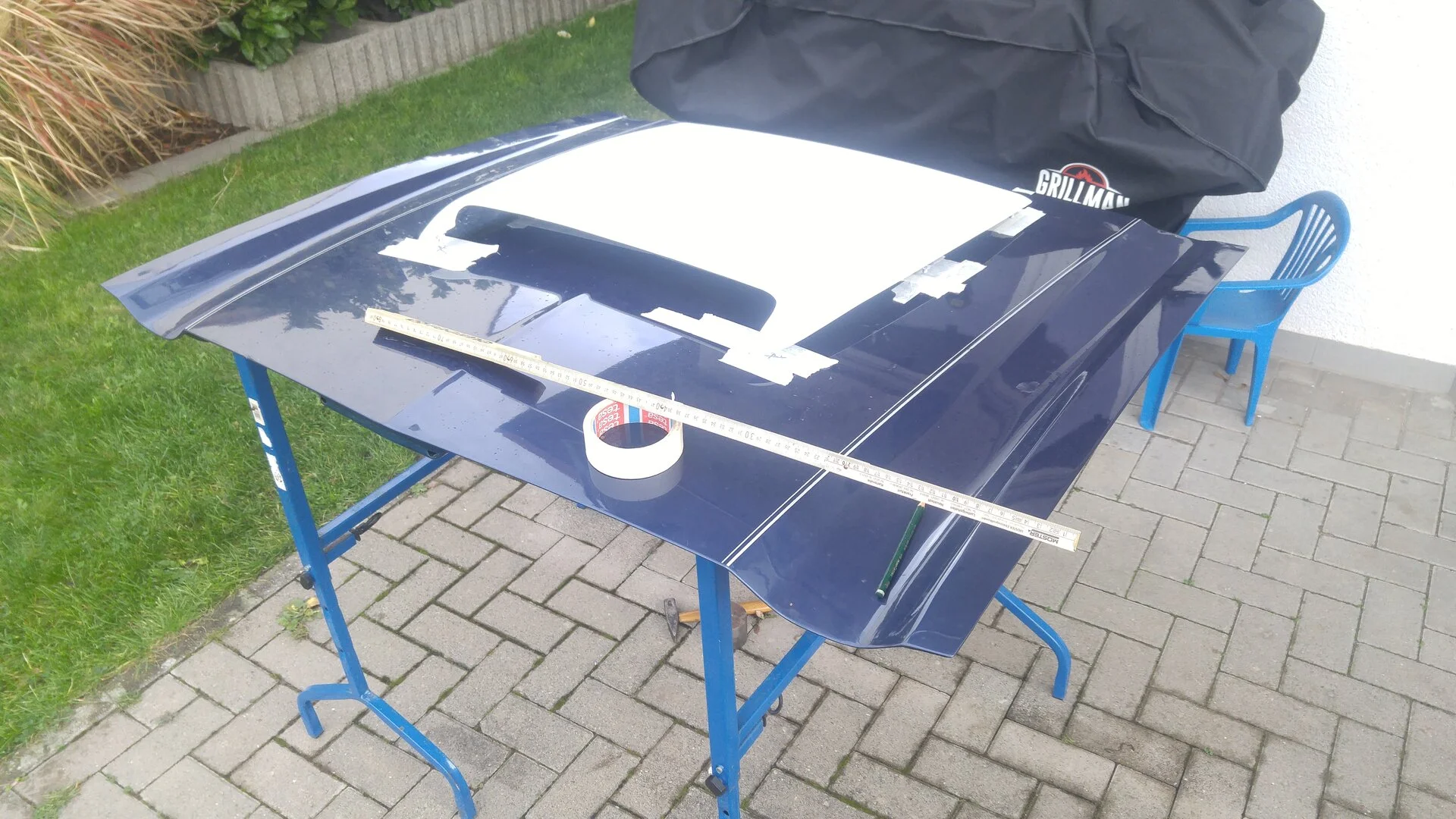

Not so shy! We are cutting up hoods, if we want to :)
Big intake, big air filter... Why should one think first what parts fit under the hood, when you can cut holes...
In my build thread on the first pages @LILCBRA posted and measured his solution for more air filter space.

As long as you can cover it with a good looking hood scoop, I don't think there's any harm in it. I mean it's functional in this case (for both fresh air AND clearance) unlike how they're cosmetic in stock form. Besides, a hood scoop adds some character to the car. :nice:
Oh, and about the rear louvers; I didn't think there was a real visibility issue with them. Maybe the quarter window louvers, but I don't have a problem with mine. I'd like to get the rear window louvers too, just never pulled the trigger on the purchase. :shrug:
Almost have to cut the hood if your running a v8 with aftermarket intake unless you use the stock air cleaner or an air hat. I have the cheapo foam eddelbrock air cleaner and it rubs my stock hood scoop, even after cutting the hood. I really need a taller scoop. I have an Eddelbrock air gap intake and run a 1/2" phenolitic spacer. I am using rebuilt stock engine mounts without spacers. I tried 1/2" spacers on mounts to solve a vibration issue and the air cleaner was smashed against the scoop and left a hump in it.
I did this with my 79 (and added a 87 up GT hatch spoiler). I did not know where the stock location was, so I measured, centered it over the carb. It looked right so I made it useful. Cutting a good hood was painful, so measure and cut carefully.

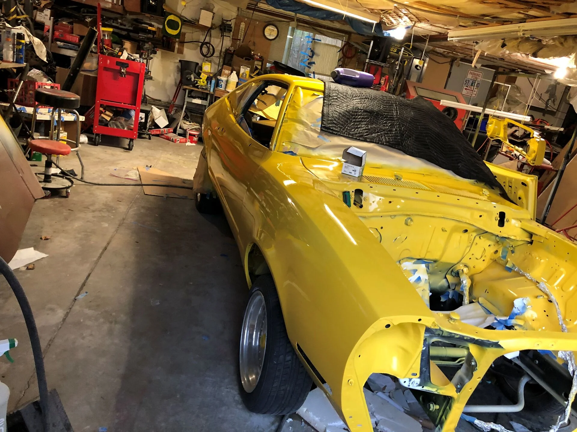

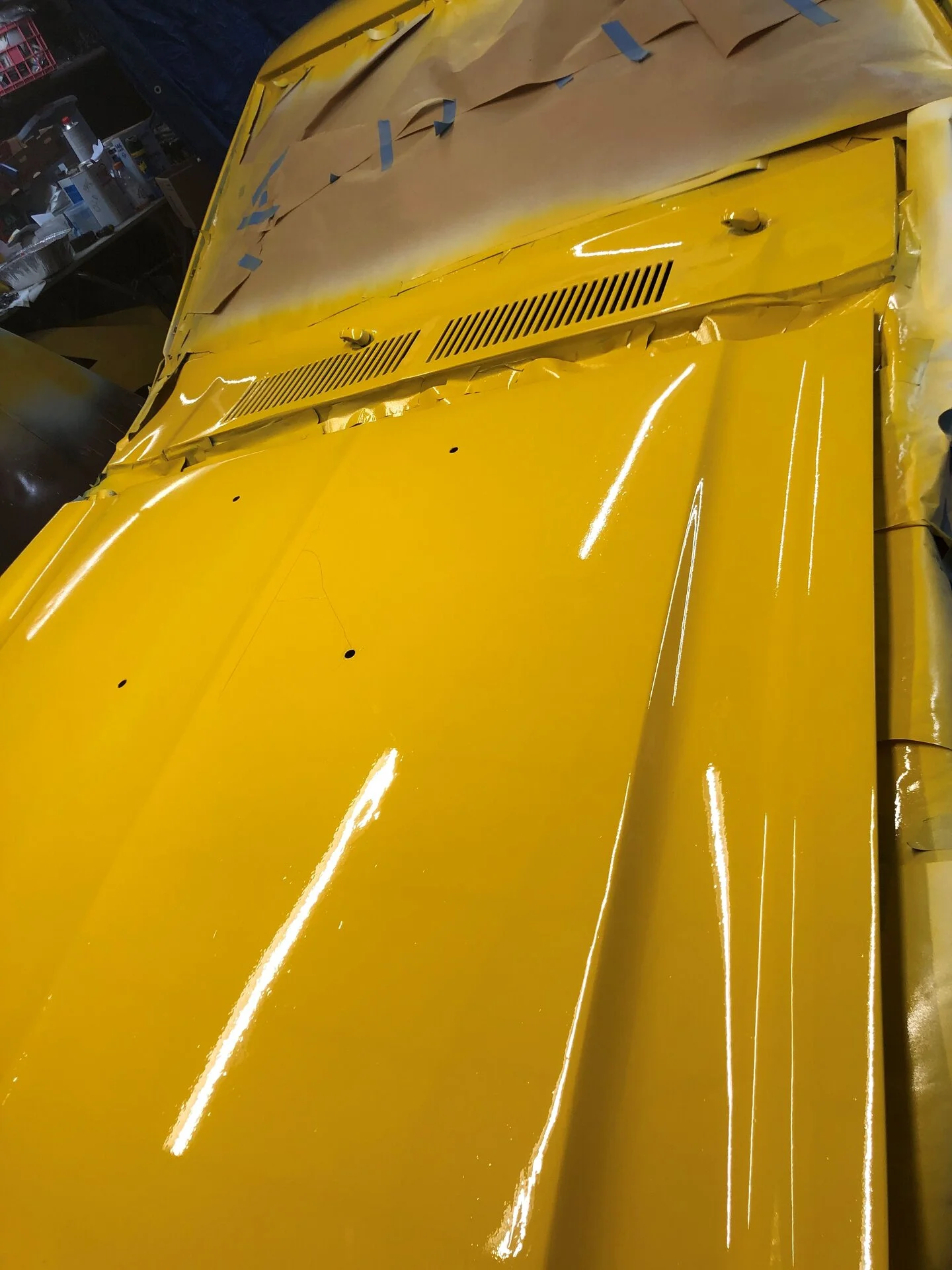

Had to stop on the Mustang until all this cleared up. Just about done sanding the body. Will finish tomorrow unless some big rust area on the top show up. But I did look before and all was well. Just need to fill some places the paint (clear) was peeling off. Weather will be warm Friday for painting. Then let body sit for a week then buff the paint out. Then the interior and engine. Still waiting for my Edelbrock heads.......Still looking for the plastic thingie for the door lock/handles. Send email to Phil.
