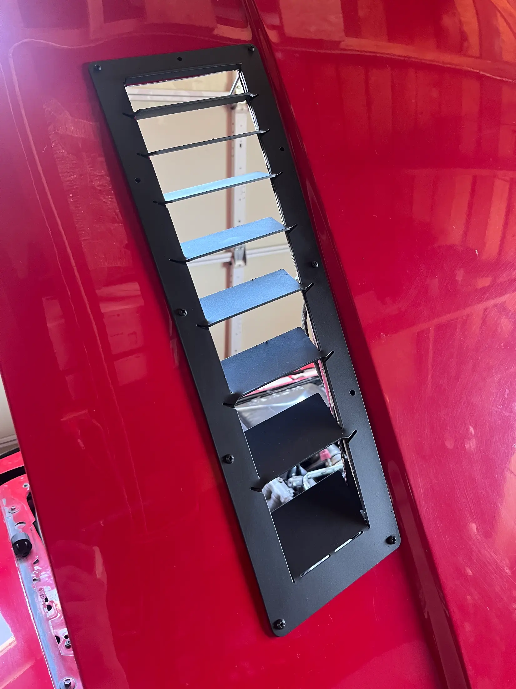

Little better photo of the louvers. I ended up using some gasket from work for the louver surrounds so they don’t scratch the paint.
Guess I could bolt them down for now until the hood gets painted.

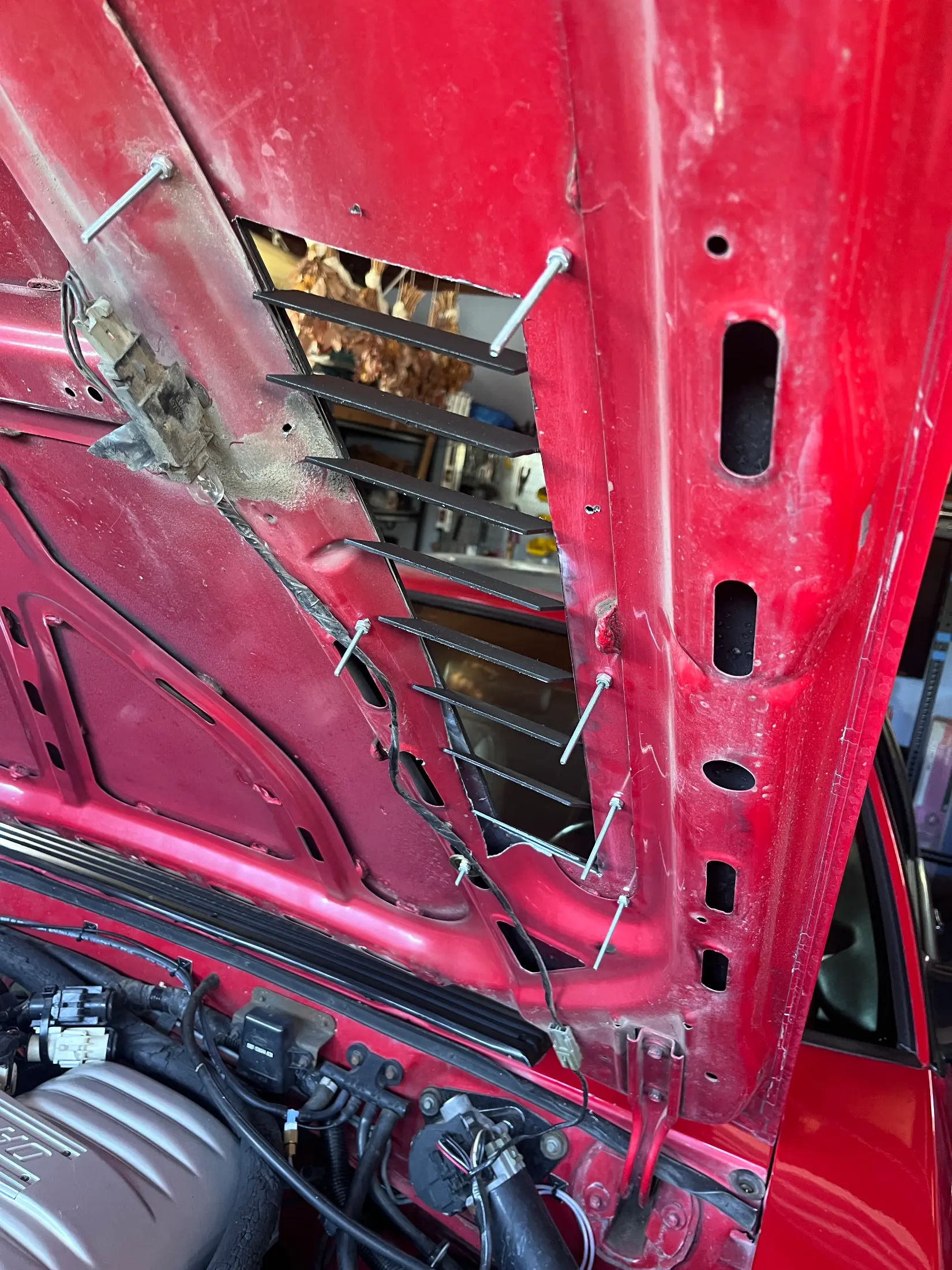

If anyone was curious how I am attaching the louvers here’s the plan:
Hardware store didn’t have enough so some are missing. But I will cut off the excess of the bolts where applicable. Nylock nuts should help with vibration.

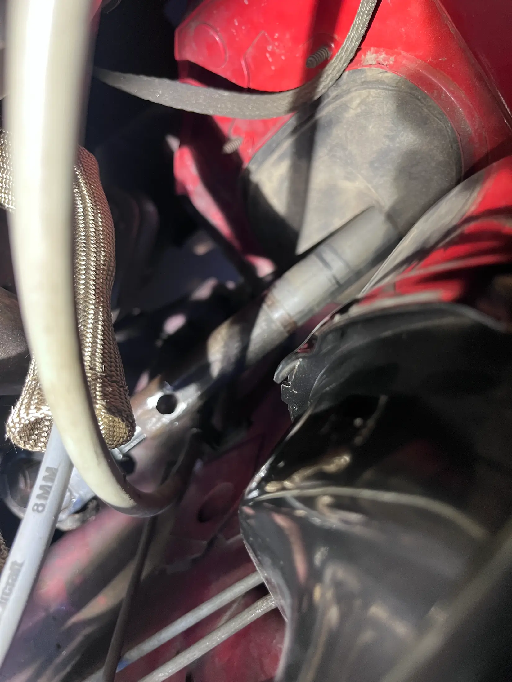

Any tips/tricks to separate the upper shaft from the shaft that goes through the firewall? I’ve been trying to separate the two and it seems to just be pulling the shaft out of the firewall? It’s still connected thankfully when I turn the shaft the steering wheel still turns but I really don’t want it to get disconnected.
All that cleaner gray looking area used to be up inside the car…?
I guess what I’m asking is whether I use a pry bar or slide hammer or anything else, how do I prevent the shaft coming out of the firewall to not keep coming out? I really don’t want to have to mess with the interior side of the column.
I will tap tap tap the connection point and keep trying to separate the two pieces while trying to keep that firewall shaft from coming out any further.
Knock it back in and clamp a set of vise grips on the steering shaft on the inside of the car as close to the firewall as you can. I did this on both cars and then just tapped the old rag joint shaft out of it. Disassembling the rag joint seemed to help from what I remember. Just made a more room and gave me something to do while I cussed the whole car.
You also need to restrain the steering wheel from turning as it will fubar the clockspring if you do not and it turns to many times.

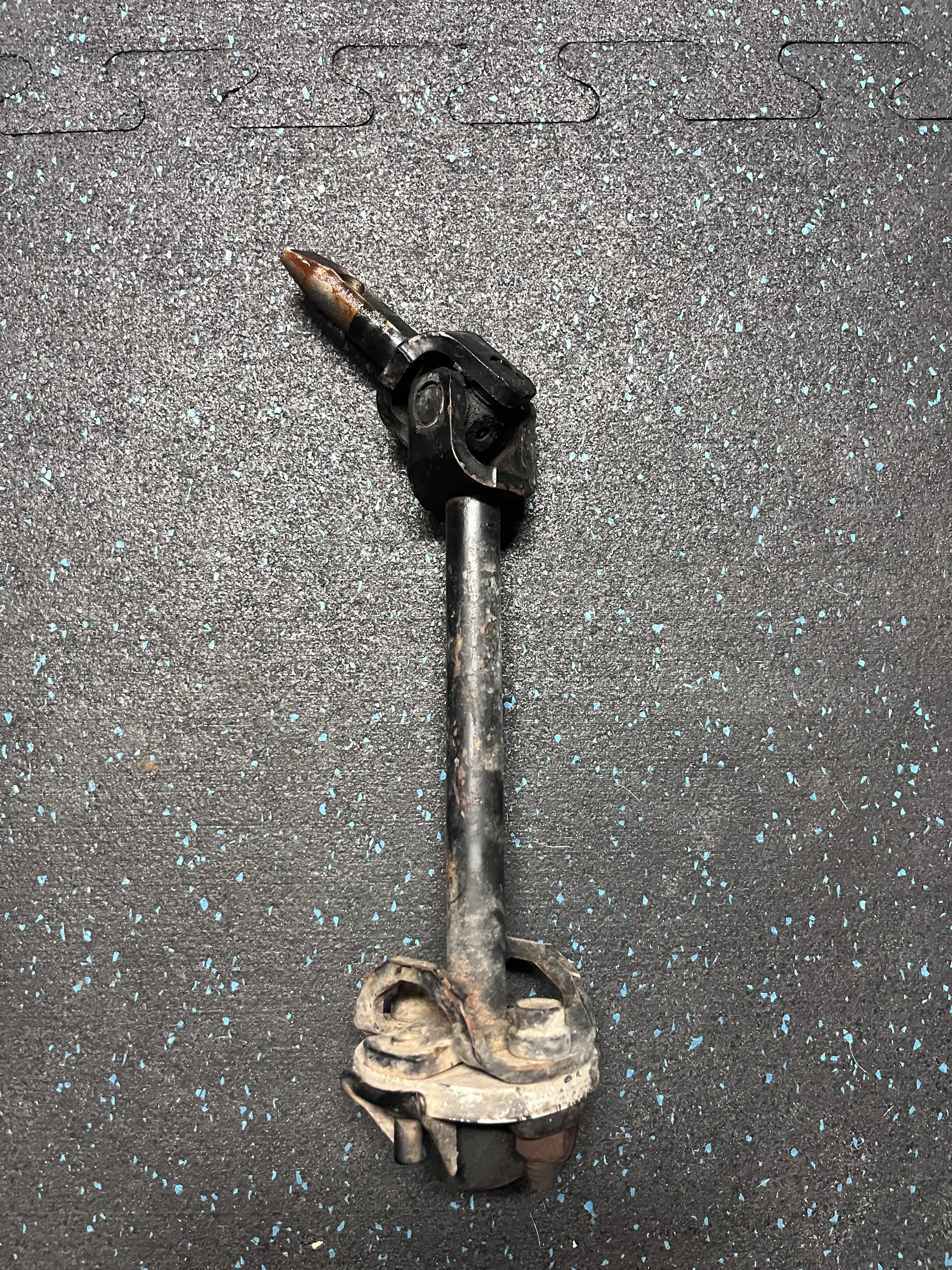

Ok got that F’r out!
@AeroCoupe your suggestions worked flawlessly. When I hammered both the intermediate shaft (which is still connected to the column) rearward to push the column back in, I think that really broke loose the intermediate shaft connection. I actually pushed the intermediate shaft too far up where the set screw hole almost disappeared inward (another problem that I had to overcome). Then I used vice grips on the inside of the car to hold the column, then pry bar’d the intermediate shaft off. Took a few tries of what I just described but that’s how it worked.

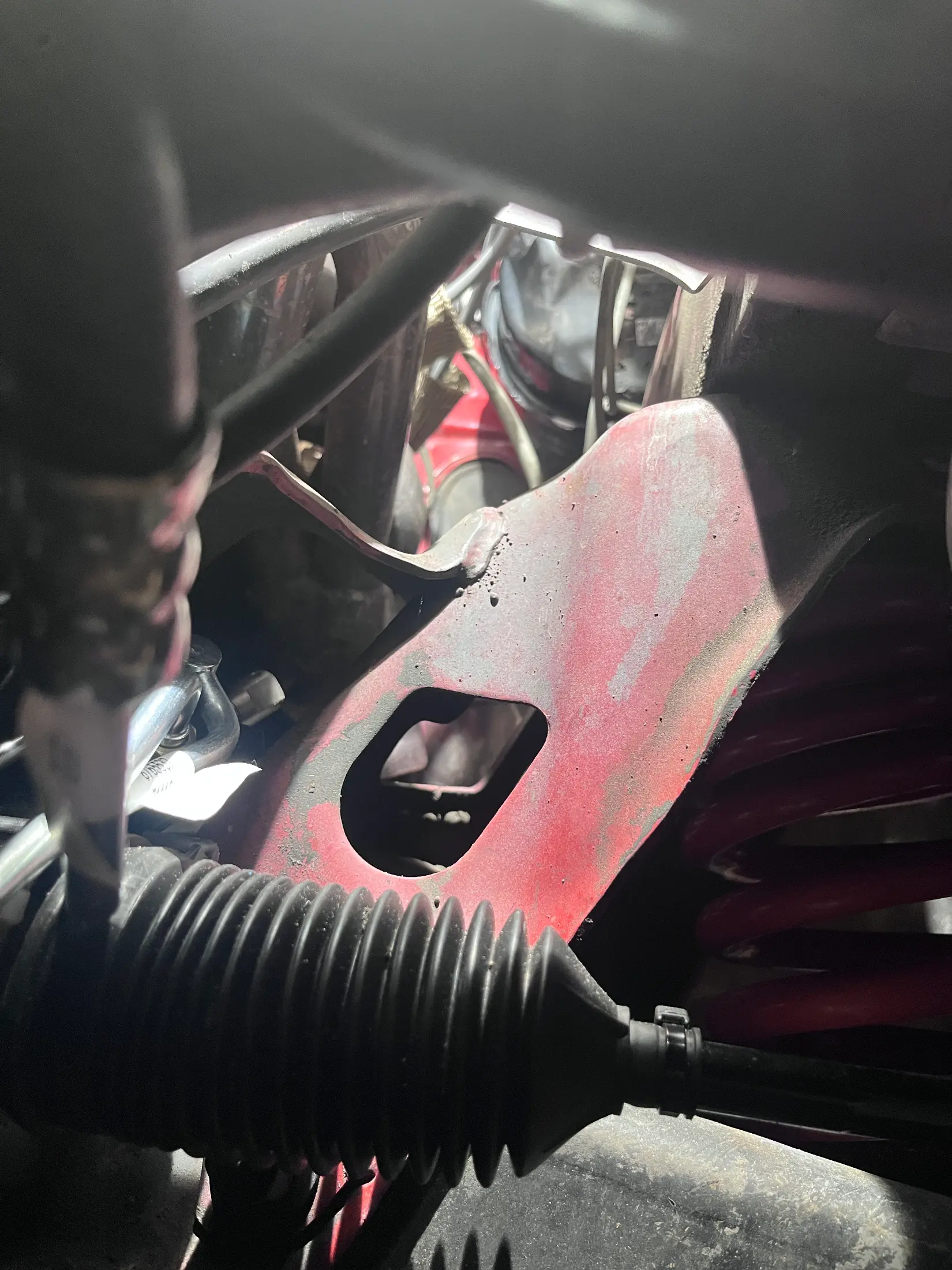

For anyone wondering a good place to hammer your column shaft back up into the cabin, this angle worked really well with like a 2 foot crow bar:
I’m laying on my back with my head under the battery area looking rearward towards the column shaft. Just snaked the crow bar through there then hammered away.
