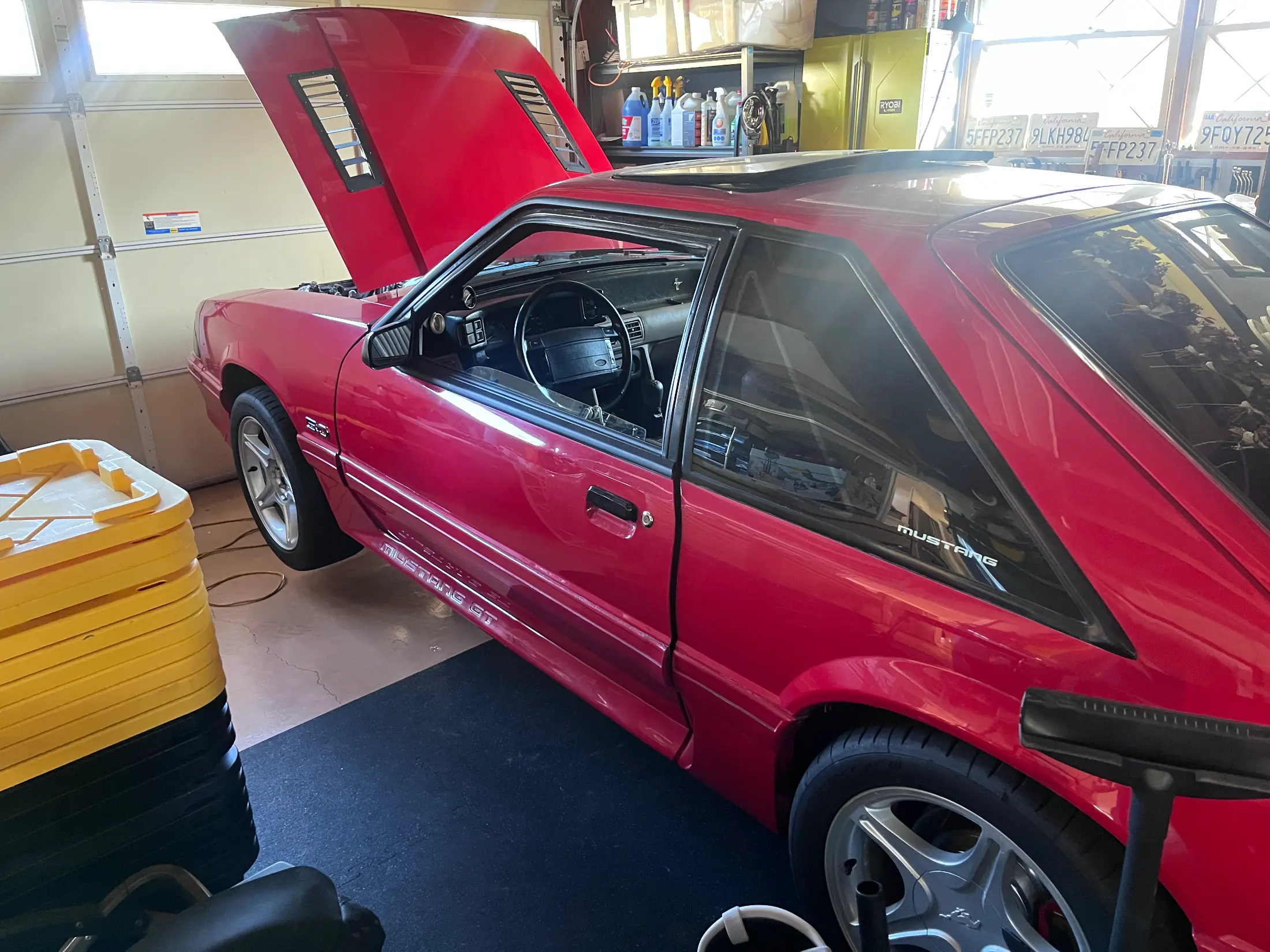

And since everyone likes pictures, here’s how she been sitting for a while now:
Are there any other options to get me driving in the meantime? I threw away my stock intermediate shaft and I no longer have my stock rack (not that I would swap everything back anyways). Does borgenson make some sort of shaft I could use? I will literally pay twice for a shaft if need be. I need the car drivable like at the beginning of December to clear space in the garage to start packing the house. My driveway isn’t the kind I can just roll the car out straight and park it. It curves to the right and is pretty steep.
