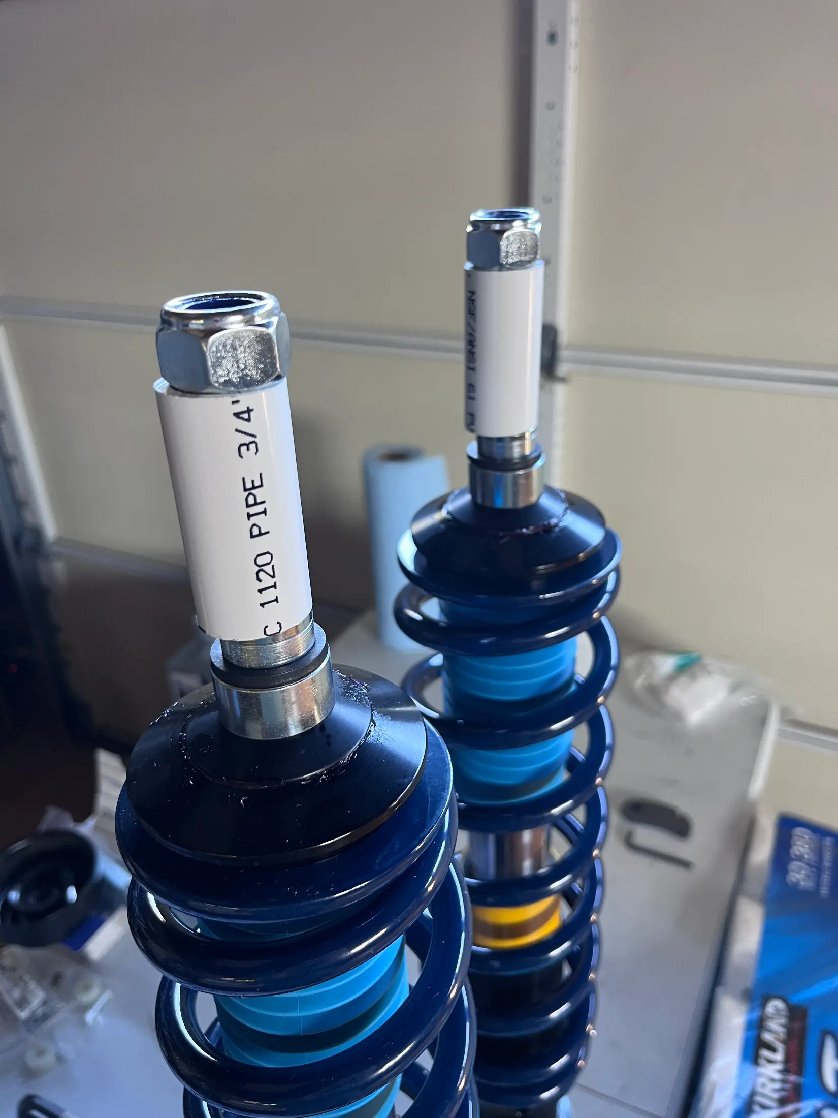

Well if I’m being honest with myself I won’t be able to install these before the move coming early January. So I didn’t want parts just flinging around and getting lost so I cut some PVC pipe to use as ‘spacers’ so I can keep everything on nice and snug:

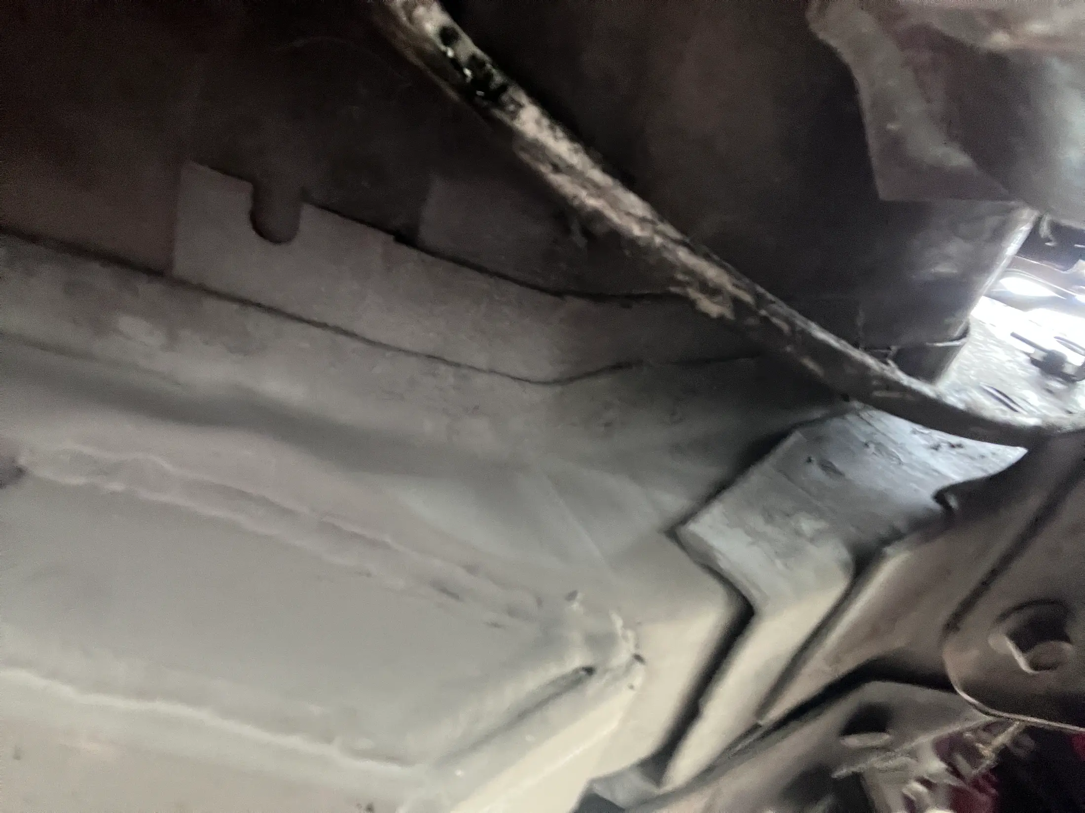

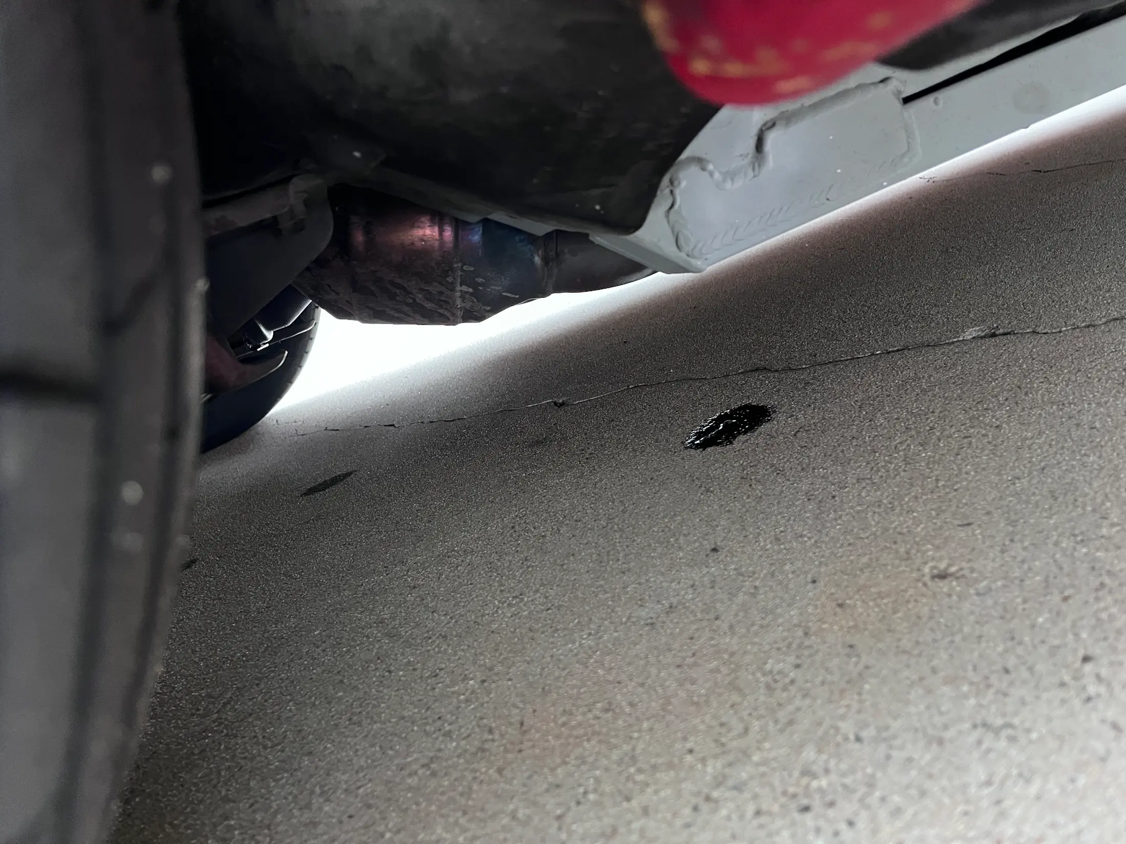

Went out later to get the mail and just for giggles I looked under the car for leaks, because I do believe my oil pan gasket is leaking so I wanted to see if anything was dripping. Lo and behold a new (as in unexpected) pretty good sized oil patch was under the drivers side catalytic converter. I tried sticking my head as far as I could to see where it was coming from but the car is too low. No oil on the cat itself but like coming from between the cat and the frame rail. So now I have to jack the car up and see what’s up.

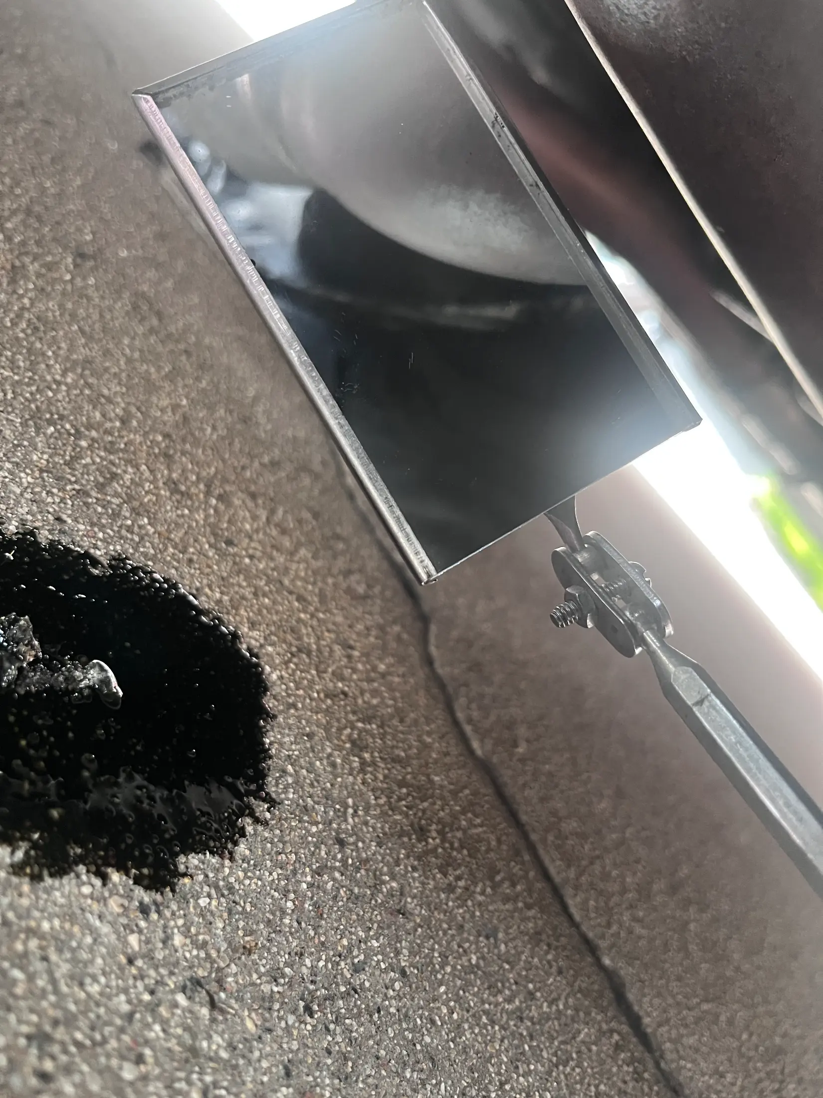

This is the new spot, not just a drop either. The other spot up to left more under the engine is what I was expecting.
Luckily it hasn’t grown since yesterday. I’ve noticed the car leaks oil when the front is higher than the rear (as my driveway is at a pretty big slope, or when I’ve left the car on ramps/jackstands in the garage). I don’t *think* it’s the rear main seal, but can’t be sure. I’ve cleaned all up in between that area and don’t see new drippings as much as the pan gasket area. The oil pan gasket is all caked with oil/grime all around it. But this new oil leak puddle isn’t near the pan gasket or main seal.
So upon further inspection I don’t think it’s an oil leak. I think part of a cable jacket literally melted and fell to the ground and like started to dissolve and make a wet spot. You can see the blob in the middle of the wet spot and it has a waxy feel to it when I scraped at it.

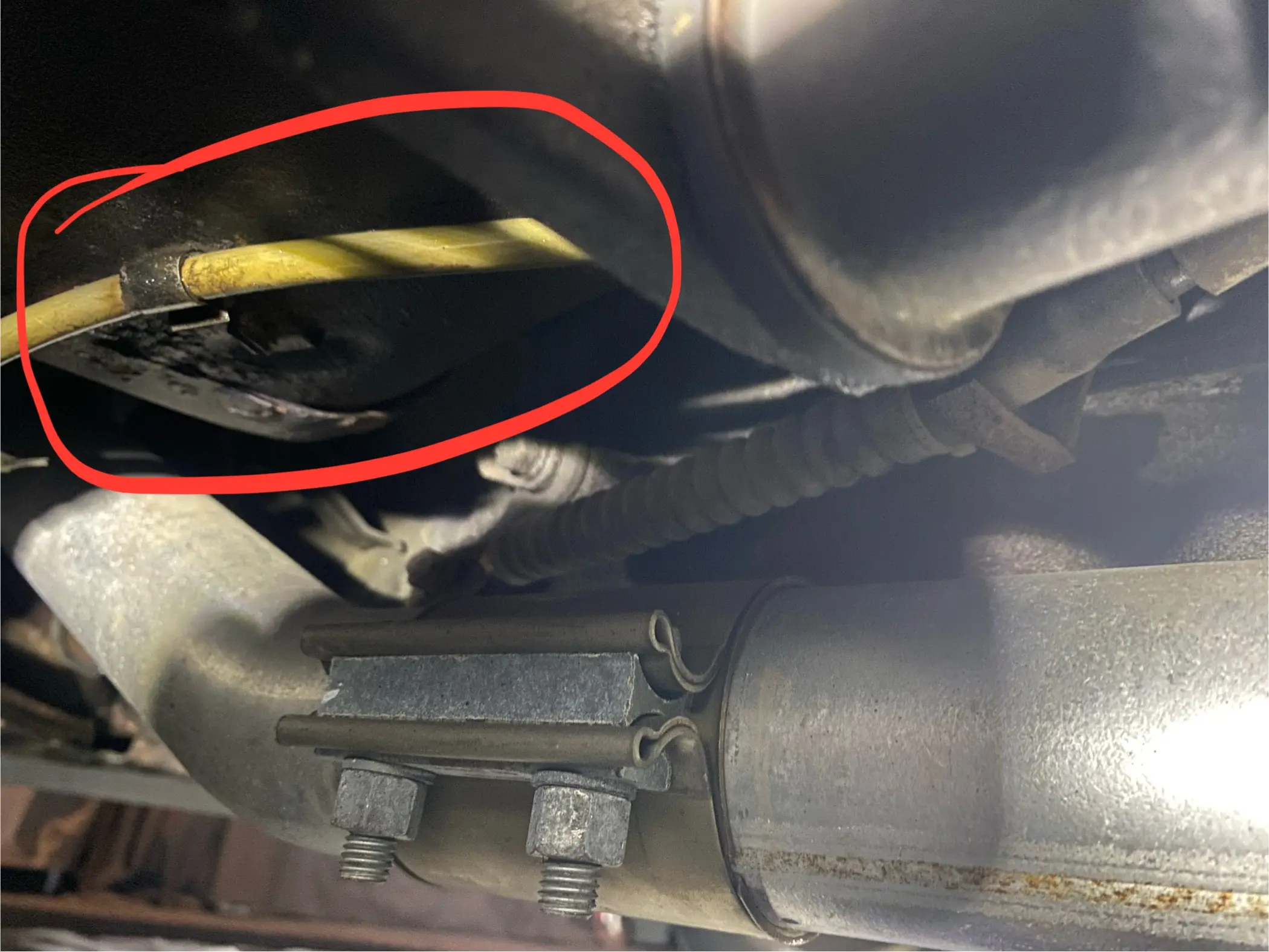

Ebrake cable maybe? It runs down the frame rail area. Still need to get the car up in the air a little bit to really see what’s going on but time is limited.
Speedo cable ?
Runs from the rear of the transmission along the frame rail and can touch the exhaust and melt if not secured to the clip. An oily Gooey substance drop on the floor is the result.
Interesting, the cable is secured to a clip right by the rail. It has distance from the exhaust but apparently not enough.
