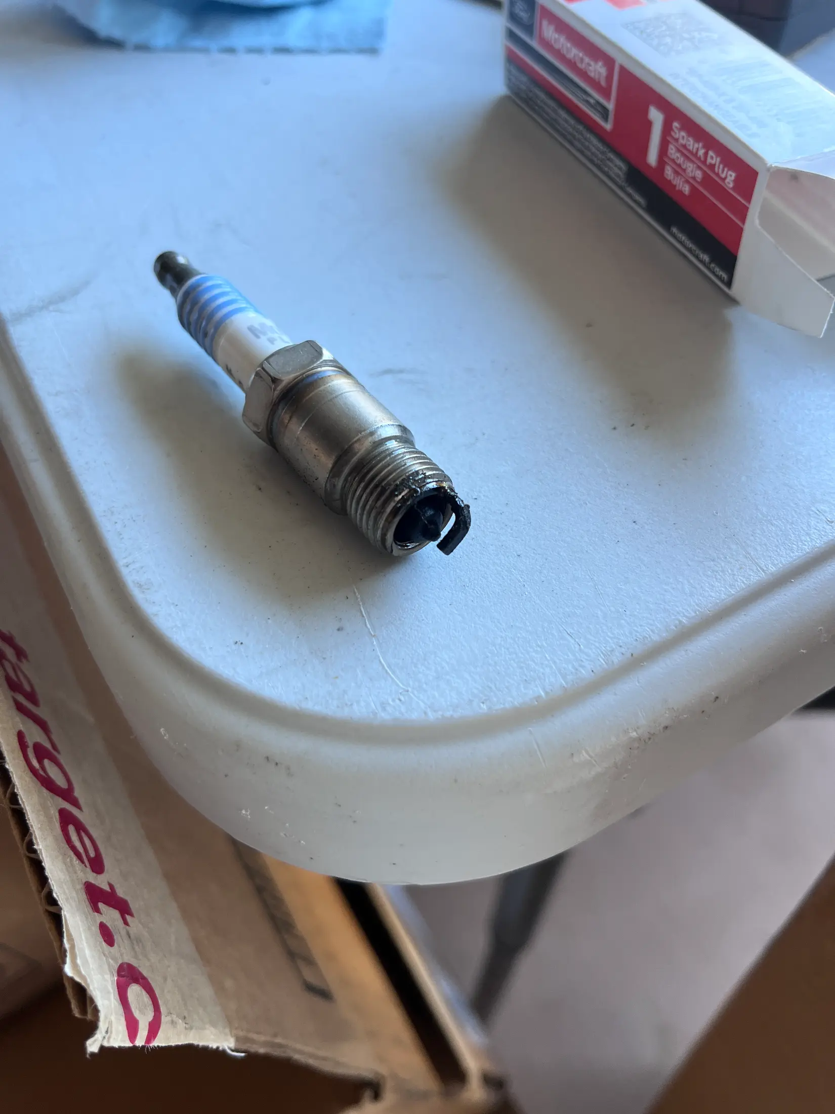

Ok back to my bunk CBT. I replaced the #7 spark plug which looked like this:
Reran the CBT and got code 90. All good. Engine barely vibrated/shook this time.
I didn’t remember, but the plug I took out was Motorcraft P/N ASF-42P (platinum) and the plug I put in is ASF-42C (copper). Is it ok to have a mismatched plug for a little while?
