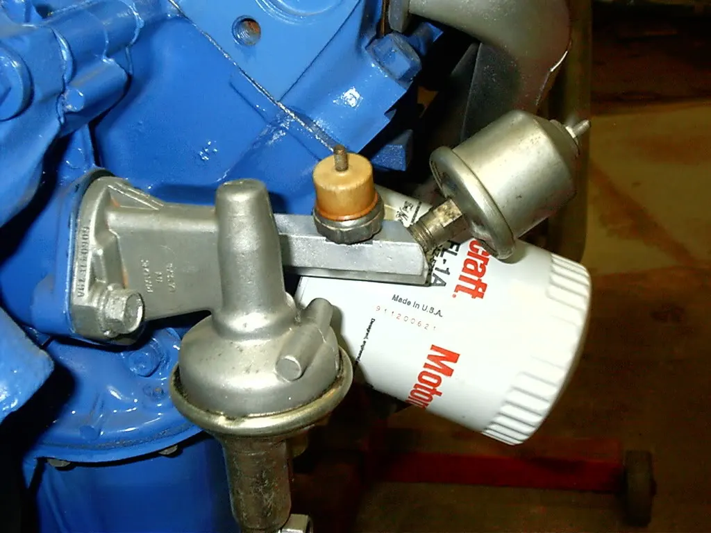

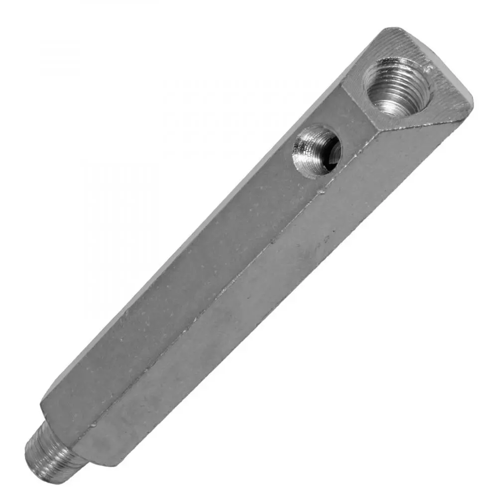

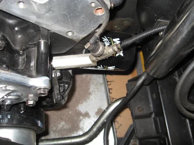

Some remote mount the sending units using a flexible hose from the block to a Tee fitting, others have tapped the extension, and others have used a Tee on the end of the factory extension.
Couldn't find a picture of a remote mount but you can google fu that if want.
So either buy one of these or drill and tap the factory one you have:
Ends up looking something like this:
Using a Tee on the end of the factory extension:
Awesome thank you, the second picture I think looks like the best route to go.

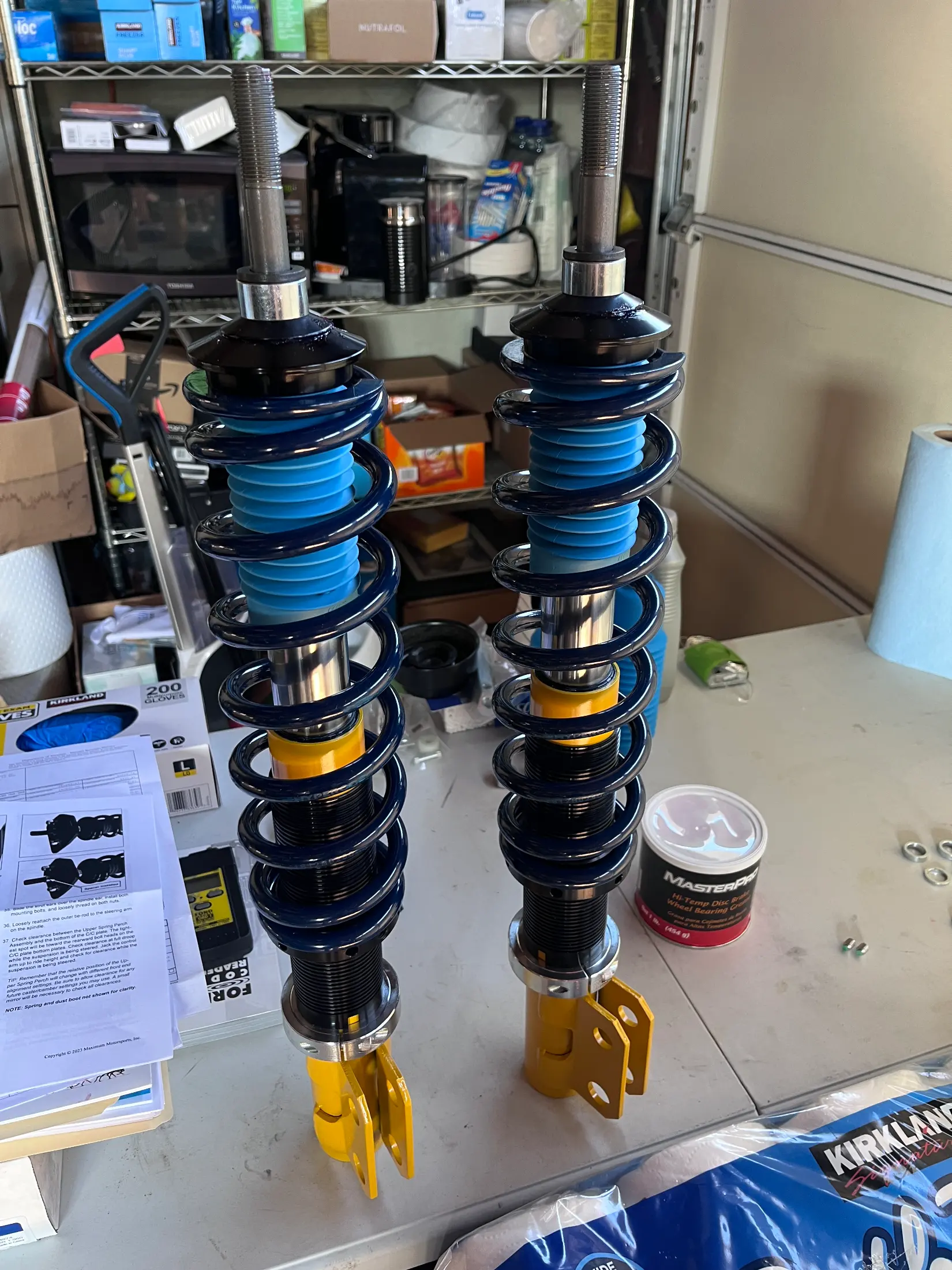

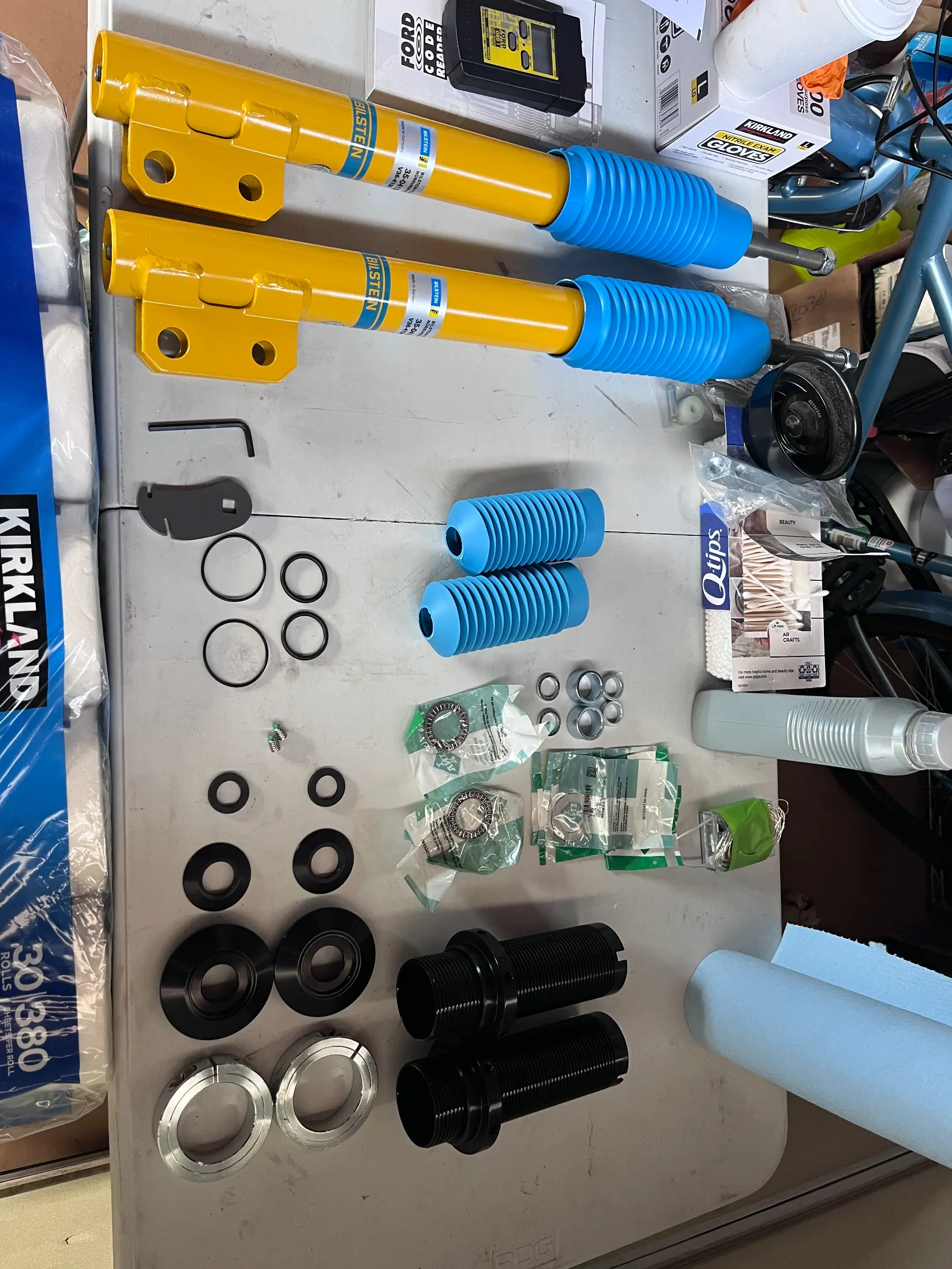

Was wanting to start assembling the coilovers. Got everything laid out, removed the stickers within two inches of the ears, and got to the point of needing to file down the top strut ring for the top hat to fit over before being summoned by the 4 year old:
So basically did not get too far.
