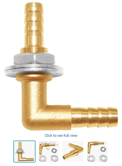

I think you're saying you're going to do it like my picture. If that's the case all you need is a 90° hose barb. I believe it was a 3/8 NPT x 3/8 barb. The threads are NPT (national pipe thread) so they are tapered and seal pretty much all by themselves. Just put some permatex thread sealant on the fitting before you screw it in.Was going back through my thread trying to find the Paxton vent fuel filter P/N as i know it was discussed. Couldn't find it, however i came across this post which i think i will now finally follow through on, especially since we've all been talking about it again. So i purchased this hose barb:
And will plumb it just like the quoted picture, then cap the barb coming off the airbox assembly. This is a 3/8" x 3/8" 90 degree hose barb that has the nut to hold it in place. I assume i'll put some silicone or something on the washers to prevent any air getting in when i install it.
Yes i'm doing it exactly like your picture. My inlet elbow has the provision to drill out just like you are mentioning, just need to replicate your photo. I also have a J&L Oil Separator on order that i will put in this line coming from the oil fill neck on the passenger side valve cover.I think you're saying you're going to do it like my picture. If that's the case all you need is a 90° hose barb. I believe it was a 3/8 NPT x 3/8 barb. The threads are NPT (national pipe thread) so they are tapered and seal pretty much all by themselves. Just put some permatex thread sealant on the fitting before you screw it in.

This is assuming your plastic elbow is like mine was. It has a threaded bung already on it but the bottom is not drilled out. All I had to do was drill it out and screw in the fitting.
I'd put a little oil seperator in line rather than the filter, but the filter is fine if you check it regularly. Seperator is better becasue you just drain and reuse.
