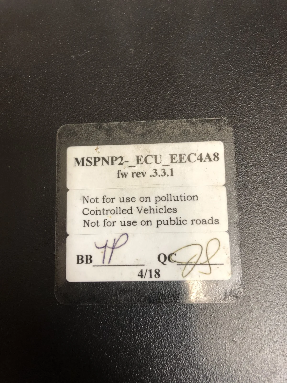

Poking around with this offline. The ecu version isn’t listed in the drop down menu. Which should I select. Here’s what’s on the back of mine.

So I went to MegaSquirtPNP.com to get a base tune to download and see what it looks like and I get a error message about signature not matching. So I go back and look and that particular signature is not in the list.
Sorry if these seem like dumb questions

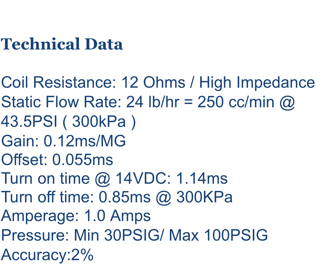

@a91what so I’m not sure what brand my injectors are. I’m assuming some off brand ‍:( I attached the data I have for them. Although the offset seems wrong at .055 seems like is should read .55
I also am not sure I have enough info. Thoughts?
