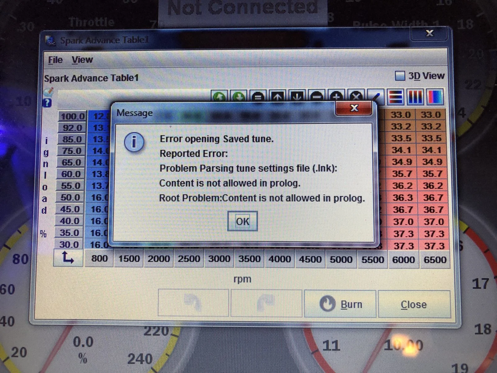

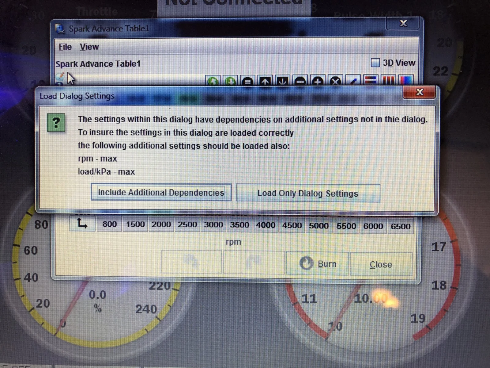

Hmmm ok here’s what I’m getting. I must be doing something wrong.

I have never seen the issue in the right picture but on the left just include the dependencies.

on the right is the message i get when i proceed and it doesn't upload
