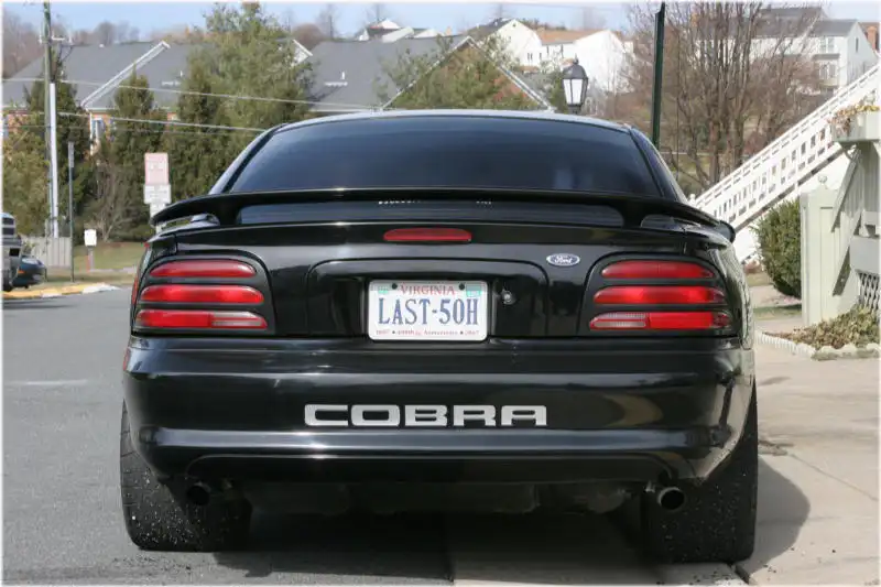

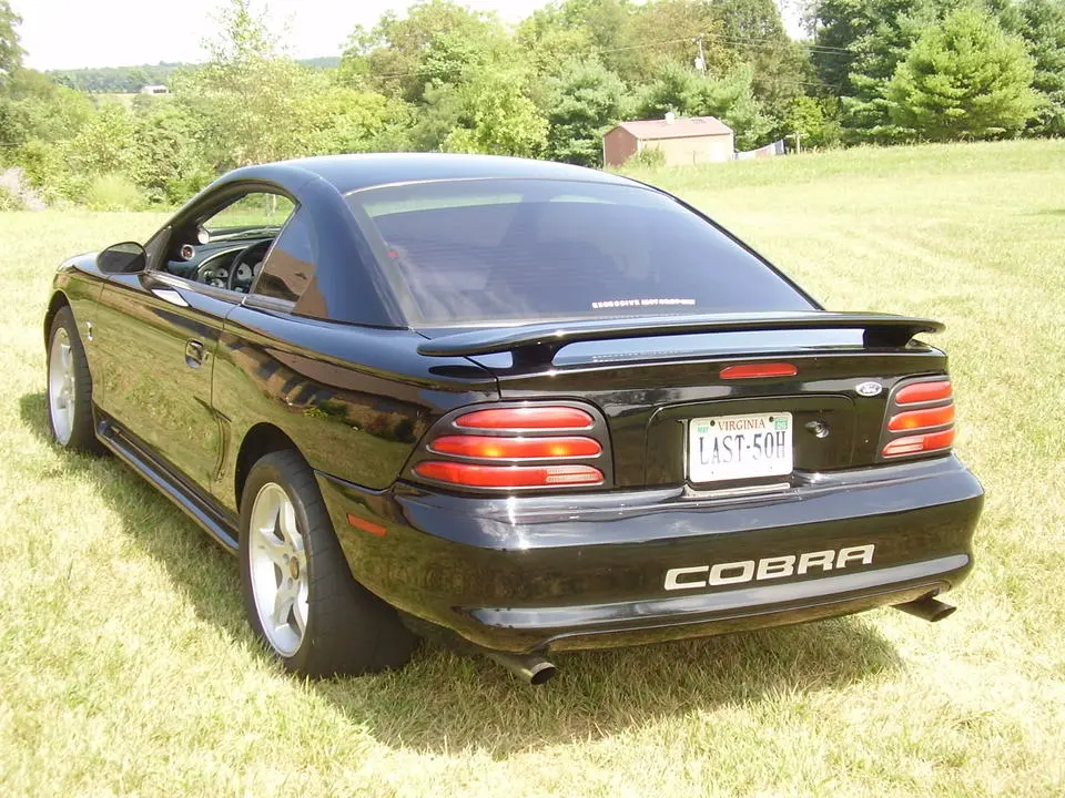

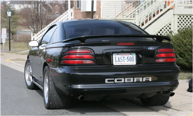

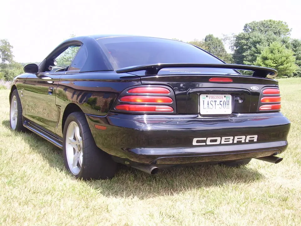

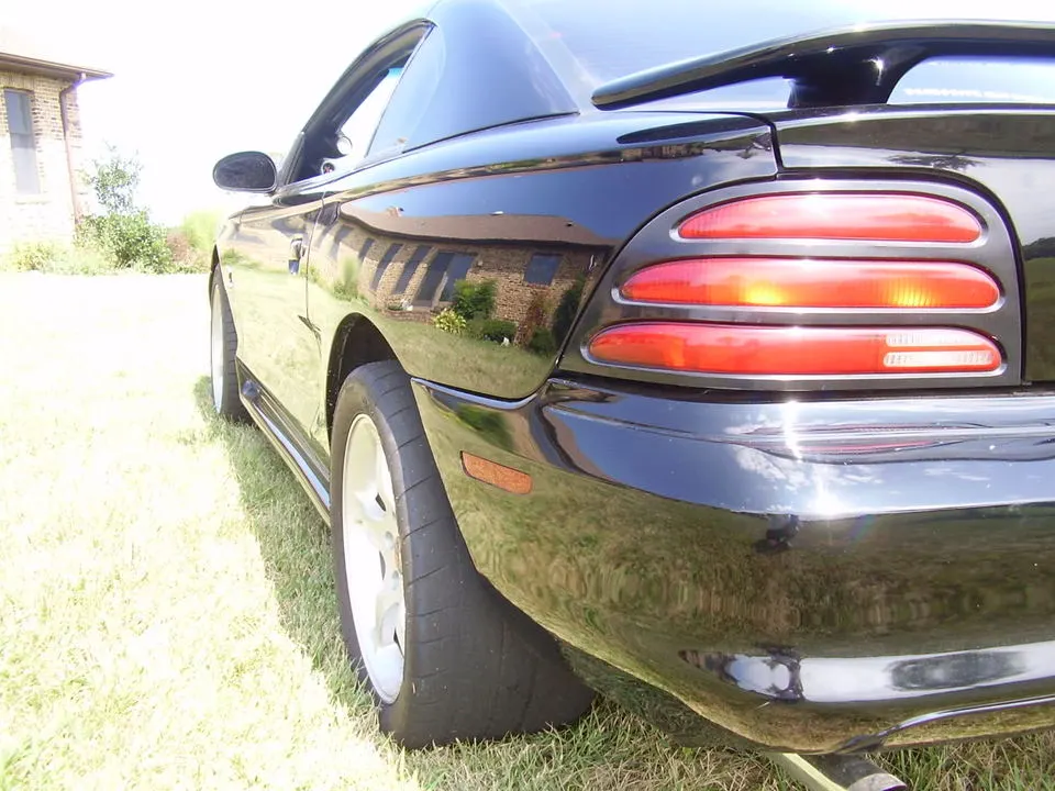

The BFG's hook well too. 315/35-17. Just dont expect alot of mileage. They are MUCH larger than the Nitto and barely fit a 10.5 rim without too much distortion.
The Mickey T's are the bomb, but I believe they are illegal in some DOT classes. I wouldn't expect more then 10K miles on them in street use.
You can run pretty much any 315/35/17 on 10.5 inch rims if you are using the stock suspension.
Adam
Got those too, look for pics on my cardomain site. My BFG DR II's are very wide for a 315, they bulge a bit on my 10.5" wheels. I had to pound a bit on the inner fenderwell where it meets the rear subframe (not hard) and I haven't had quads in years so no idea if they would have fit or not. Also had to bend my flowmaster tailpipe hangars just a bit to keep the pipes from rubbing.
However they hook! One burnout on the street and everything sticks to them, air them down to 14 or 15 PSI at the track and they used to almost bog my old nitrous 306...
Not to mention the steamroller look is baaad! I like 'em, I'll replace them with another set when these are gone!!
