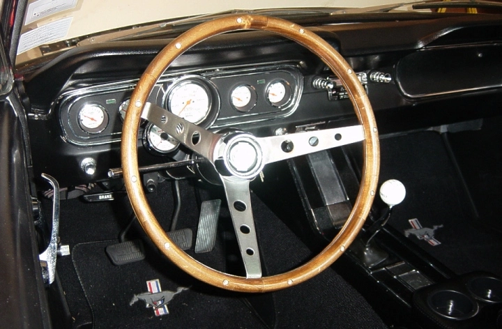

I use an Autogauge tach that has a built-in shift light and pointer. I can see both the speedo and the amp gauge just fine. Not a bad deal for around $100. It has an all black housing and so doesn't look out of place on the steering column.
I actually replaced my Rally Pac with it to have more accurate shifts at the track. I put the tach on the right side, so I can see it with my left hand at the top of the steering wheel and my right had on the 4 speed shifter:
