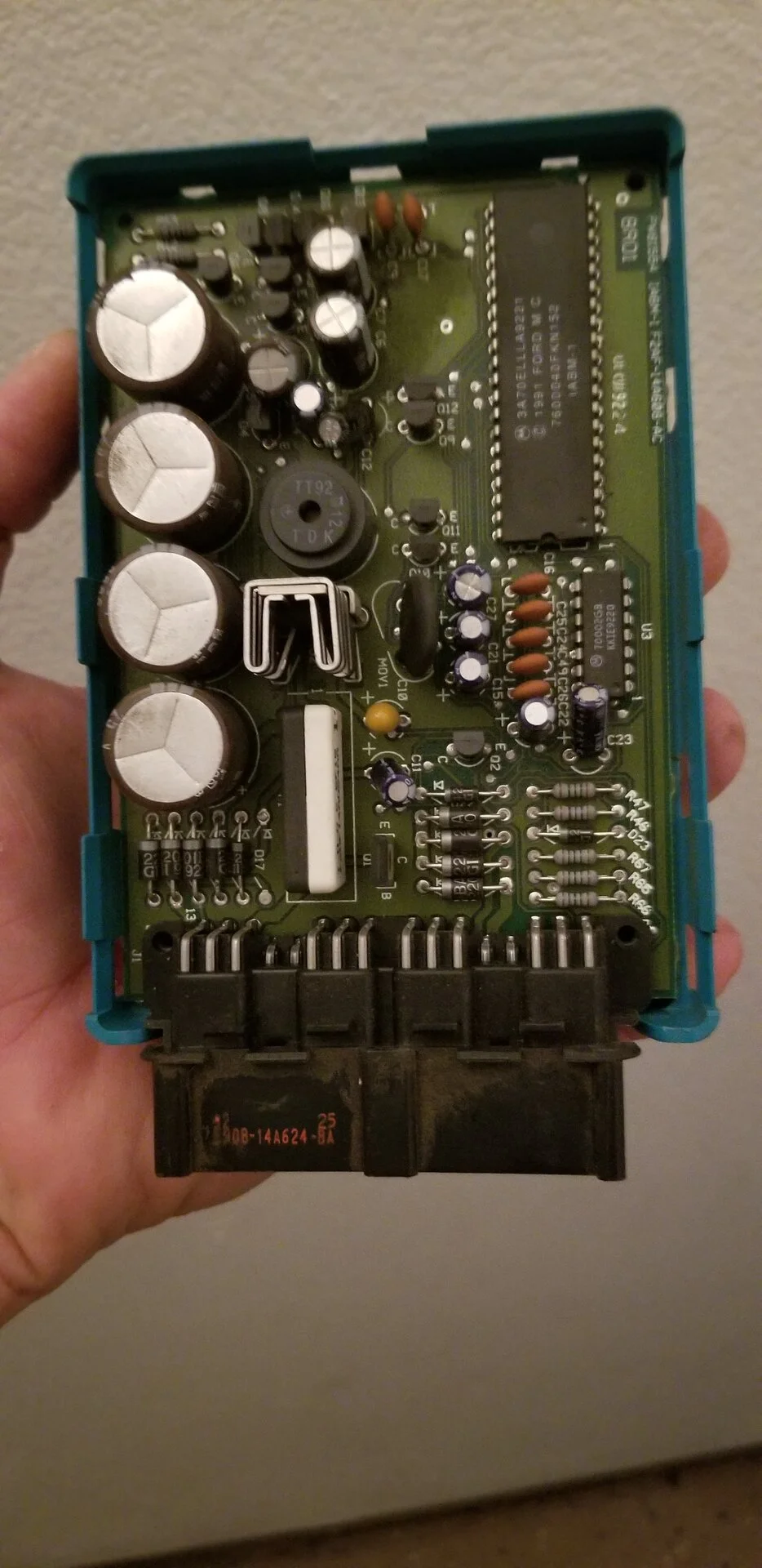

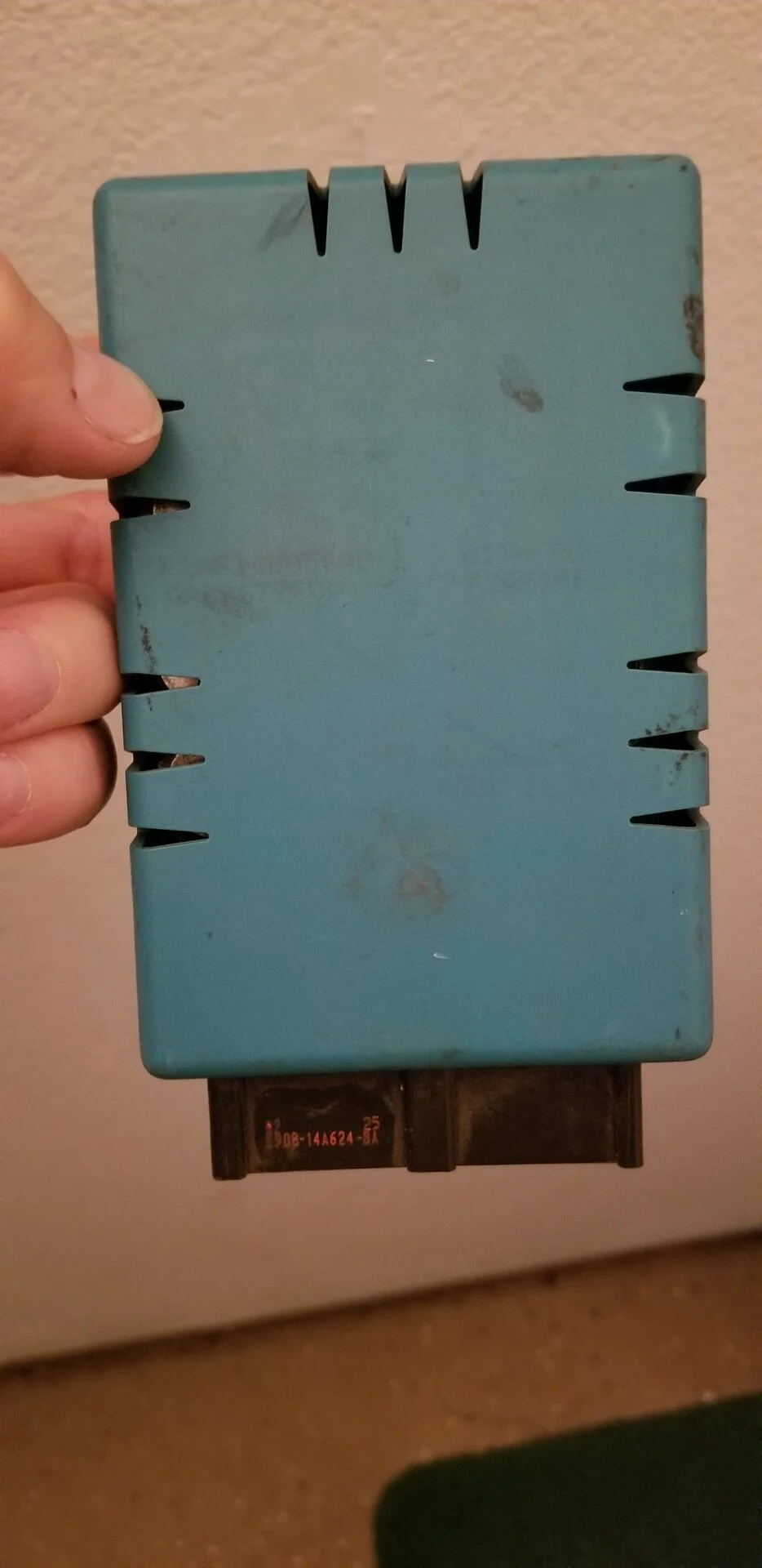

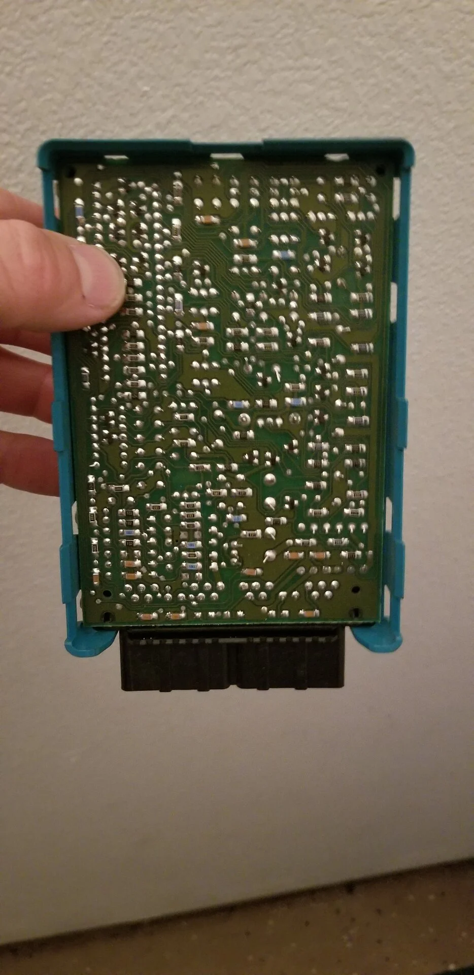

I pulled my '93 airbag computer from behind the radio a few months ago and would be happy to sell it to you.
