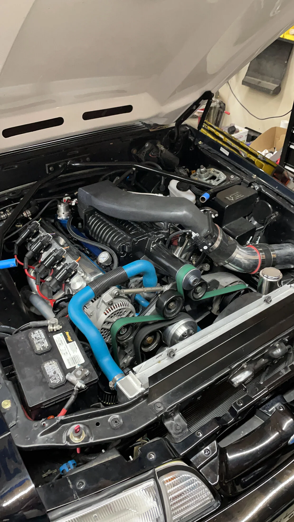

So on my car i currently have 3:73 I believe I need to confirm as the PO had them installed and i haven't verified but i do believe that is correct. I'm running a TKO600. I really feel like I would benefit from 3:31 or 3:55 as I really don't have much of a first gear and i can easily spin through 3rd I also think with taller gears i would give the supercharger some time in first and second to build boost. I'm pretty sure I'd still have traction issues but probably more controllable.
For those that don't know I have a 347 running at about 10psi
What are your experiences
3.31's get my vote. I have 3.73's and 1st is completely worthless with the 331 and second is just about as bad. At some point the gears will get swapped in mine.
Reactions: KZGUNS
What's your power & weight, and do you care about optimizing the 1/4 mile?
power, not sure 100% but its a well built 347 all forged with a FPP Boss block 10.3:1 with a supercharger. Not terribly concerned about 1/4 mile it really struggles to hook up drag radials. I feel it has enough power to still pull hard with 3:31 gears. its a pretty much option less lx i'd guess around 2800lbs ish

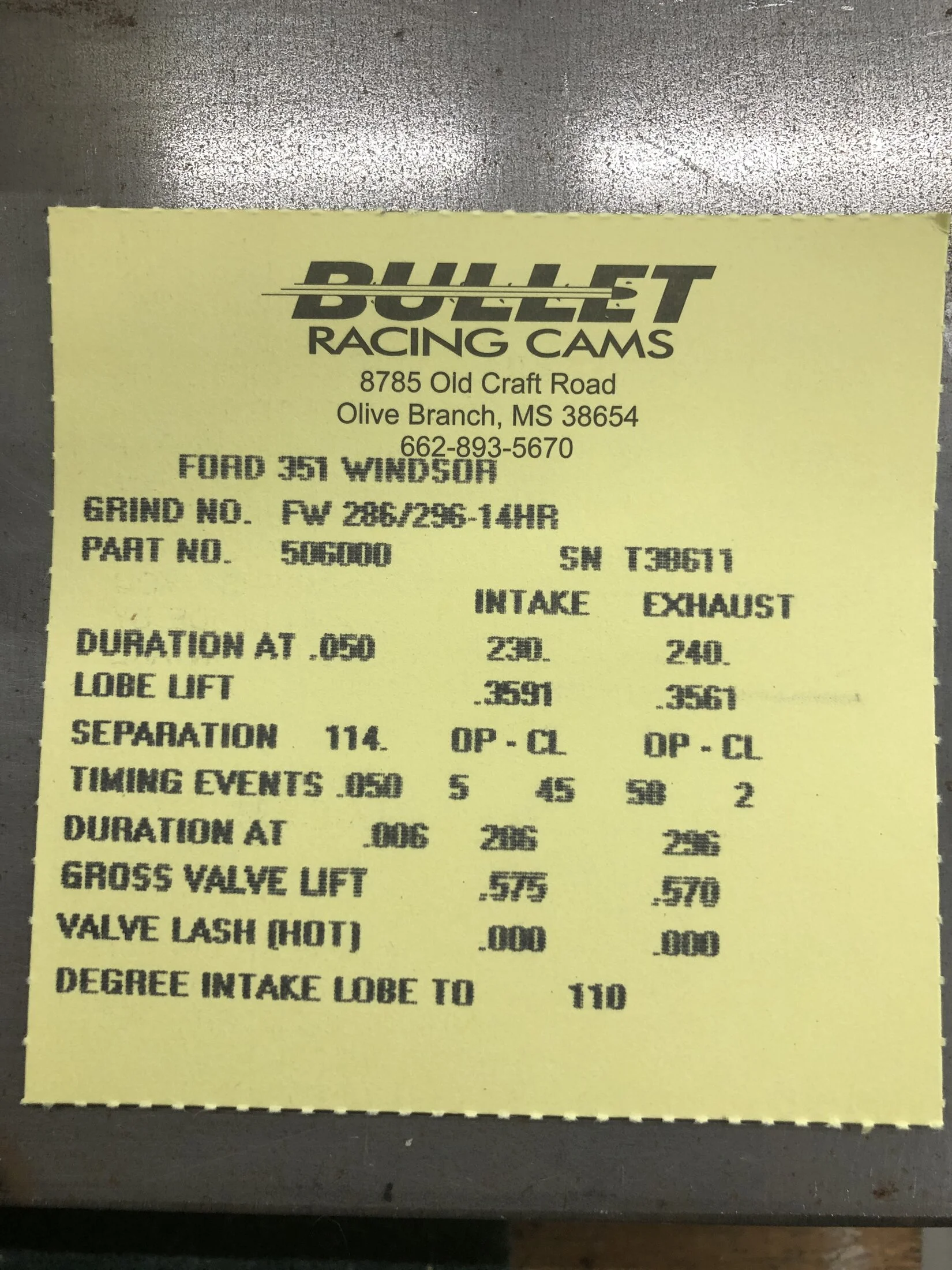

Which heads/intake/cam? Rev limit is 6k? Also, are they standard ~26" tires? I know I've seen your posts here, but memory sucks...
Promaxx heads. B&M intake but it’s custom adapted to an Eaton M112 yes ~26” rev limit is 6400 but it can take more. Cam card attached it’s a custom Brian Freezy spec
Reactions: TOOLOW91
Healthy cam. I'd guess you're seeing upwards of 500rwhp or slightly more when pushed to the limit and your practical RPM limit is going to be dependent on the efficiency of the blower, which will be putting heat into the intake air.
Anyways, at those power levels and ypur estimated weight, you'd trap in the mid-high 120s, or maybe right at 130. So, while I don't have my computer and the tools I built, a quick estimation says ~3.48 would be optimal to run through the traps at 130. You said that's not really the goal, but the point is, of course it'll still pull like hell with taller gears. Based on your stated goals of taming the early gears, I also support the drop to a 3.27 or 3.31. Just realize that if you were spinning 3rd, this won't do much for 1st and 2nd. Some other benefits would be lower RPM at cruise, and maybe 1 or 2 more mpg.
