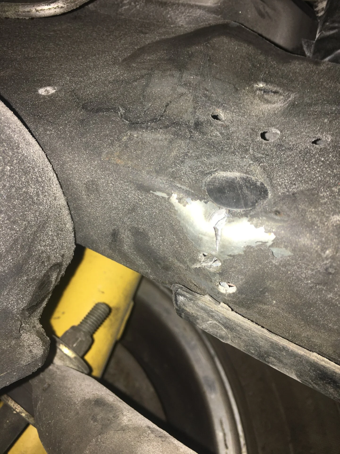

The car isn't ruined. Anything can be fixed. A minor buckle isn't the end of the world but you want the frame pulled back square. It may be square and an alignment issue could be the cause of the tracking and rubbing.
That crack should be able to be welded up and just about as good as new. Without seeing pics of the impacted structure it's hard to determine what repair action needs to be taken. Pictures also sometimes hide details.
Sorry for the late reply, but it seems you were spot on. I took it to the guy that did the work initially, and it turns out he just forgot to do the alignment. When doing the alignment, he couldn't get the wheelbase to line up correctly. His theory was that the K member was likely bent a little bit either from my accident or from an earlier one the car was in during it's time in California. In any case, I ordered a new Maximum Motorsports K member and coilover kit, just got it back a couple weeks ago, and the car drives great.
