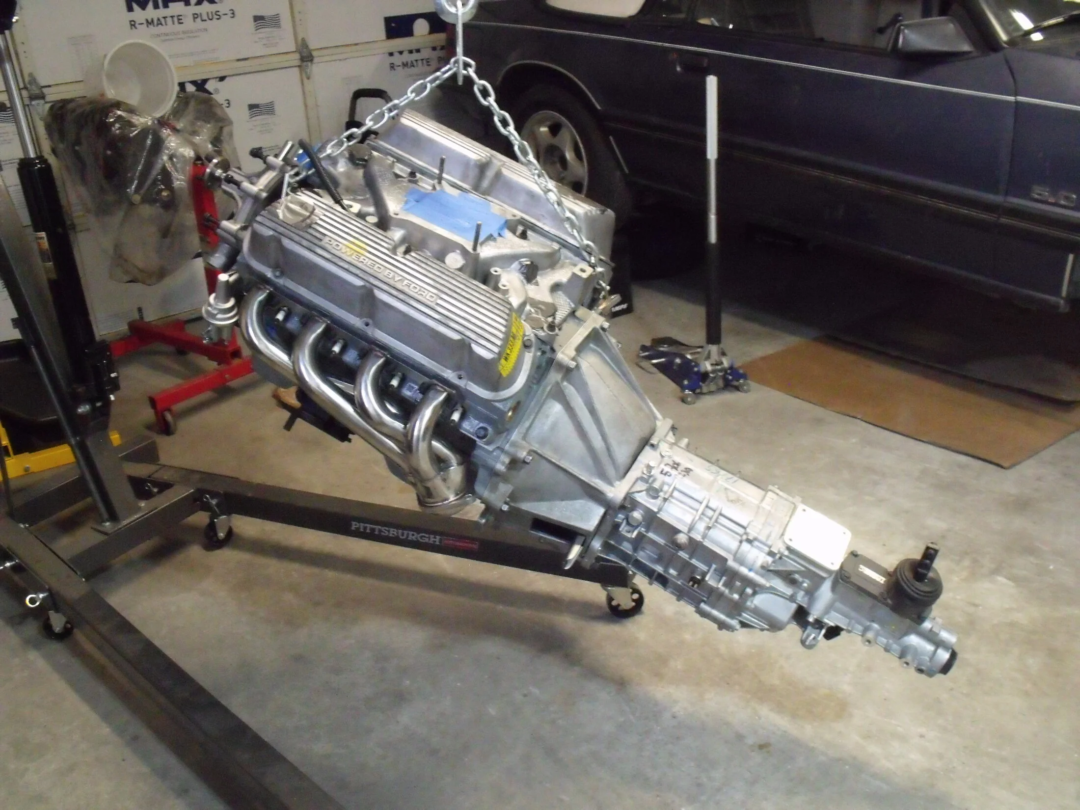

Alldegree said:
I've been thinking about my engine/transmission situation. I've said before that I wanted to make 350-400 lbft at the flywheel, but the more I think about how I actually drive the car, and also how much money would be required to get to that goal, the more I think I may be better off just having my current shortblock rebuilt, picking up a clean pair of GT40 heads, and calling it a day.
As much as I like to think otherwise, I primarily drive the car as a cruiser. Take it on errands, shows, etc. What I really want out of the car is to be able to drive it anywhere reliably while also having some fun with it.
I already have an explorer intake as well as some kind of mild cam (I don't know exactly what it is), along with a cold air intake and shorty headers. The car dyno'd a couple years ago at 235 rwhp and 290 lbft, so I think the main choke point is the heads, which are the stock E7s.
I figure with my current setup plus a set of GT40s and 24lb injectors I could make 260-280 rwhp? It would basically be a cobra engine with some extra oomph. That would give me a noticeable bump in power while also allowing me to use a T5 rather than having to upgrade to a TKX. I could always get the intake/heads ported to make a little more power in the future as well. I know I'd have to get a new MAF sensor for the new injectors.
Do you guys see any issues with this setup? I'm trying to be a little more realistic. I'd love to get a Blueprint 347 and a TKX, but I think I'm going to have to save that for the future when I'm a little more financially stable.
This is basically what I am doing with my 83 car.. Explorer engine, 030 over with a Stage 1 cam. Machinist looked over my " P" heads and did a basic valve grind and surfaced them... I installed new beehive springs with viton oil seals... I wanted a roller cam engine and one piece main seal which is one reason I did not rebuild the original engine....
My car is carbureted, as it was from the factory so I did get a new summit carb.
Went with a TKX as my car had a SROD in it.. SROD bell fits a TKX...
I hope to have a nice running street engine/car....
Reactions: slow84lx and Alldegree

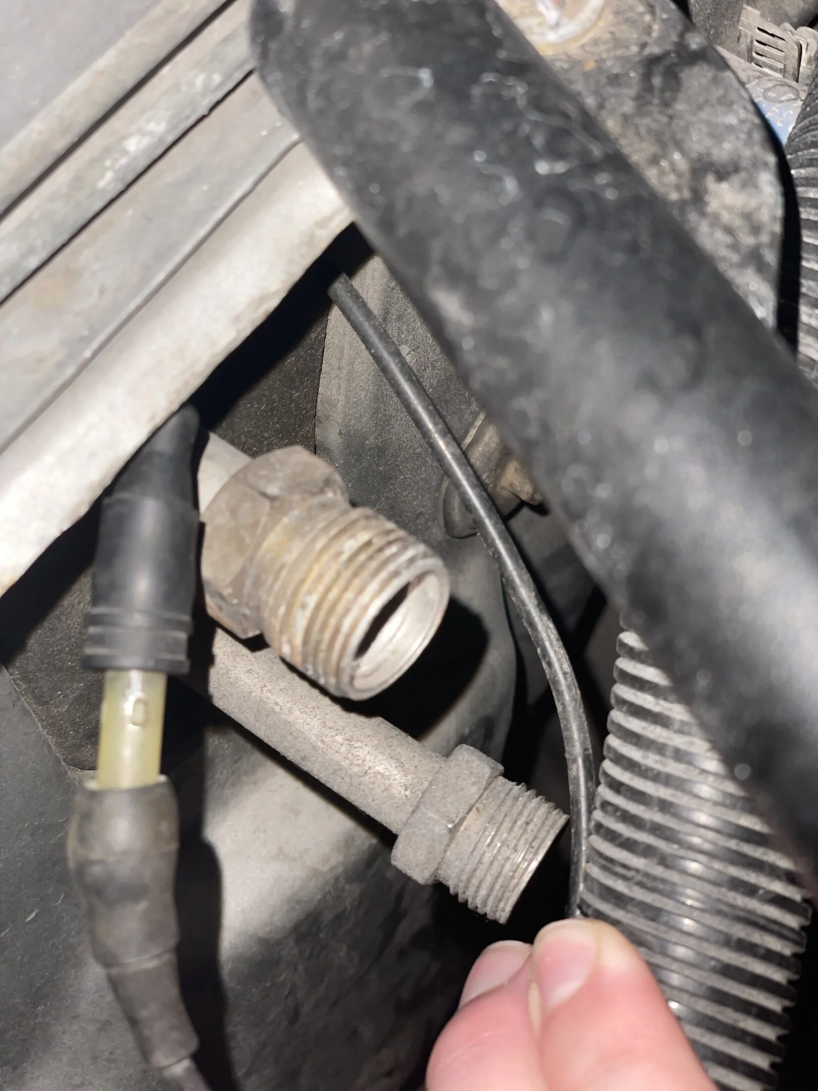

Friends, I have a question about AC components…
I’ve long wanted to install AC in my car. This became a more urgent item on my list after moving to the swampy sweatbox that is South Carolina, but I assumed I needed to take out the dash and put in an evaporator to do it. However, I also know there’s a couple of pipes on the firewall that look suspiciously like factory AC hookups:
Does this mean the evaporator is already in the dash? And if so, is there a flushing process I’d have to do before hooking it up to a compressor and condenser?
If you’ve read my previous posts, you’ll know that I have some bigger, more chronic problems to resolve in the future, but if I can make the car more bearable to drive in the meantime I’d like to pursue it.
Yes, those are your condenser hook ups/
Do your HVAC controls show an AC setting??
In other news, the pool job fell through at the last minute and I’m now looking at a job in landscaping that looks promising. School started up as well, so I’ll have less time to tinker in the garage for awhile, which will probably be good for my bank account.
If your going threw there trouble with new parts, replace it.. Its probably been sitting open for years and rotted to all hell.
