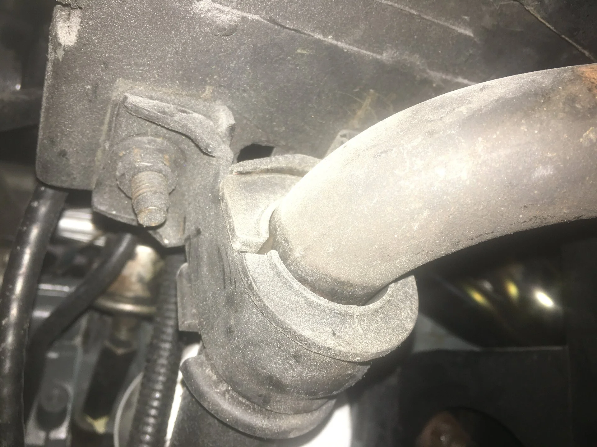

I still think your missing the top plate(plate that sits inside the U shaped portion) that holds the sway bar bushings in place,but you'd need to verify.The complete brackets should look like this.

And I agree...... he is missing part of those brackets unless things have changed since the last pic. Good catch.
The sway bar is about the only part that I haven't changed down there at this point, so you're probably right. Would that cause a lot of play in the steering? There's quite a bit but I can't figure out where it's coming from. I don't have a rag joint to worry about anymore and I don't think it's my ball joints or tie rod ends since they were just replaced. I'll grab a pic tomorrow morning, I'm planning on changing the oil and cleaning up a few other things while I'm on vacation from work.

Ok, here’s a picture of the sway bar mounting points

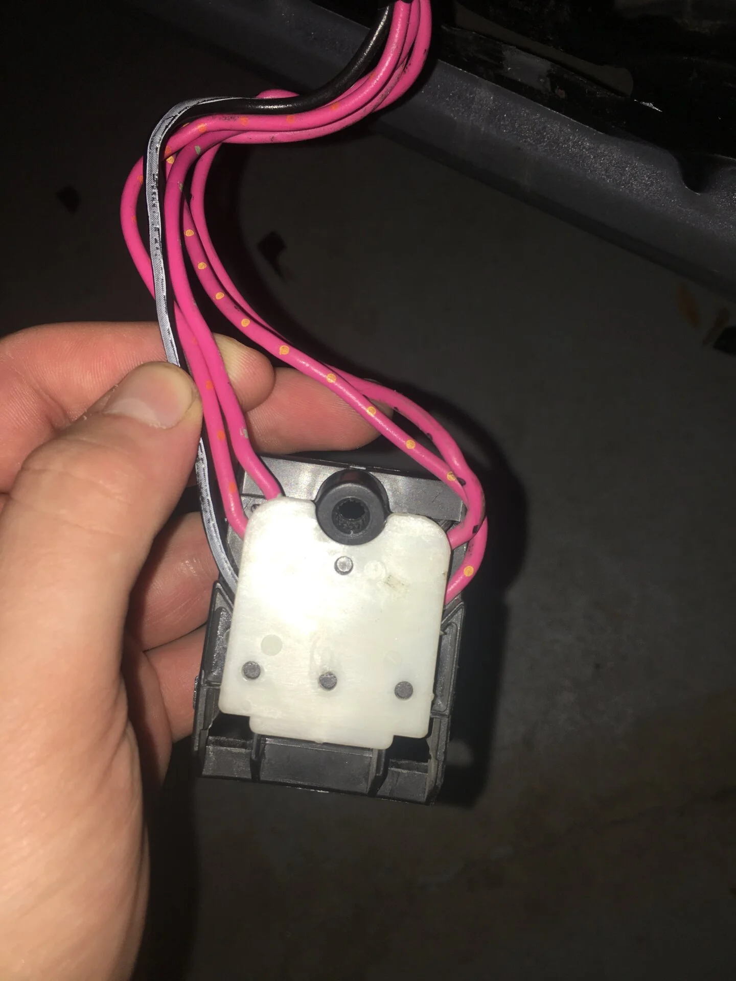

I have another problem, theres a big show (Radwood) in Chicago this weekend so I wanted to finally get my passenger side window switch wired up so I could put the interior back together.
I decided I’d take a look at the drivers side switch thinking they’d be symmetrical and while I was pulling the door panel, the wires for the power lock switch got pulled out.

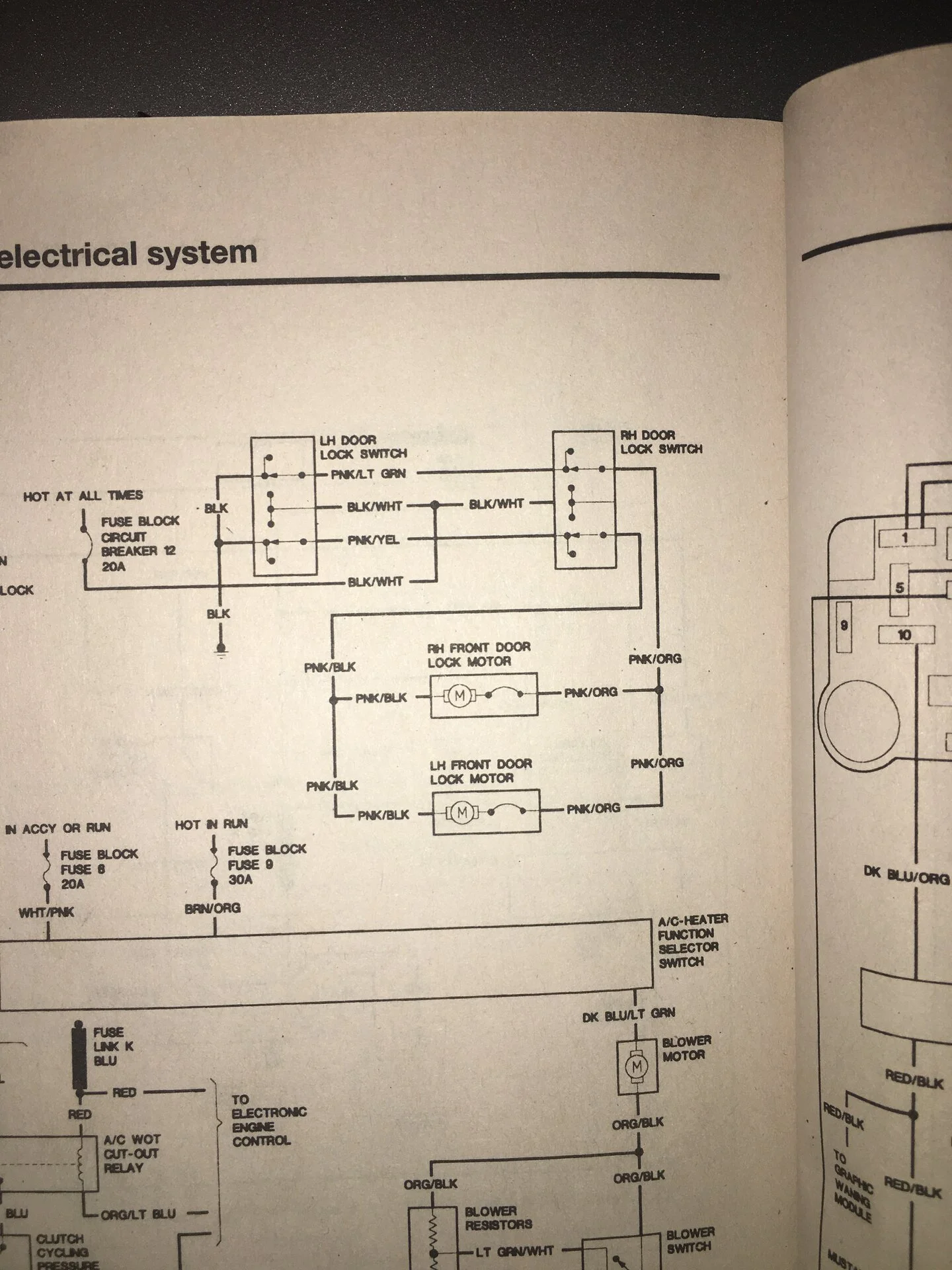

I’ve tried a lot of combinations but none of them seem to work, the doors either only lock or only unlock, or actuate on their own without me hitting the switch. I’ve seen the wiring diagram and all the wire colors are correct but the connections don’t match what I have on the passenger’s side, so I’m guessing it’s not accurate for the driver’s side either.
I know white/black is hot all the time, but that’s about all I know.
I think it’s supposed to be as follows:

However on the passenger’s side the black and white wire is not in the center, instead it’s in one of the corners. I’ll grab a picture when I get home, but it’s kind of a puzzle.
Plus I’m red/green colorblind so that’s not helping either.
Ok, here is the passenger side lock switch:
And here’s the diagram I’ve been looking at:
It looks like the black/white wire is supposed to be in the middle row of both switches, but here it’s in the bottom row (or top depending on perspective).
Is the driver’s side switch wired the same as the passenger’s? And if so, where do I put the two black ground wires?
