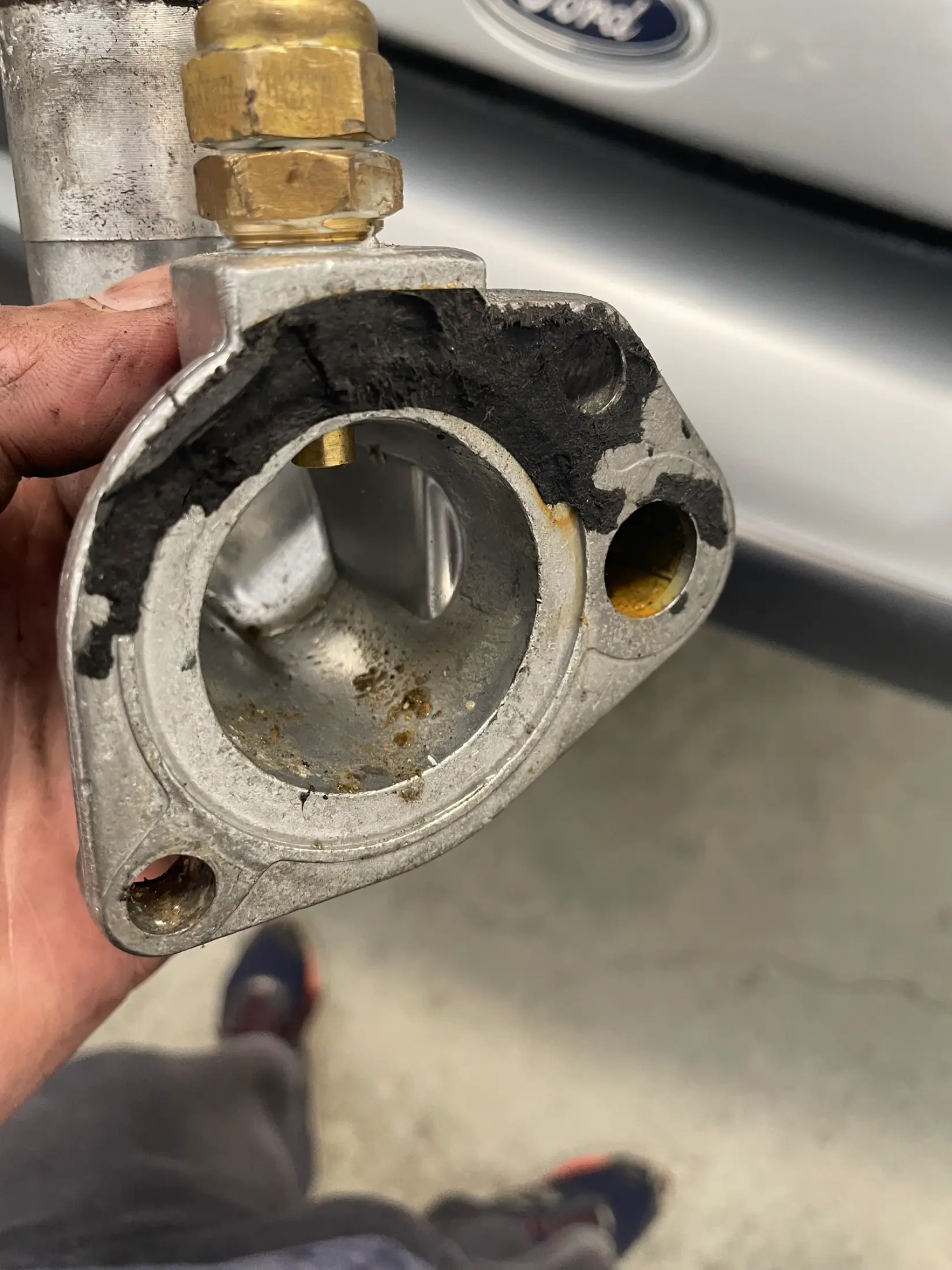

Not much progress so far this weekend.
I pulled out the old starter, which was a pain in and of itself. Then I noticed water dripping on the floor and traced it to the thermostat housing.
I pulled off the housing and it looked like this:
I think what happened is the thermostat fell down when I was installing it, which caused water to seep into the gasket and make it dissolve. Are these gaskets supposed to be made out of paper?
In any case, I scraped the remaining gasket off the manifold and housing and am now looking for a new gasket, and a way to keep the thermostat in place during installation. Some people recommend spraying an adhesive on the thermostat to make it stick to the housing surface, but that seems like it would make it hard to replace in the future. Others mentioned axel grease, but I don’t think I want that in the cooling system. I need something temporary that’s also water soluble, I think.
Also for the gasket, what should I look for? Oreilly only had Felpro and Murray and they both looked like paper gaskets. Mr gasket makes one that has a rubber insert which looks like it would seal better, but I’d have to order it. Ditto the one from Motorcraft.

Two drops of super glue will hold the stat in place. I also like to use a light coating of the grey water pump/thermo housing rtv.

I believe when I did my thermostat I didnt use paper gasket but used a bead of rtv sealant. Its been awhile someone else may have better recommendations.
Paper gaskets are the norm. The real issue is keeping the thermostat in the correct position while installing the housing. I did mine without using anything to keep the thermostat in place, but it’s really tedious.
Bill

Just smear a thin coat of blue RTV on the face of the housing, including the ridge for the T stat, orient the T stat in the ridge with the 'weep hole' at the top, slap a paper gasket on it and let it sit over night or at least a few hours, slap it on the engine.
I smear a thin coat of blue RTV on the intake side too just before I slap it together but that's just me, I hate leaks!!

I smeared rtv on both sides of gasket, let it sit for a few, then put it on.

I finally settled on the felpro gasket and used a couple drops of gorilla glue to hold the stat in place while I installed it. I checked the alignment in the housing with the scope, it looks good.

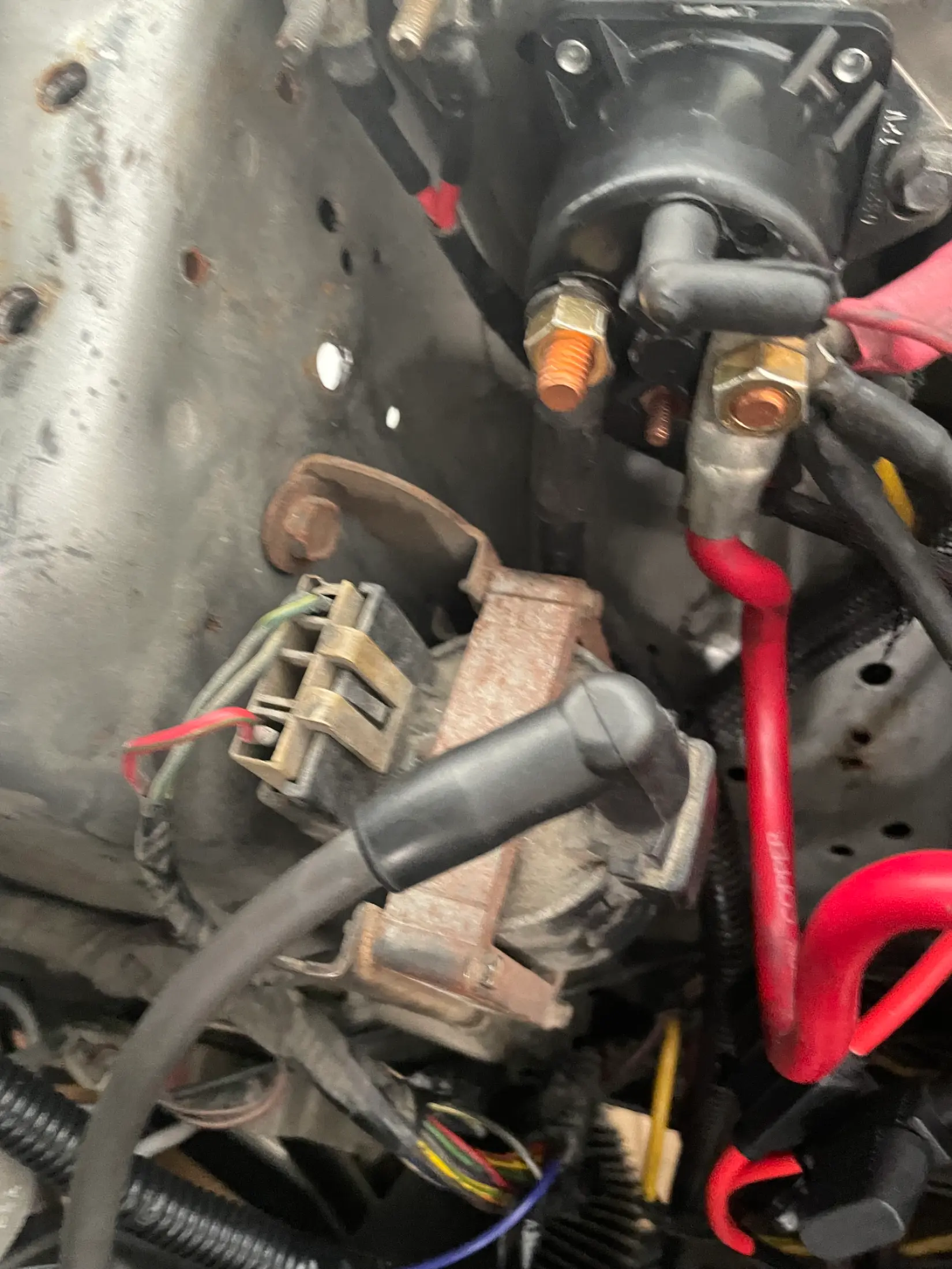

Ok, running into some little issues with installing the starter and wire.
I’m installing the SVE mini starter, and in the instructions it says to switch the starter cable to the same post on the solenoid as the positive battery cable. In some videos, it shows this being the left stud, in others (and mine) it shows it on the right. Does it not matter as long as it’s in contact with the positive wire?
I’m running out of room on that post, regardless.
On the right post, I have:
-Positive batt. Cable
-2 30A fuses for the fan relays
-The alternator fuse cable
-A red wire that attaches to this circuit breaker for something:
-1 connector to three wires, one big and yellow, the other two small and black. The two black wires go into the fender, the yellow one disappears into the spaghetti mess that’s underneath my battery tray.

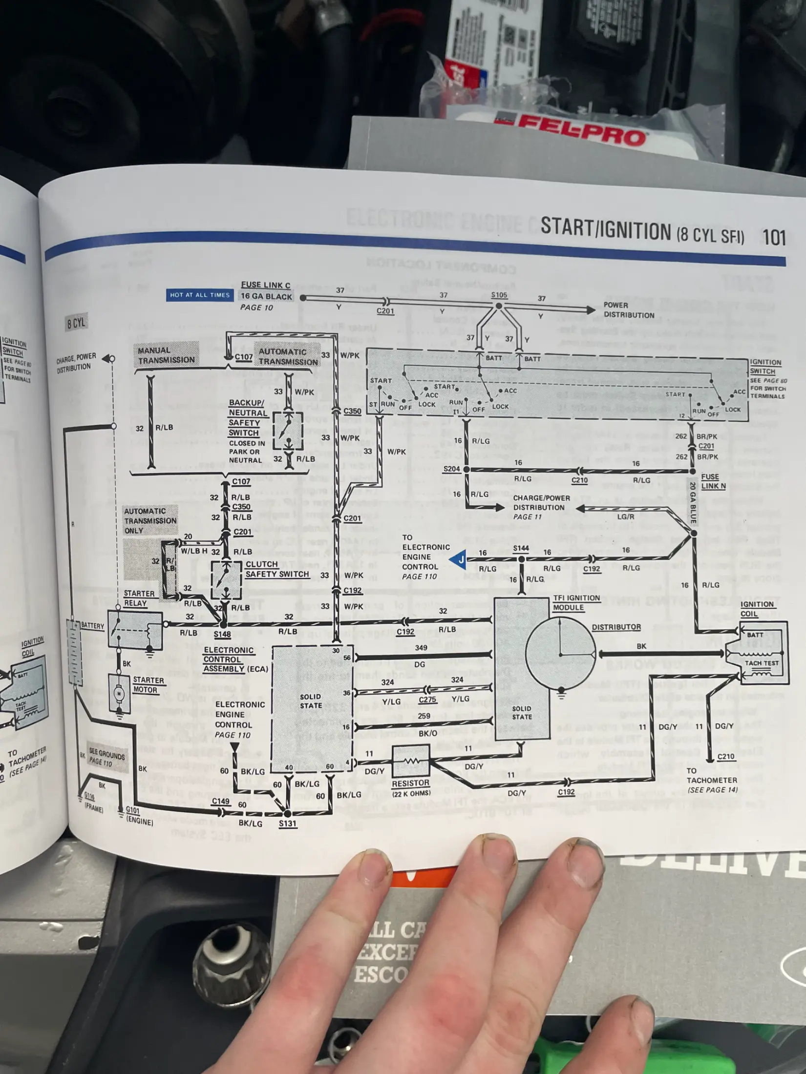

On the other post I have:
-starter cable
I’m looking at the “Start/Ignition” wiring diagram in the troubleshooting manual from ford, and I can’t make heads or tails of it. It looks like I’m supposed to have red and light blue wires coming out of it somewhere?
None of this may be accurate since the car is a combination of parts from different years.

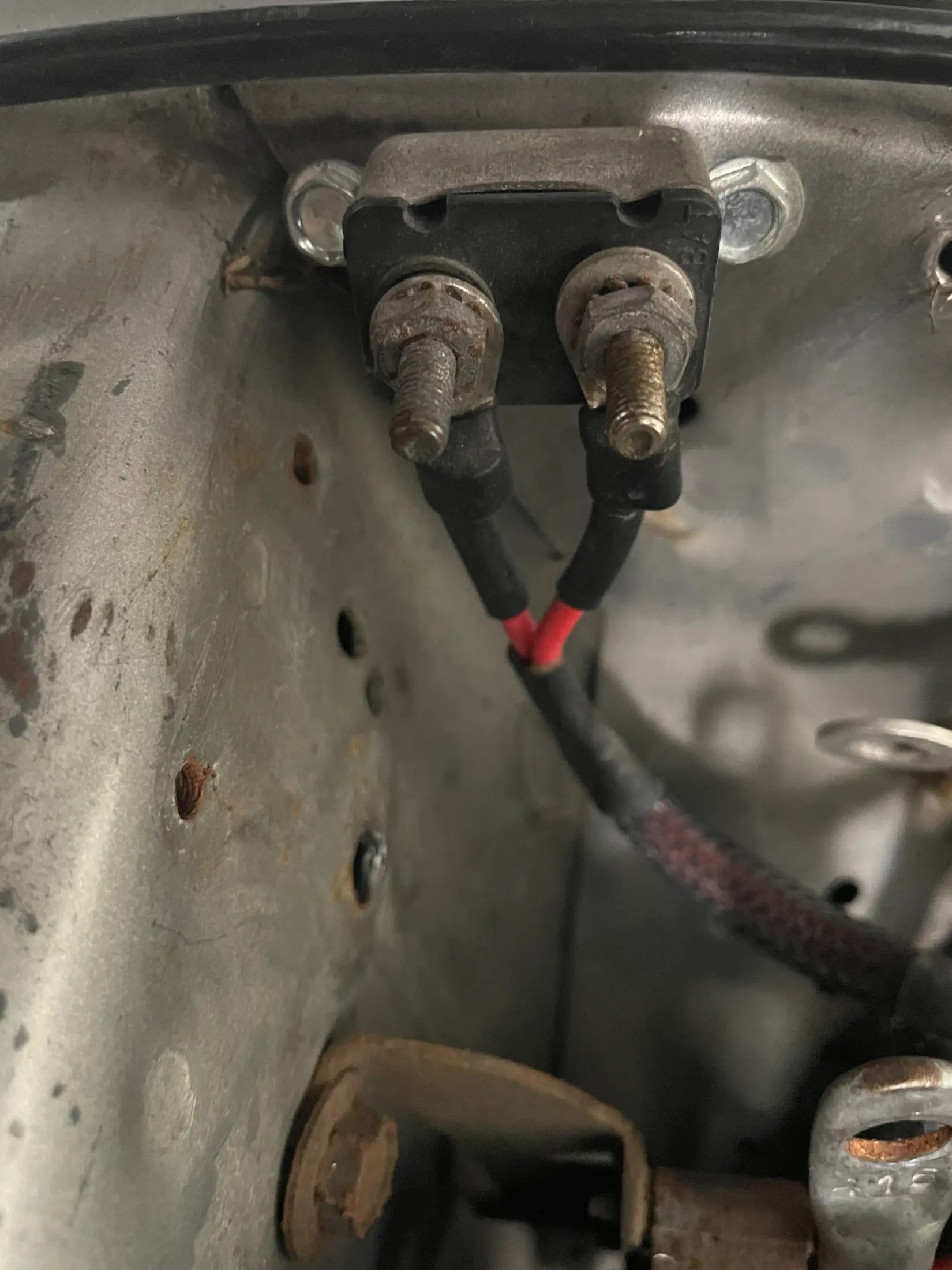

I replaced the starter cable and mounted the brackets in the correct spots, as my old one was dangling.
Speaking of dangling, that’s basically what the wiring harness for my exhaust o2 sensors are doing. Is there a correct way to restrain them?
To remove the negative battery cable, I had to remove the drivers side fender liner and the windshield washer tank to get to the other side of this bolt:
Which looked like this:
That cylindrical thing is loose, I think it was tack welded at some point but I had to use some pliers to keep it from spinning.
After freeing the cables, I found this:
I have no idea what all these wires are for, or why they all converge into one wire. They all go into the fender and back into the interior, so my guess is they’re a ground for some interior electronics? I don’t think they’re supposed to look like that.
The broken terminal goes to a black wire that seems to follow the cluster back into the interior. I’ll have to get a new terminal connector for it. I’ll look some more in my books to see if I can figure out what this is all supposed to look like.
