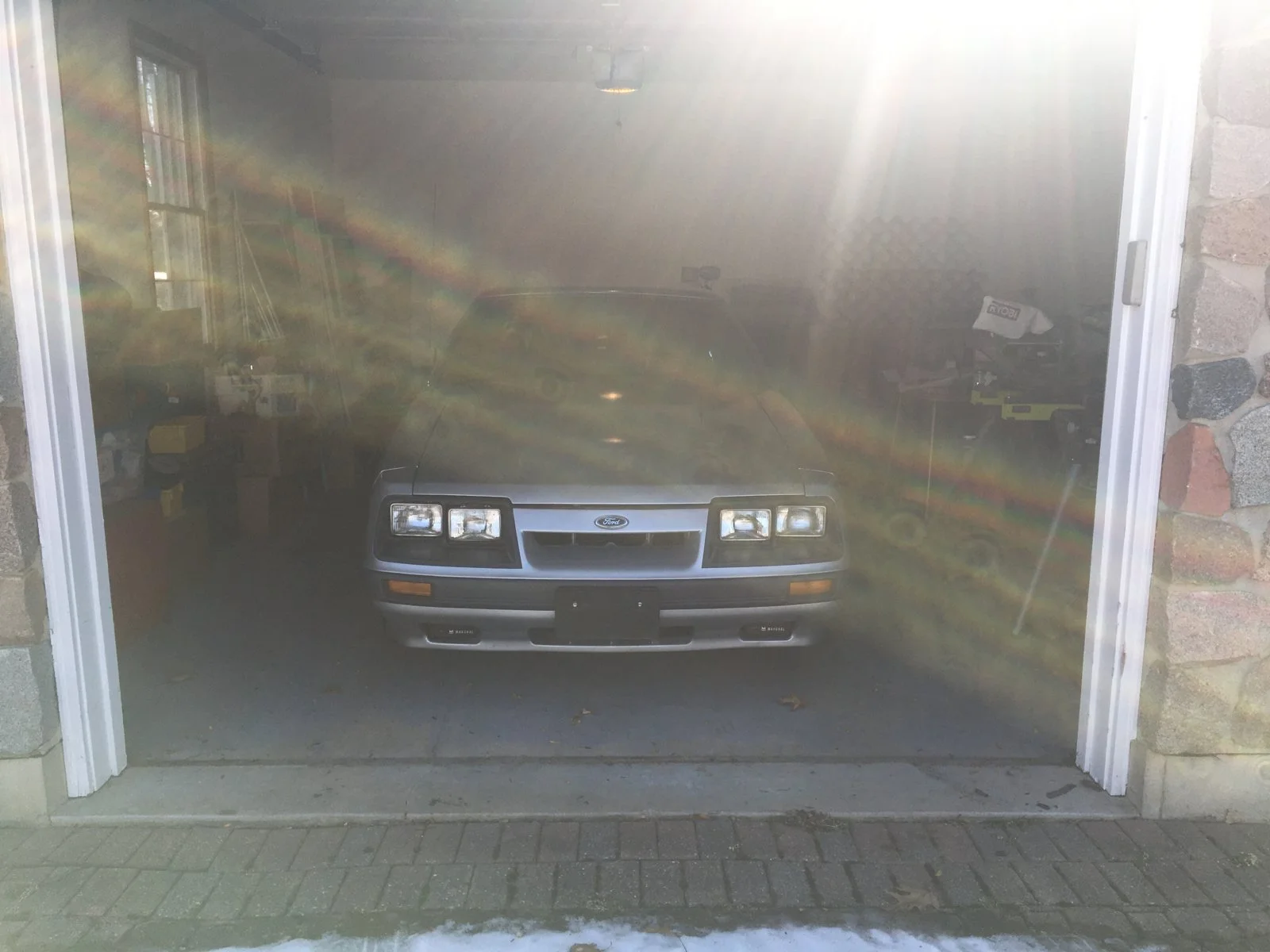

She's finally here! The seller came by and dropped it off yesterday. It runs and drives (at least up my driveway), but there are still a few small things that need to be fixed. Here's what I found so far, in order of importance:
  1. Front seat belts don't lock up (I sunk some money into a new set, they're old and dusty anyway)
  2. Horn only works if you really punch the steering wheel, think it's probably the pressure switch inside which is interesting because it came off of my old car and it worked fine back then.
  3. Passenger side mirror doesn't adjust properly. I can't get it to cover the right spot on the car.
  4. Front and rear tires don't match and all 4 look old.
  5. Windshield washer nozzle sprays over the car instead of on the windshield.
There's also some small interior things like the map light and the little indicator lights at the base of the dashboard next to the clock don't work, but those aren't too critical. There's also a small lever on the right-hand side of the steering column. I thought it might be a tilt release, but when I pulled it nothing happened, so I don't know what it is or if it's broken or not.
I'm not planning on driving it until the weather clears up, so I'm going to have plenty of time to sort through all this. I also just took care of insurance and I'm planning on going to the DMV to get it registered and get the tax paperwork taken care of.
