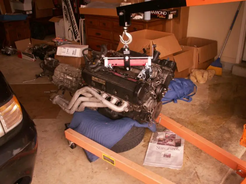

I got mine out without removing the headers.
