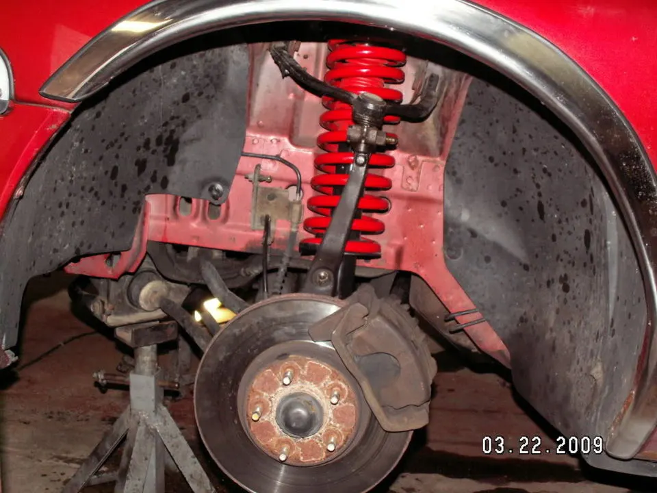

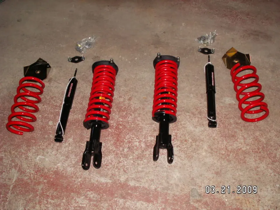

Ditching the air ride.

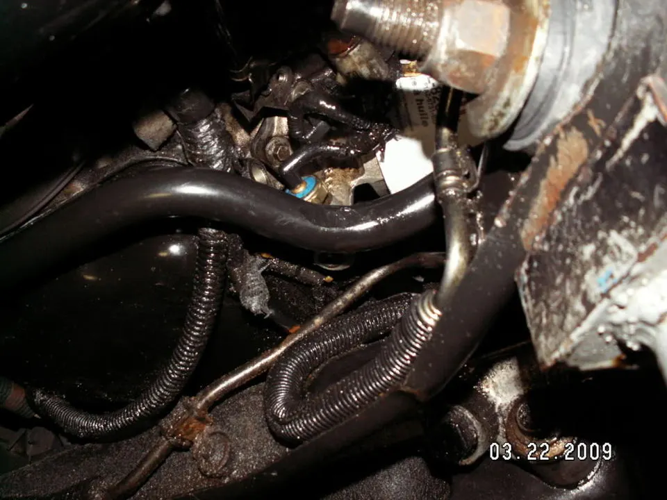

This car had a horrible leak from the Oil filter mounting gasket. Its between the block that the oil filter mount. This piece even has a coolant passage too. Can barely see it. Can you say "Carpal Tunnel"

Of course all goofing off happened after all said work was done. That gasket that resembles the male genetalia was actually the old one. Seems this part on the 4.6 motor has a rubber ring that eventually collapses over time allowing oil to freely leave the block almost as fast as you can pour it in.
