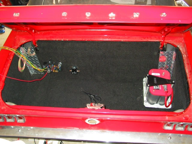

I've never heard anything like that. I've heard the direct opposite, due to their spiral design and gel, they have much longer shelf life, they hold their charge longer. I've been using them for years , never had a problem, wouldn't use anything else. However, like any battery dont let it sit there for 6 months without use, and dont leave it sitting on the cement floor, just be sure and get the red one (for starting)
the yellow one is deep cycle, for RV's ,Boats, camping ,deep cycle.
