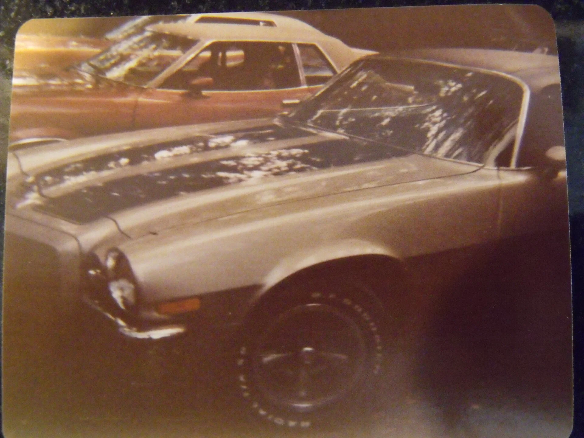

The last time I used headers on a car was on my Z28 in the late 70's,,,, Curious on whats new in products..
