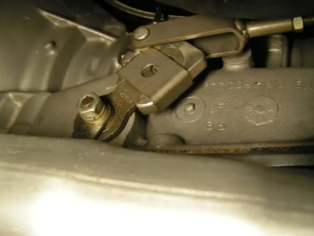

I did just that and found that my tv lever on the trans has some resistance to it, this is what is causing my stiff pedal. There does not aseem to be that much binding in my cables. How hard shopuld the tv lever be to move on your trans? Mine is not "hard to move" it just has some resistance, enough to give me a real stiff pedal.

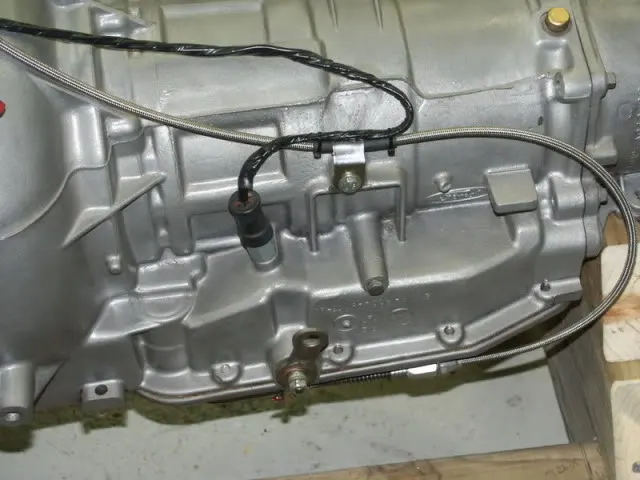

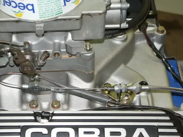

These are about the best pics I can find at the moment that I saved from a forum (not mine). Trans shift lever points up, TV cable lever points down so they move opposite. Are yours moving together?
I'll keep looking to see if I have more, mine's not hooked up yet.

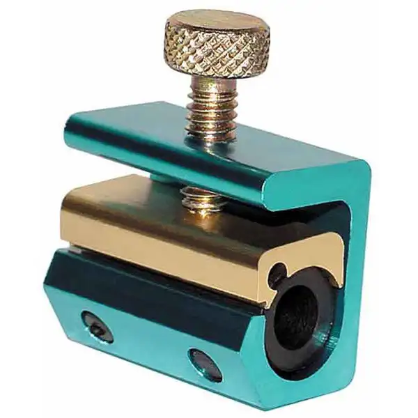

I don't know if Lokar prelubes the cables but I have had great luck with using a mountain bike cable luber ($10) to force lubrication into my speedo cable, brake cables, etc. You might want to ask for one at your local bike or dirtbike shop, it works great and forces the lube all the way out the other end from a spray can/nozzle extension.
You clamp it over the cable end, one end is open, one almost closed and stick the extension wand in the hole on the left and it forces the fluid down the inside of the cable. I use a can of bike cable lubricant, I thought of lithium but I think it would be too thick to force down.
