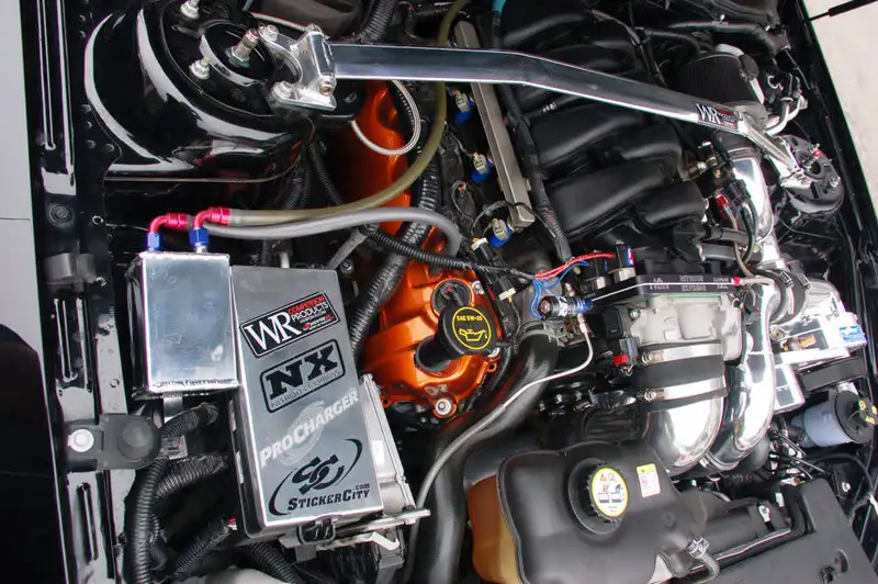

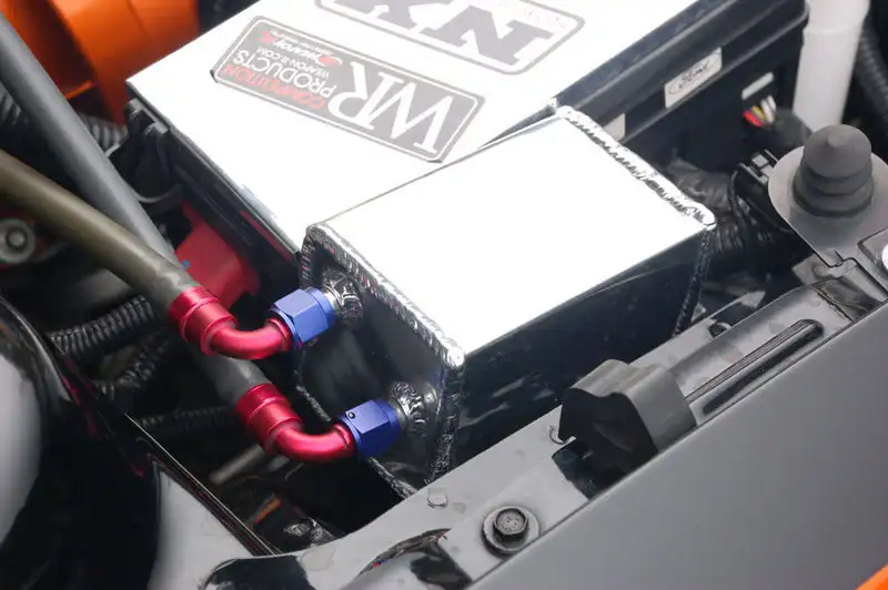

Ok ever since I got the blower on the car I noticed that i was getting oil back into the intake pipe and i didnt like that and its not good either. So I went to work yesterday to finally make my catch tank. It mounts to the car with one of the bolts that are already near the fuse panel. The fittings are -6 and there is also a drain on the underside so i can empty it when i need. Heres some pics...
Well I currently work for a performance manufacture and I do R&D, so on weekends or down time I like to make stuff for my cars. The Strut brace is a one off item that I like knowing that no one else has. If you notice my charge pipes on my blower are new since the kit comes with steel pipes I re-made them from aluminum and then polished.
