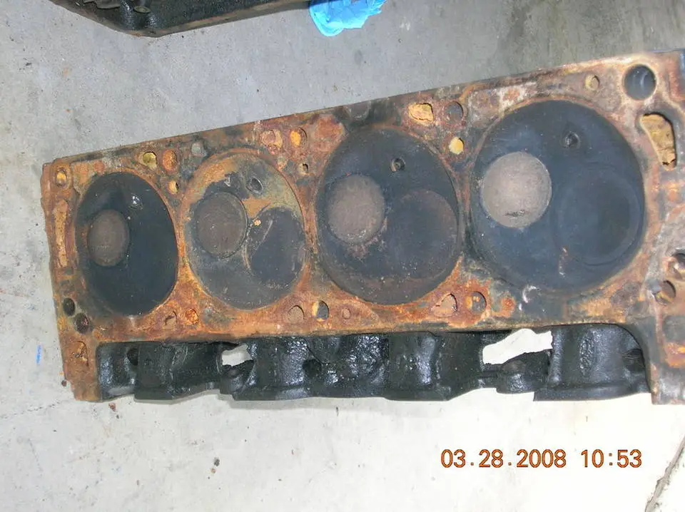

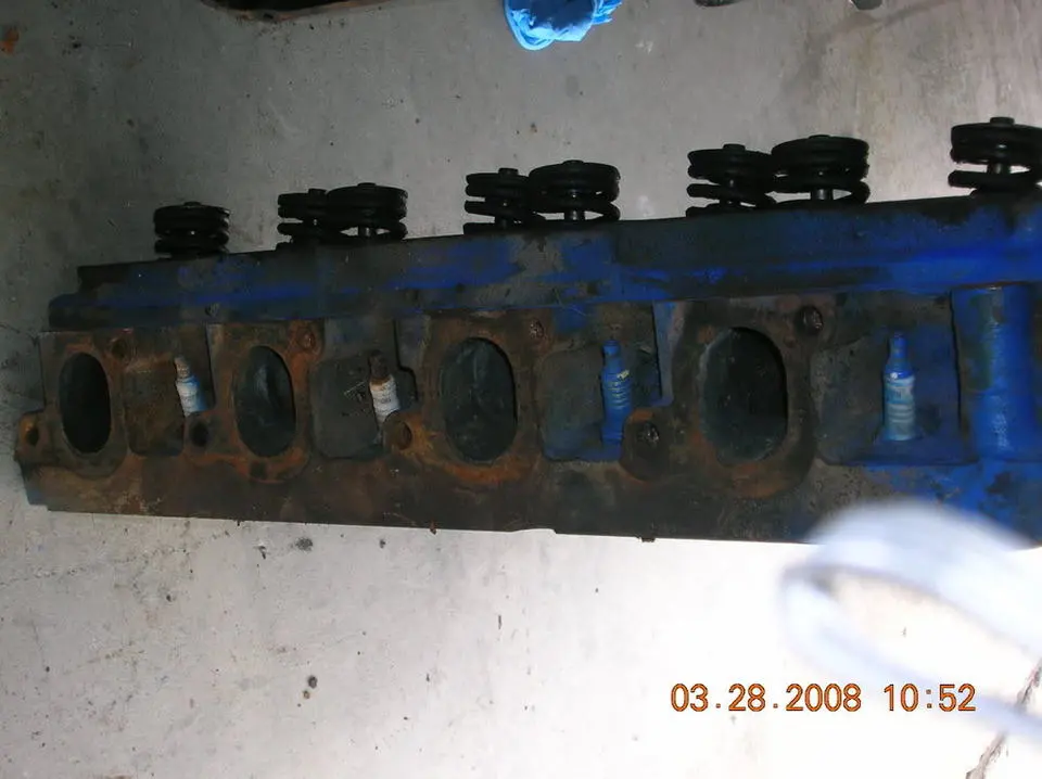

yea i believe i found out that they are 2v heads. here are pics of them. Now being a 2v and what not, does this mean that they are an open chamber head?
wth....
They are 4v heads.
To my guess they are closed chamber heads
if you look at the top left and right hand coner of the head when the valves on on the floor it will tell you if it is a 2 or 4 valve head
The ports look like 4 bbl size to me too, but they're obviously open chambered, both from looking at em and the date codes. 70-71 heads were the only years for quench 4 bbl heads.
did you check both of them?

ok then, if the 2v heads are ok for now, am I still able to use an intake that came from a 4v motor? I am guessing the ports on the intake would be much bigger than the ports on the heads right? So would this cause problems or should i make sure the intake i get is made for the 2v heads? Sorry for all the questions, just dont want to screw myself on parts. I ask this because I want to get a nice set of heads, but if i can use these for now and save some cash for a nice set of heads, and am going to switch to a 4v head later, i dont want to have to buy 2 different intakes.
You can use the stock 4 bbl intake on 2 bbl heads, using the 4 bbl gaskets, but you'll have a port mismatch that's not in your favor. Edelbrock makes 4bbl intakes (Performer 351) that have 2 bbl sized ports, probably a few others as well.
