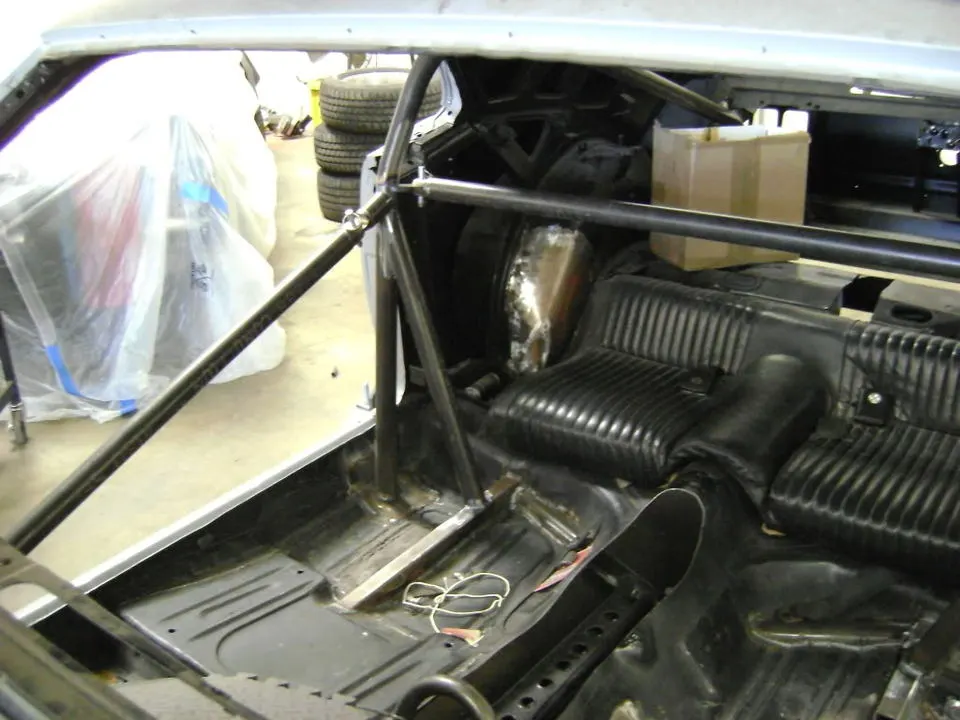

I lowered my engine 1" also. The trans support in the pic, I had to cut that off. That was all the clearancing I needed to get the T56 in. Well, I moved the engine back 1/2" so just a little clearancing at the firewall cut as well.

so if you cut out the support...what did you replace it with?
If you look at the support it is there to hold the weight of the transmission hanging off it. At first I was worried thinking it was tieing the frame rails together but I came to the conclusion that what I left was just as effective at tieing the rails to the floor. My T56 is mounted on a modified foxbody double-hump cross member and mounted farther back on the frame rails.
