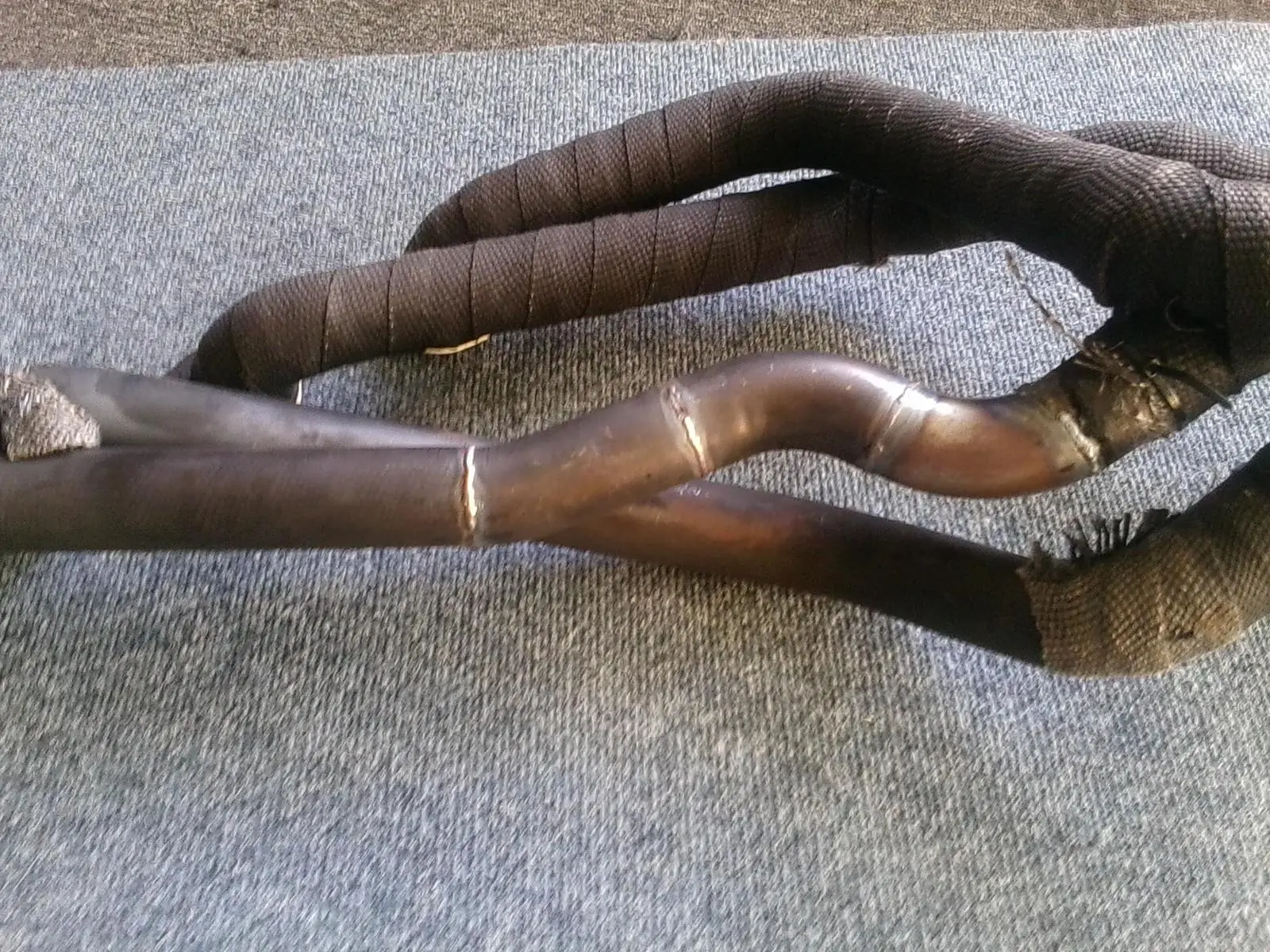

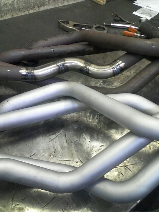

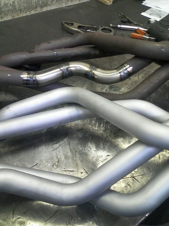

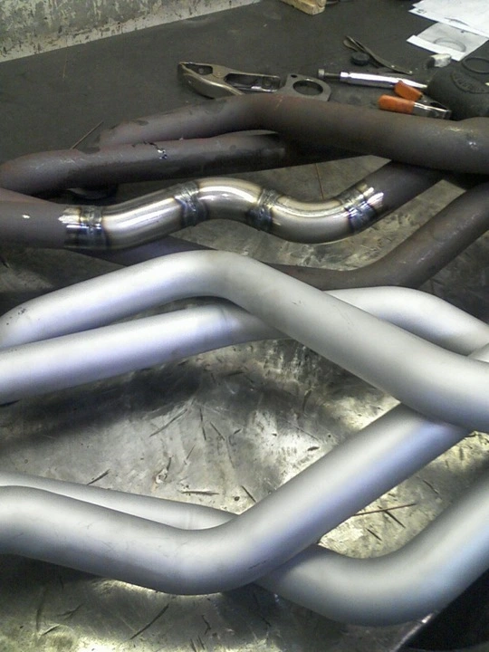

Here is a stock 88300 bottom And My modified one on top...this header needs to be modified if u want the cable to go straight in without bending it
Sent from my SPH-L710 using Tapatalk 2

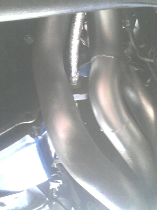

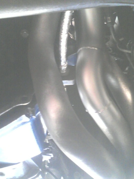

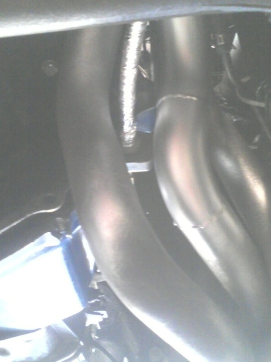

Fox bell with sn95 these headers at number five tube wind up literally right in front of the bell housing where the cable enters..I don't doubt you but I wonder if you could have gotten different headers because I have had more than one friend with the exact same issue as mine
you can see in this picture with the modified Tube it still barely clears. before I had it modified I almost could make it work but I had to zip tie the cable out of the way which provided a bad arc for the cable and a stiff pedal

I'll send a photo and re-check my invoice when I get back to CT in May, I know these cars differ somewhat, but this should be exactly the same car to car. You are using the longer cable thean needs to routre around the oil filter, correct? I know that the shorter cable presents melting issues, but the loneger cable is a straight shot into the bell for me. I don't have the 883000, I do have the 88306 which may be slightly different, even tho' the piuctures look VERY similar.
Yea I have the longer cable...I have heard the 351 swap headers will work with the 5.0 289 302 and b a straight shot..Yea I'd love to see pics

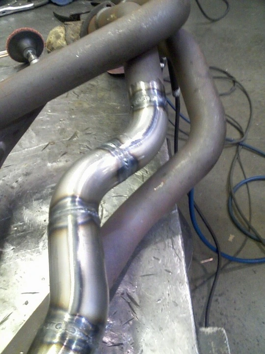

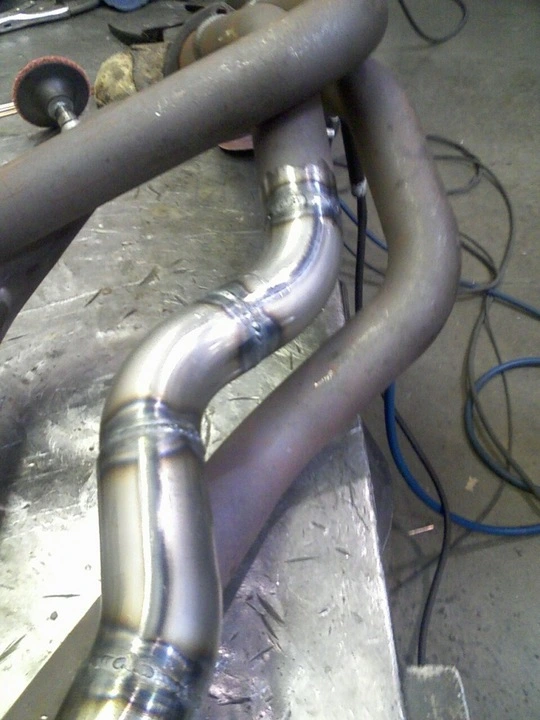

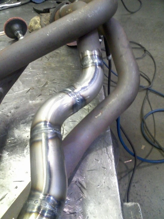

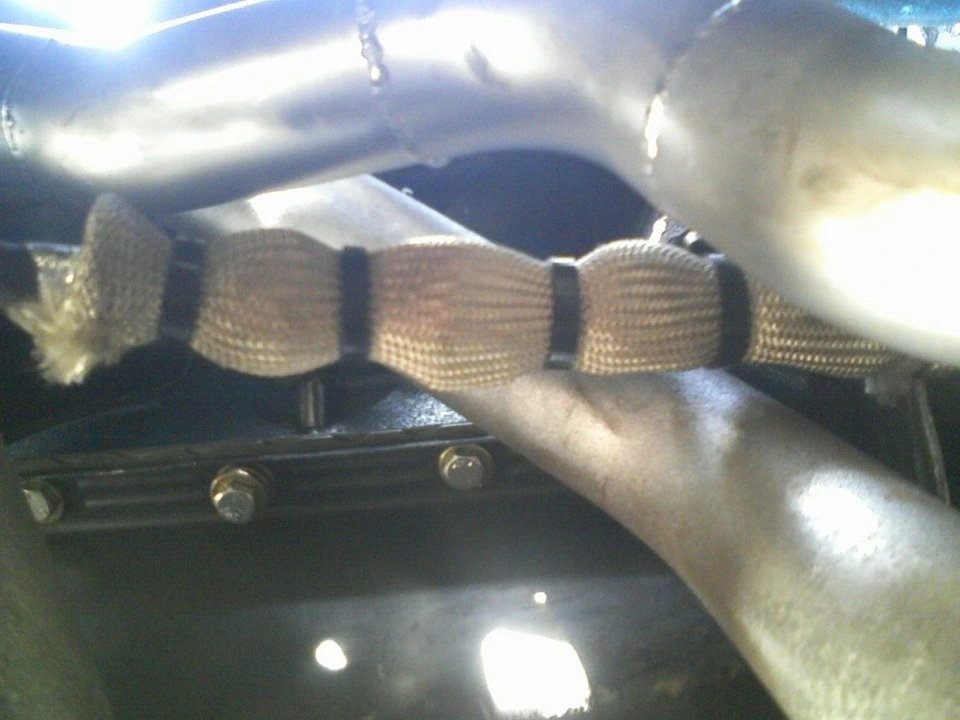

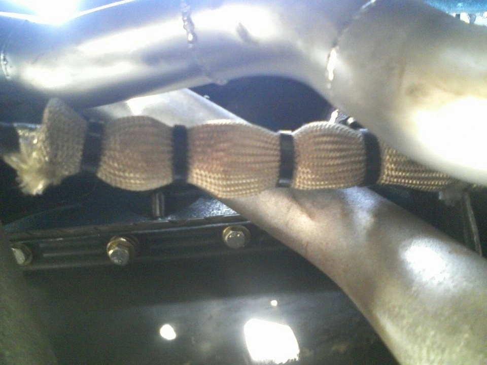

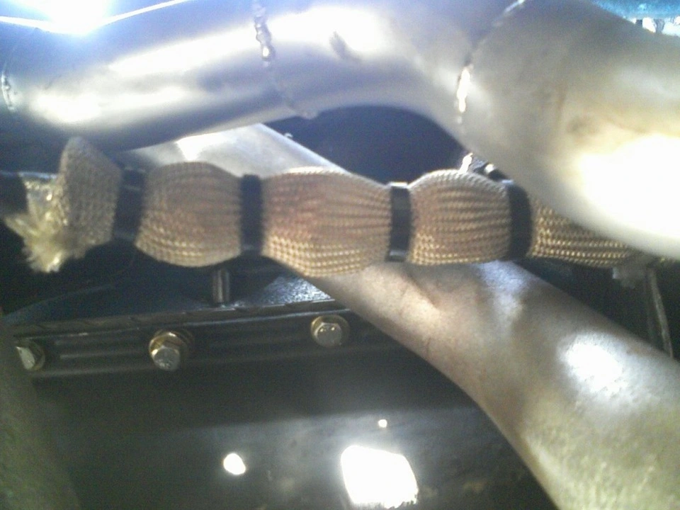

He he...mine were welded by my friend who is the fabricator for a major header co...
