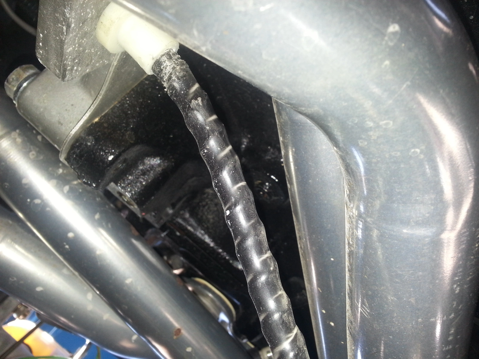

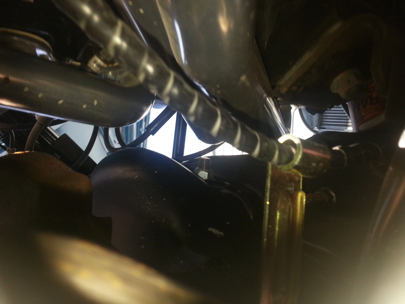

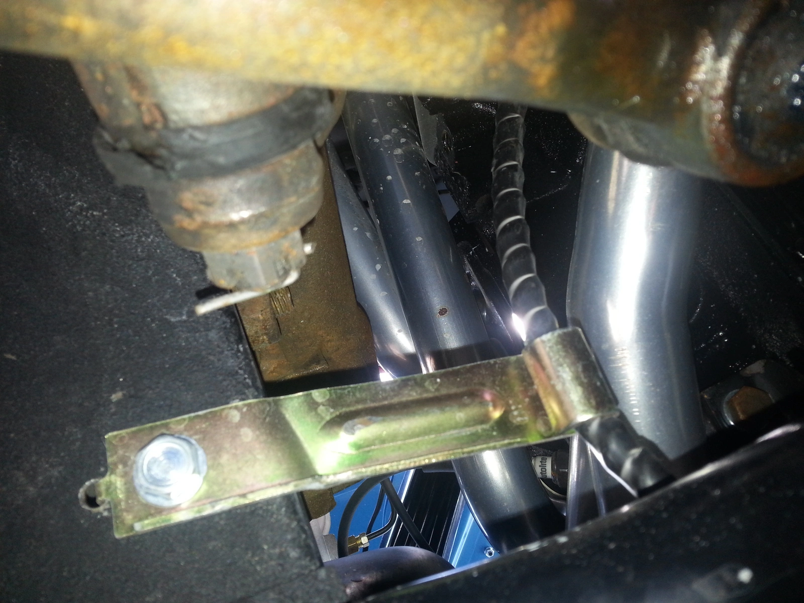

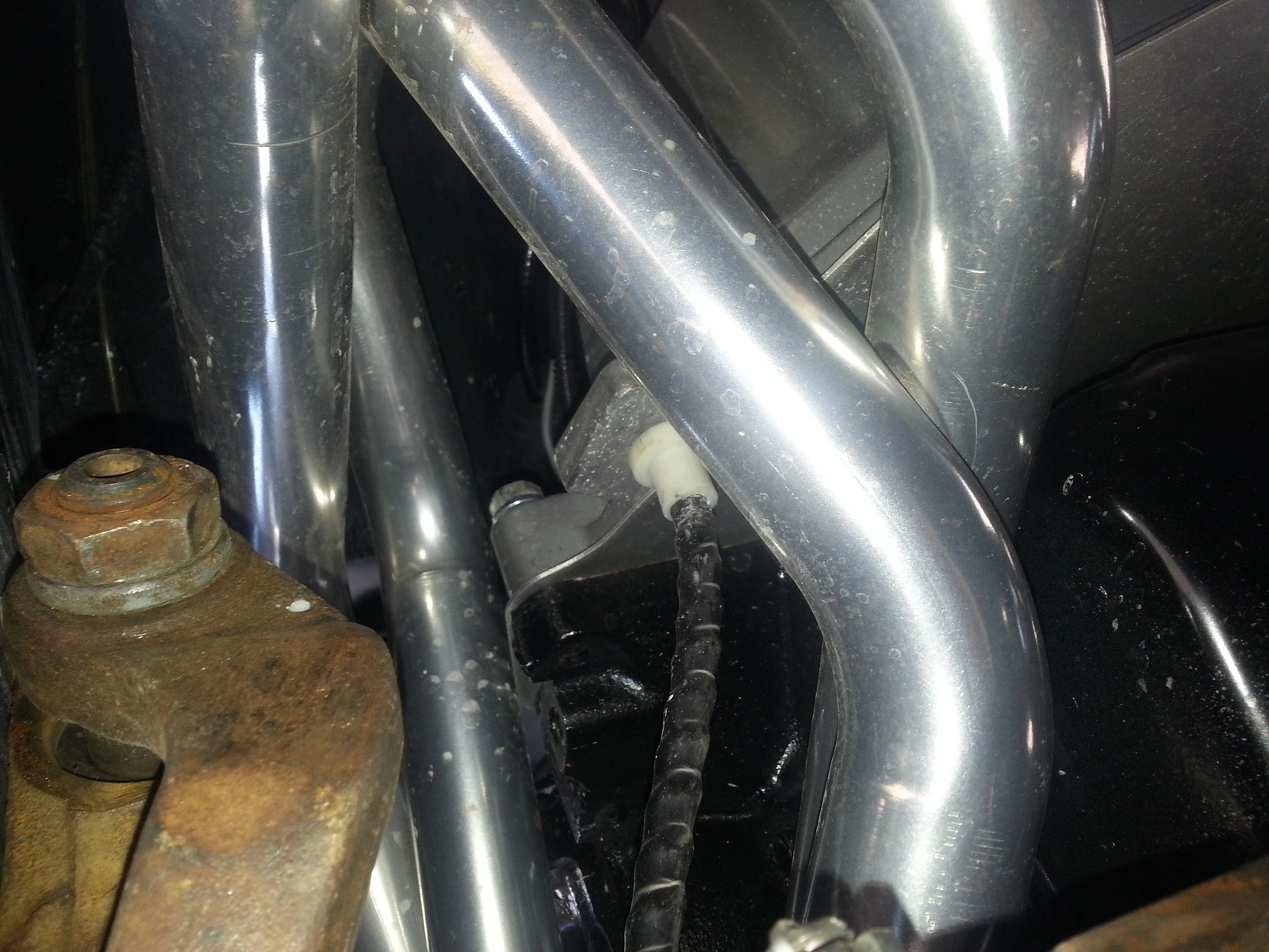

Cable routing with Hedman 88306. I did use a stanchion to hold the cable off the headers. I have at least 1 inch clearance and the the slight 'loop' doesn't affect the cable action.

thats a sharp bend at the fork..it WILL cause increased pedal effort but more importantly thats gonna cause cable failure over time
