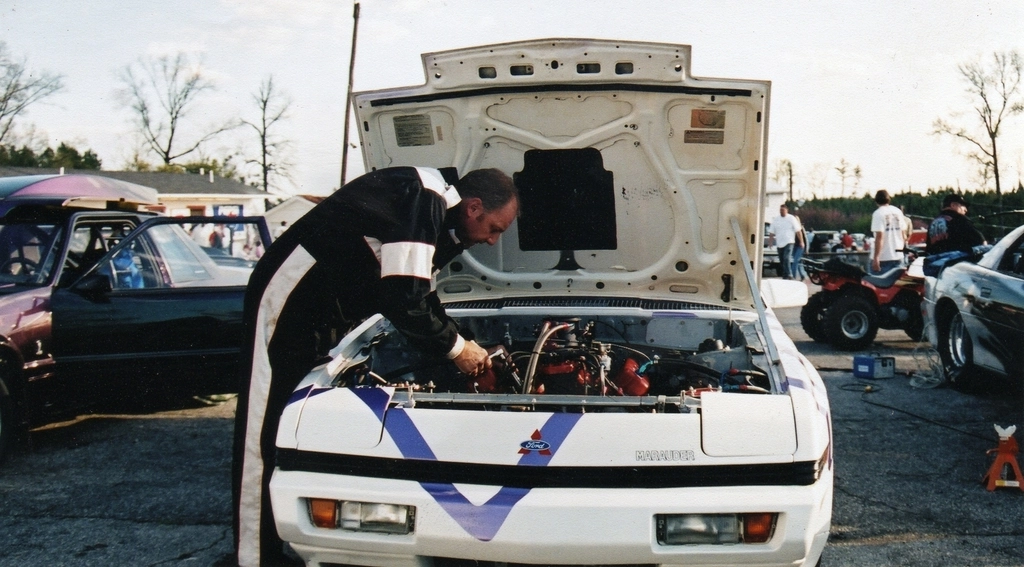

I broke a 351.
The pic of me looking at the plugs on the white and purple Mitsubishi Starion was taken by my 26 year old son when he was....
8?......the plug I'm looking at has no electrode....

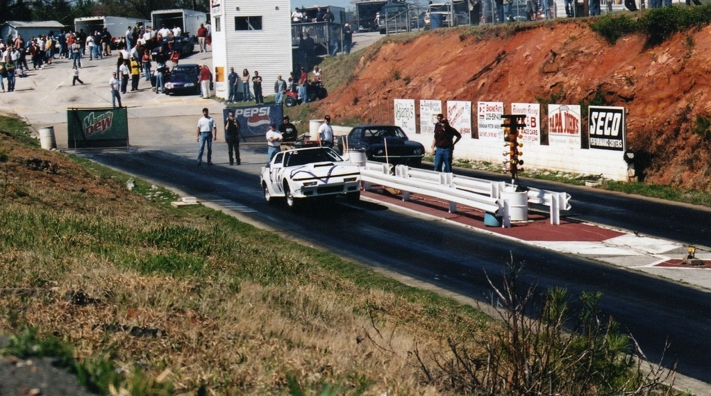

At the time the car was going high 5's in the 1/8th, and I rattled the hell outta the engine when a gas solenoid failed on me.
That engine had those same rods in it that Steve is talking about.
A 3200lb car running 5.65 in the 1/8th was making serious power..i pulled the engine thinking that I'd just replace the damaged piston, but while washing the thing, getting ready to reassemble, I saw the cracks in the main saddle. I got a new block, and ran the thing for the remainder of the season...the rods properly prepped will not be the problem.
