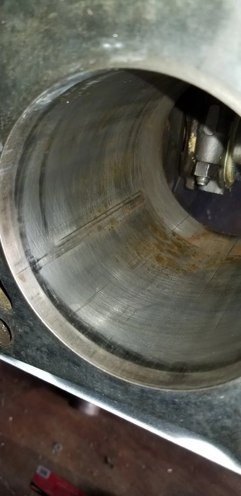

I just pulled the heads off to find std bore on the cylinders and this on #3....
this was in a rebuilt engine. :leghump: me man.
  • Sad
Reactions: KZGUNS
Ok so it barely catches on my nail, maybe it just looks worse than it is.

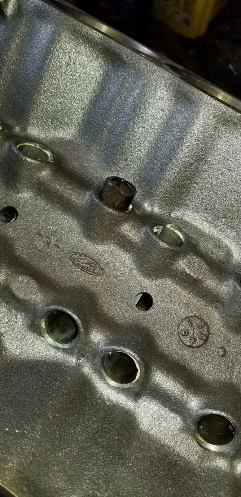

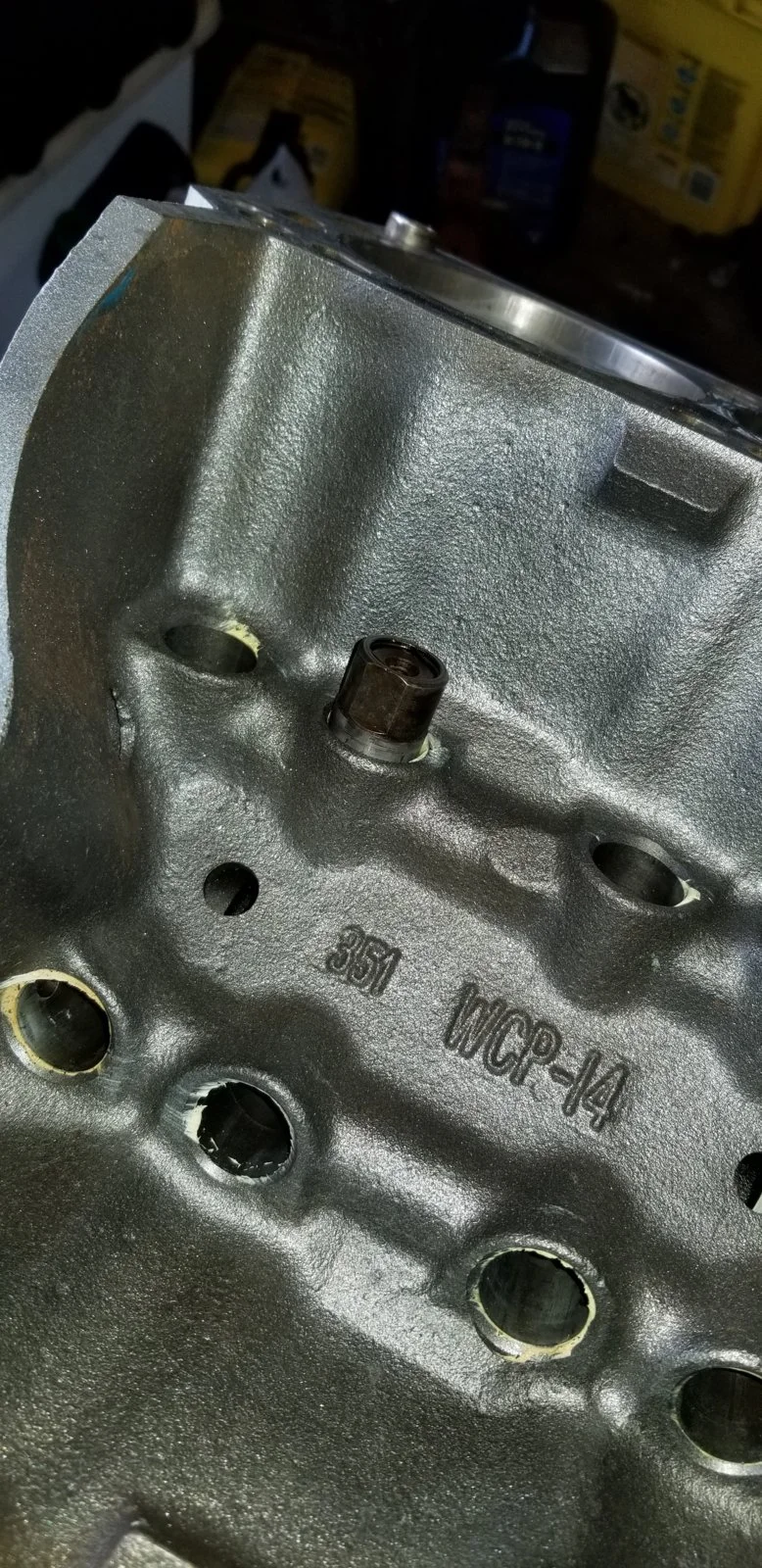

Also the block is a 90... with 92 truck football rods with new bolts.
Is the 90 block roller?
Both of these images are a roller lifter in the bore, keep in mind that's a tappet cam in the block.
I don't think the roller blocks came about till around 93, but I may be completely wrong on that. I hate your luck in this, but things like this are why I say just save longer and do it right. Looks like you will be building an engine after all. Don't cut any corners, do it like you know you should deep down. I have been there, now wishing I had built something stronger from the get go.

I believe the earliest 351w roller blocks were late 92.
Definitely not what you'd expect too see when opening a fresh/sealed rebuild.
I can see the cross hatching and can understand the corrosion from sitting, but the vertical
scoring wtf !

Ok so you say the stock 351 crank and rods hold stupid power? I know people are having issues with these stock rods in forced induction holding up. Maybe you will be fine with good machine work but maybe you won't. So far I would be questioning the history of this engine from either dirt or something tearing that cylinder up.
