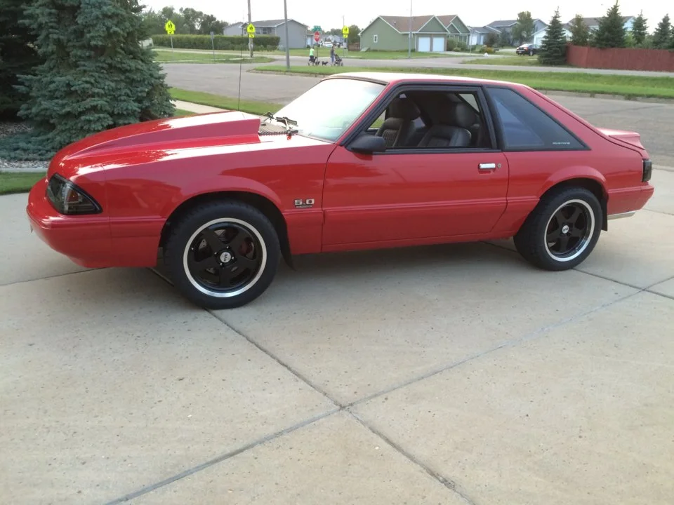

New member here and looking for some input. I bought an '89 hatchback a while back and have been having a lot of fun with it. Car is mildly modded and I've done quite a bit of upgrades to it myself. I would like to get to about 400hp eventually. The car is just a weekend cruiser I like to take out and have some fun with.
As it sits these are the current mods: B303 cam, Y303 aluminum heads, 65mm throttle body, T5 trans.(being rebuilt or replaced this winter),adjustable fuel pressure regulator, 30lb injectors, 3.73 rear end, sub frame connectors, aluminum radiator and contour electric fan, off road h pipe with warlock drag mufflers, all new brakes, 130amp alternator upgrade, SC wheels with 245/45/17's up front and 275/40/17's in back and more that I'm forgetting.
My question is, what is the best way to get to my goal? I'm thinking supercharger but being in the middle of North Dakota, dyno's and tuners are not easy to find. So I'm open to suggestions.

Ok, so I'm on the right track then. The problem that I run into is with the tune. There is only one dyno anywhere close to me and from what I've heard, I'm not taking my car to him. The other closest option is to haul it to a tuner in Minnesota. So can a chip be burned that would give me a safe tune so the blower could be installed and driven without putting it on a dyno? Don't know if I want to haul it to another state since it's just a weekend cruiser.

:nice:Nice car. And yes you can get a tuned chip sent to you. It just has to be a reputable person doing the tune. Would it be absolutely perfect? Maybe maybe not. It can be done "safely" though. Your purposed combo of parts have been done 1000's of times by most good tuners.
