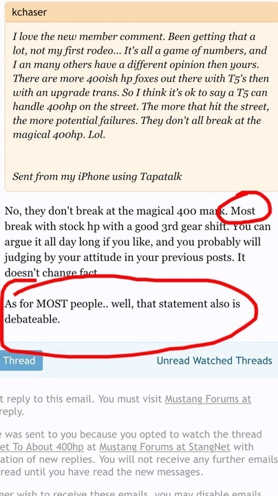

What I read is "opinions not welcome, the sheep are always right". Whatever dude. Sorry something you disagree with requires you to put on the blinders. Good luck, your money not mine.

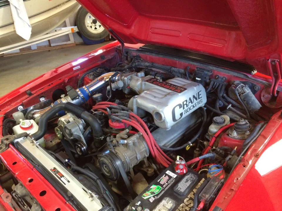

Ok, back to the horsepower topic.
Here's a re-list of current mods with some things I left out:original 302 bored .030", forged pistons, B303 cam, Y303 aluminum heads, 65mm throttle body, cobra intake with spacer, 90mm mass air, BBK CAI, crane 1.72 roller rockers, BBK 1 5/8" ceramic shorty headers, aluminum drive shaft, 31spline moser axles, T5 trans.,adjustable fuel pressure regulator, 30lb injectors, 3.73 rear end, sub frame connectors, aluminum radiator and contour electric fan, off road h pipe with no cats and warlock drag mufflers, 130amp alternator upgrade.
Car runs strong. I had some idle and heating issues when I bought it, but solved that by upgrading the cooling system and fixing some vacuum leaks. It never overheated, just ran too warm. Timing was also at 14 degrees and I bumped it back to 12.
So can you guys give me an estimate on what you think I'm at for horsepower right now?

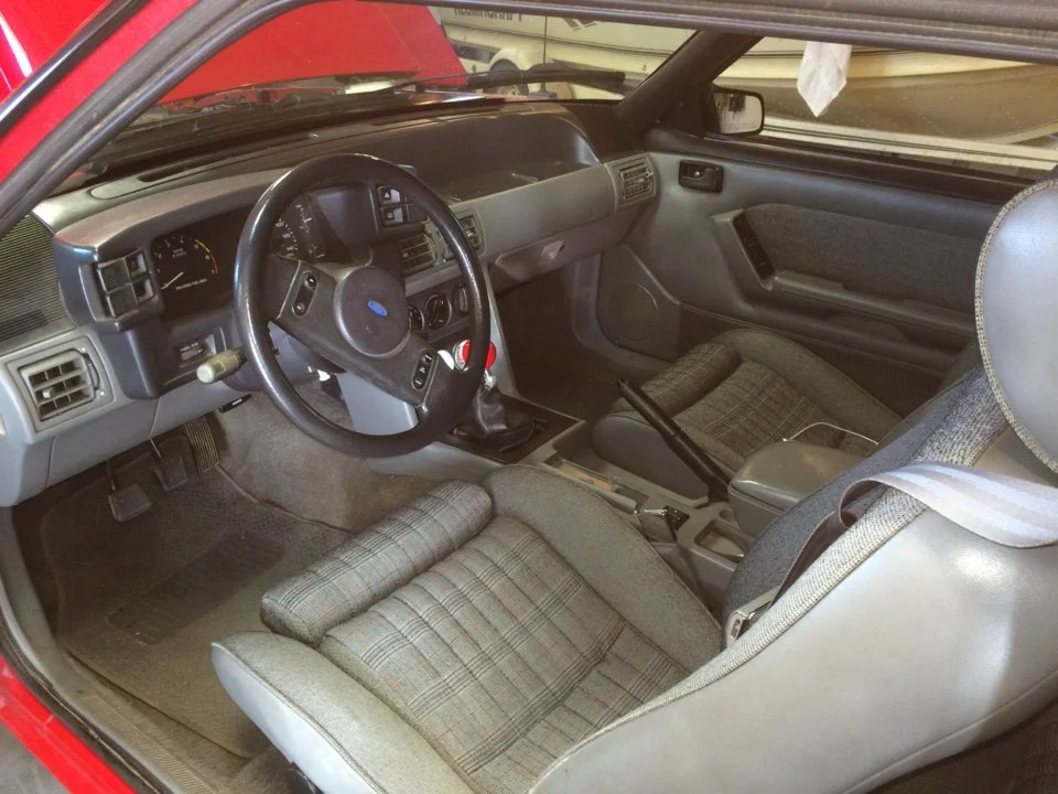

Here's a few more pictures.

Strictly bench top racing I would say 285 to the wheels. Cam is holding you back.

I would guess by looking at some of the combos in that thread @Sparky714 is probably making around 275 rwhp... sound about right? Most similar combos with tw heads or afr are doing about 300.

I'd give a bit more as the y heads flowed more than regular gt40s. With a better intake/cam 300 would be a reasonable number.

I was just looking thru that thread, yeah high 200's looks about right. I do love the idle with the "b" cam though

I would look to get a bigger throttle body and egr spacer. At least 75mm to match that maf. Will help with the sc down the road.
