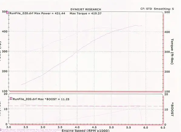

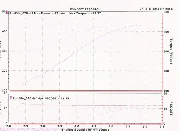

Here is the dyno sheet
http://www.corral.net/photopost/showphoto.php?photo=28456&size=big&cat=681
I lost 20 rwhp and 20 rwtq in the mid range.

Dang, your new A/F is nearly 13.0-1 :eek: PLEASE get a retune before you start getting all over it....that lean condition isnt exactly safe.
And your previous dyno was all jacked up....the curve was all over the place and was missing sections.
So yea, check all of your clamps and get a retune. You may have to pulley down a bit too....once you get your boost back, your gains should go through the roof.

The holes in the original dyno run can be a big problem with the shape of the curve. Do you see in the top right hand corner where it says "smoothing". This means it will average out data to to remove the pikes and valleys and make a "smooth" curve. It looks like a large valley was remove which would raise the curve up.
Boost / blower pressure is another thing. With the same blower and pulley sizes a number of thing can change it. Different cam, or cylinder heads, or exhaust. If the new exhaust is scavenging better during overlap there will be less pressure in the cylinder and better intake flow N/A or FI.

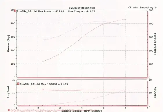

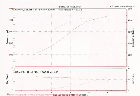

Here's my last dyno from the same tuner! This 26th will be my third time there in as many years. I look forward to going. I have never had a problem. This was the break in tune.
After a few more back to back pulls
His last run was less than 12 flat by his dyno graph? There is just something wrong with the setup since. He has been driviing it for 3 years since his last tune.
