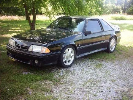

So i recently bought my 93 cobra and I've been using it as a daily driver and there are a few issues.
