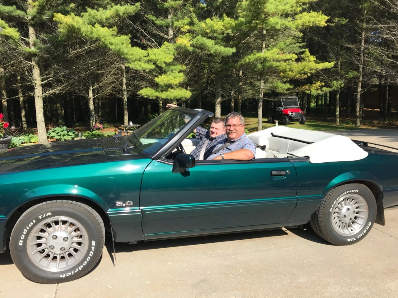

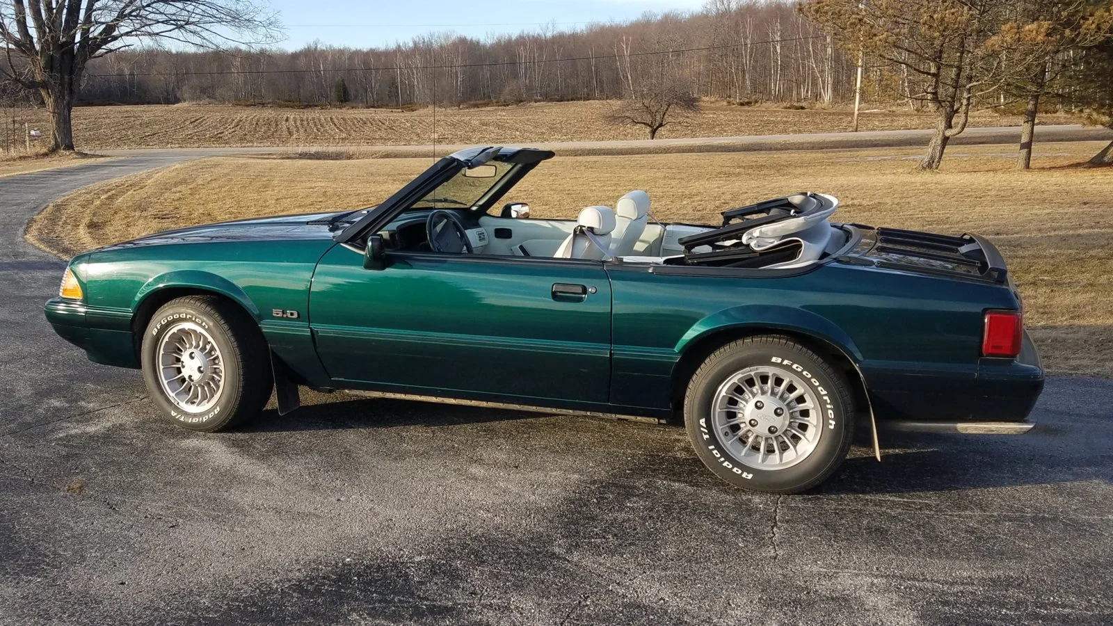

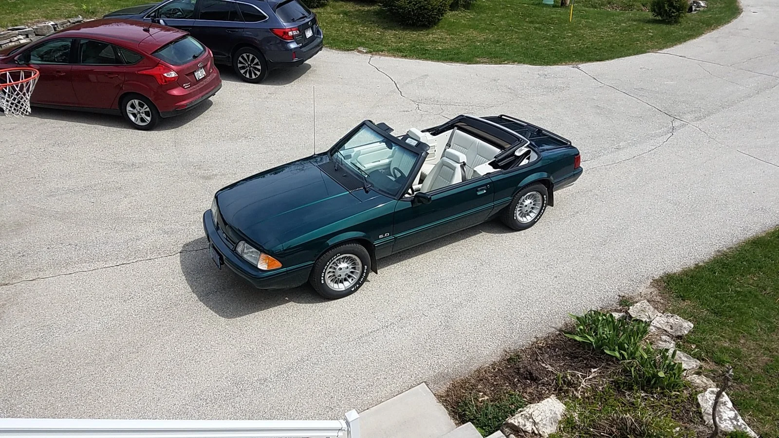

low mile,all original 7up, should I upgrade it or not?
This was from last spring... I have it in storage as of now until, oh I don't know, maybe July!! It just won't stop smowing! ha ha ha I'm dreaming about nicer days, trust me.
I don’t think upgrading the rear gears will hurt its value. Everyone says 3.73’s work with autos well. Just keep your stock gears just in case you need or want to swap them back in. I say swap em to something a little more fun.
Swapping the gears will make a big difference and shouldn't hurt the value. As mentioned it's really easy to swap them back if you go to sell it.
That’s a beautiful car! We all love pics, so keep em coming.
I lost my dad,and father in law within 18 months of each other. Had a great relationship with both, and that post hit me hard! Enjoy your time, and I wish you the best!
