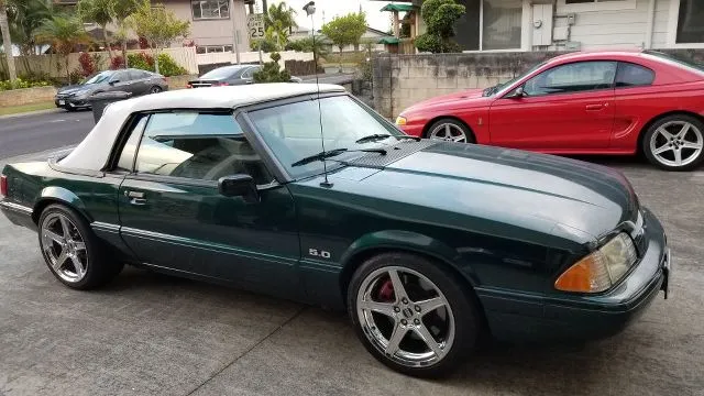

low mile,all original 7up, should I upgrade it or not?
Your buddy has a good idea. You could buy a stock rear used and have it cleaned up and painted...with new 373 gears and a purdy differential cover. Keep the original drum to drum and have fun. You'd save some money taking the whole rear to a shop for rebuild instead of taking the whole car. Also, cuts down time if you tackled it yourself.
Honestly, tasteful, reversible bolt-one shouldn't hurt the value at all. Purchase parts from top tier vendors vs house brands. Save your original parts and there really shouldn't be an issue.
SFCs are prob the only non-reversible part I'd suggest. These cars are so flexible they are almost considered a mean to preservation. Enough flex over time and things become "loose"
I agree with all of the above suggestions, keep all original parts, along with the sub frame connectors I would add a strut tower brace, convertibles develope cowel shake, because the cowl/windshield shake when going over bumps like railroad tracks, there is no longer any support in that area because the roof was removed, this will help keep the unibody solid.

That slope gets super slippery. I did gears....then 5 lug 4 wheel discs....then that transformed into heads cam intake.....which transformed into valve body converter....followed by full length subframe connectors....etc My car has a little less than 80k miles....But, like I always say, I personally would mod a 6 original mile 93 cobra...I would, trust me.
Gotta drill for a STB. At that point it's no longer reversible
Hmmm... LOTS of good thought here, THANK YOU! I still have some time to think about what to do because when I stopped by my storage shed today, there is about 5 feet of snow in front of the door! ha ha ha I like the idea of changing the axle and like it even better after what was said. Never gave any thoughts about the sub frame connectors. This car is NOT used in any type of racing, etc. Purely weekend drives and evenings to watch the submarine races... ;)

Subframe connectors are not a drag racing item or whatever some are implying. They are more of an insurance policy to keep a car with no frame tight and secure. There's no way they will affect value. I'm not going to argue this point because I have people constantly asking if I will sell my car and never once have I been told "that is unless it has subframe connectors."
I do not race any more but after owning my '88GT since new I finally (2 years ago) put a set of MM full lengths on my car. I would have loved to have done this years ago because it made a lot of difference in squeaks and rattles. The car feels much more solid. No way I'd put any other brand on and especially not bolt on. The other benefit is the seat mounts. This was what finally made me do it. After continually breaking seat tracks I finally found that my floor pan had a crack. It was letting my seat track flex and break. The connectors stopped all of that and secured my floor. Another benefit...The car is easier to jack up now. I can jack the whole side up with the jack either toward the front or back. None of these things have anything to do with any form of racing. It's just good for the car.
Bottom line, it's your car. Do whatever you like. Just don't let your car suffer like mine did for so long with no support.
Reactions: hotpony
I agree. SFCs are an insurance policy. The way these cars Flex and bend you really are preventing future damage.
I've never raced my car but did discover a tear in the floor from seat pan Flex. MM full lenght SFCs will be going on shortly.
IIRC, one of those stock low-mileage LXs that went through Barrett Jackson last year for $75k or so was bone stock except for SFCs
Reactions: General karthief
Install the sfc’s! You won’t be disappointed. No one will bust your balls about having them on the car. Like these guys said they will prevent the car from further damage, especially if your considering installing rear end gears. One of the best things I did to my car.
