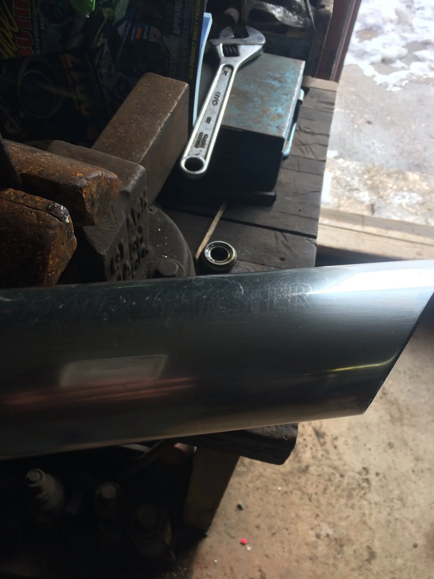

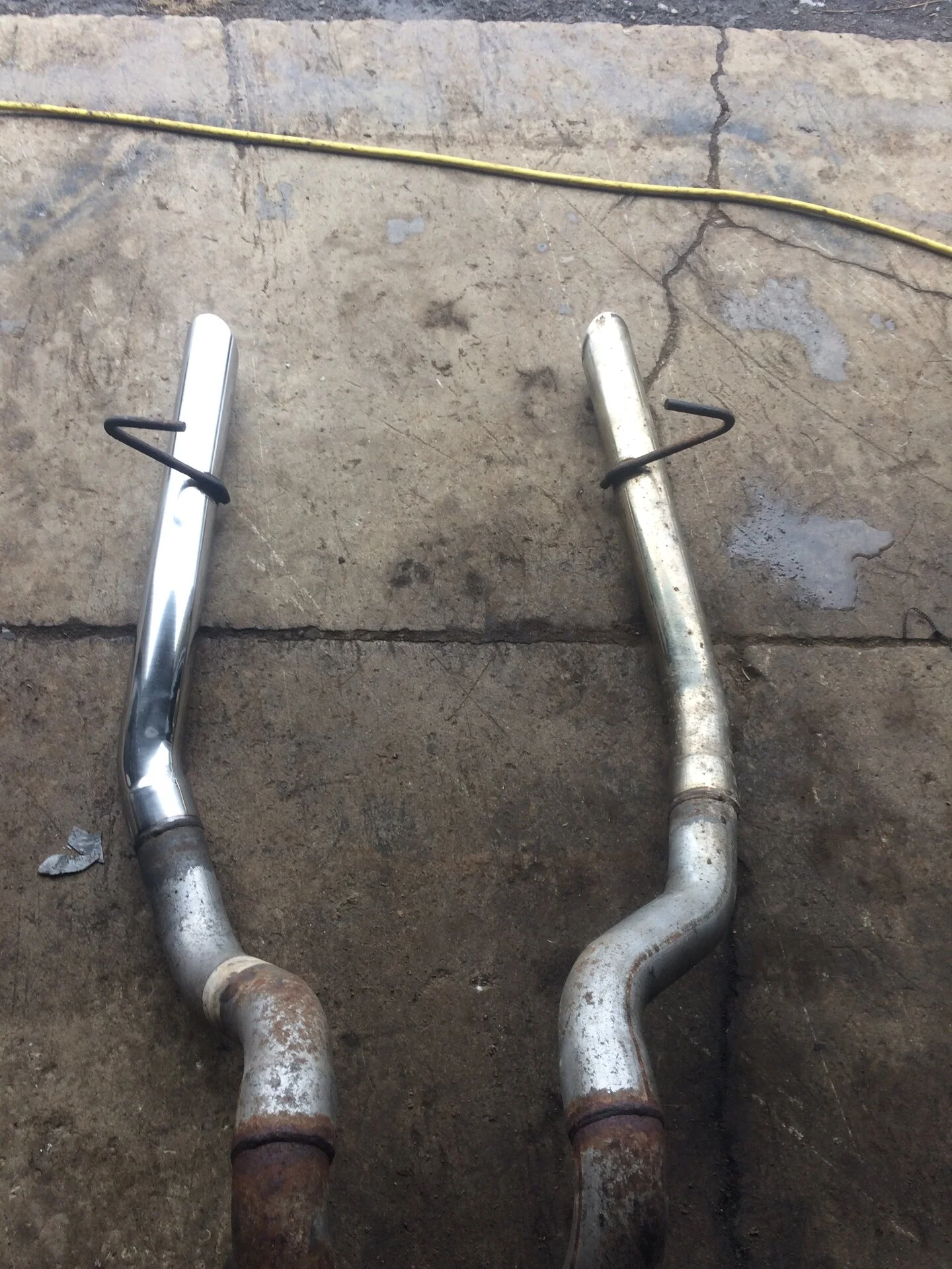

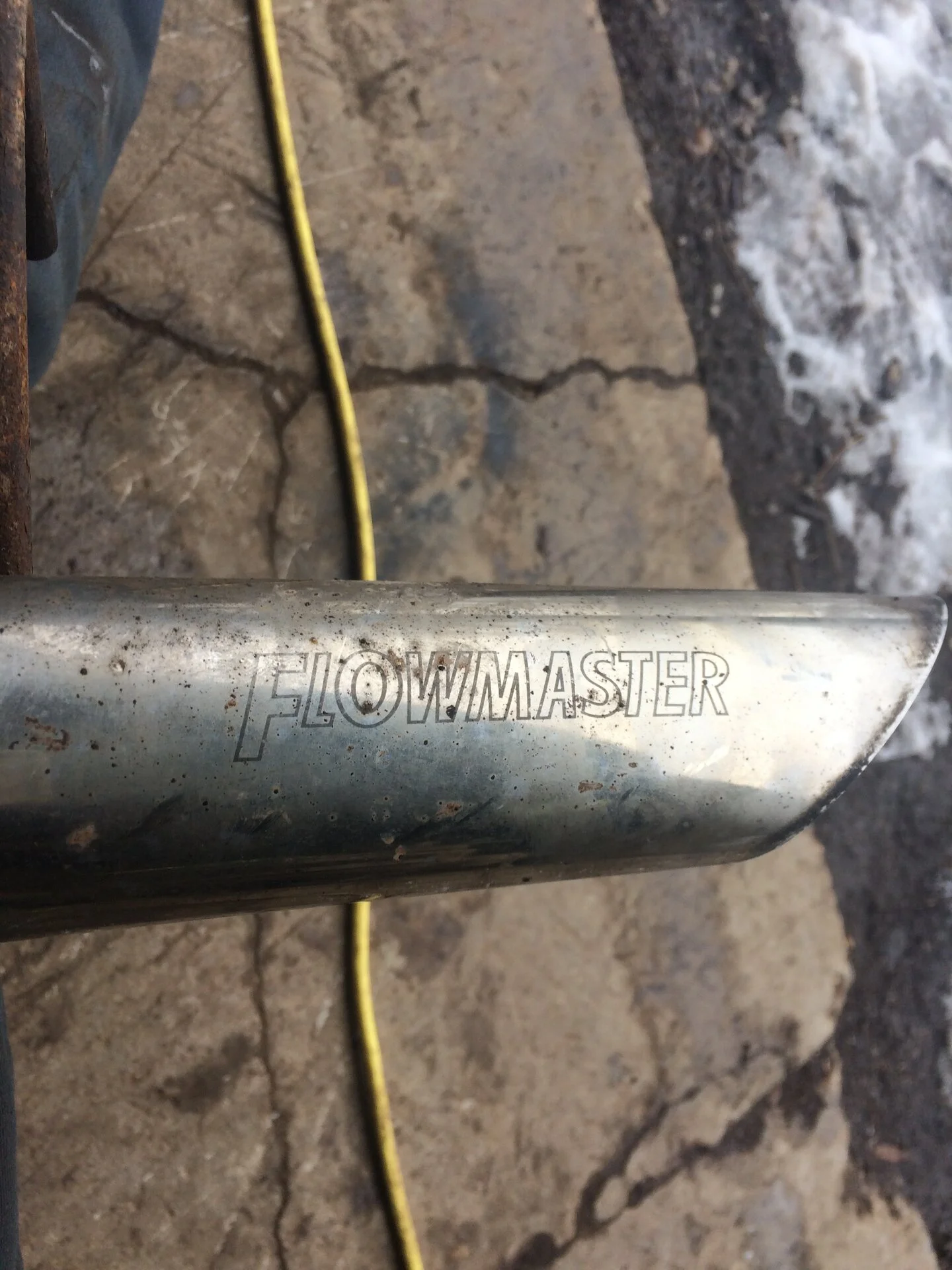

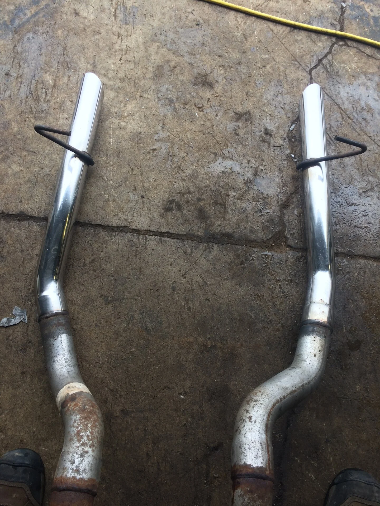

What I started with ...

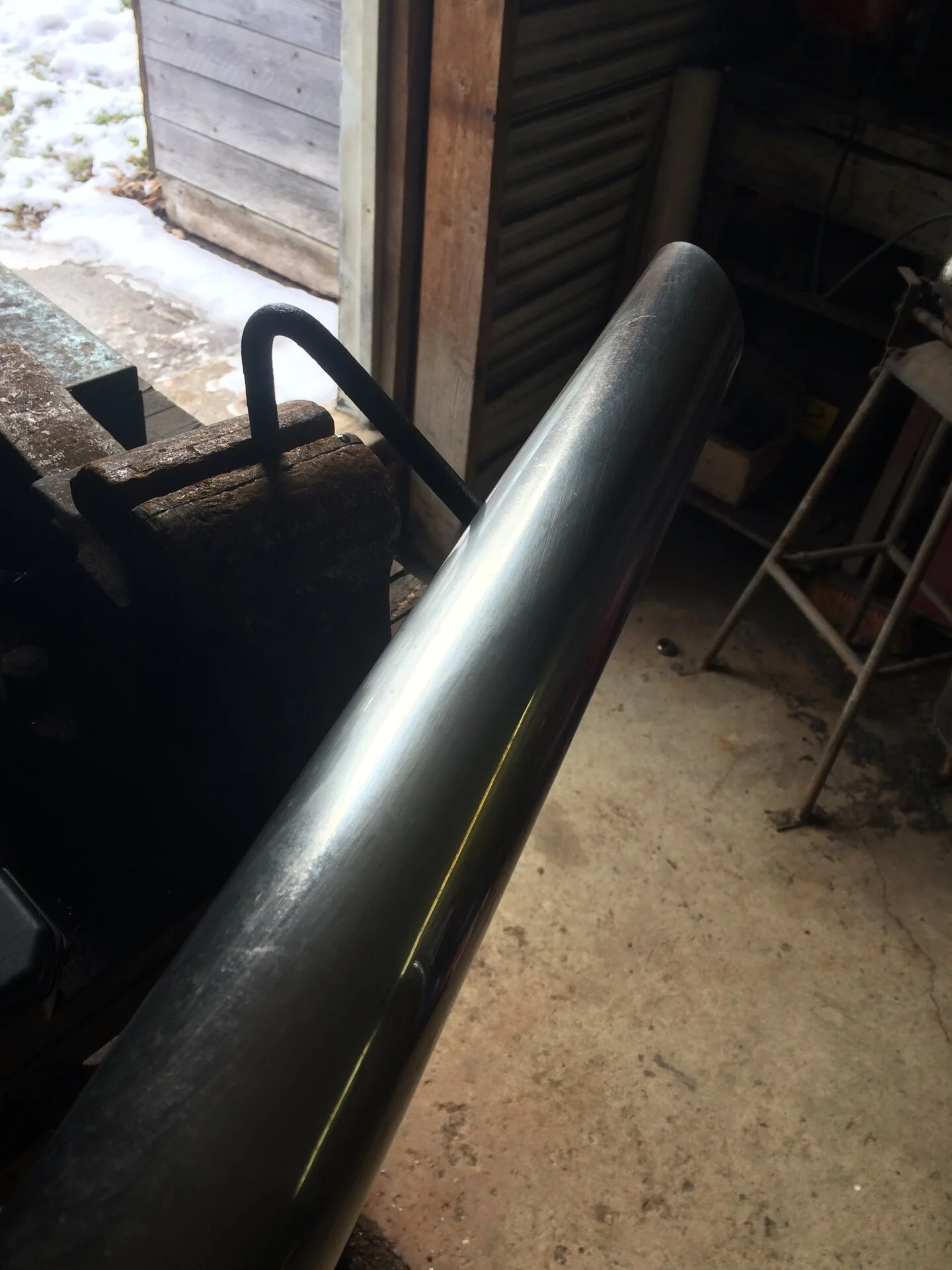

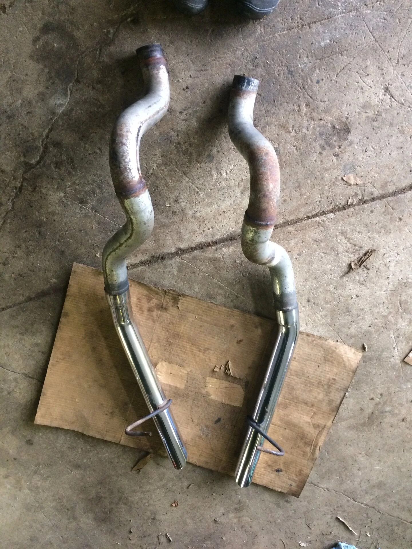

Sanded with finer and finer grits to get to 2000.

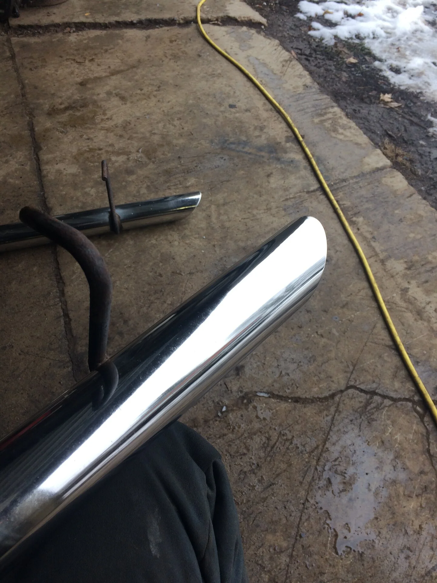

I think I used Mequiars Ultimate Compound to buff out the scratches.

I believe so. The second pic in each row is the same tailpipe (driver side). Full logo in first row, very slight logo in second row and gone (as far as I can see) in third row.
