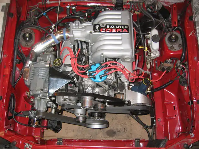

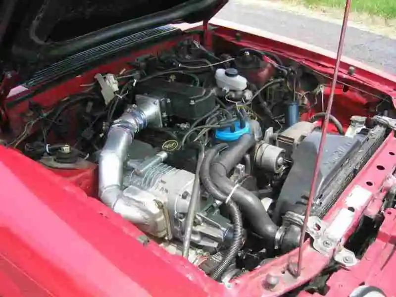

Guys have done Thunderbird SC M90's in the past. SOmeone even made a kit with a custom plenum to run these. Don't think it really ever took off.
Last M90 5.0 I saw was a complete 100% fab job. Guy had a good webpage too. Maybe you can still search for it.
Some dude was making a kit that made it bolt onto a gt40/cobra lower but it didn't take off like listed above.
Doing it like on the pics seems the easiest way.
There is a thread with a detailed build but I still can't find it.

Thats the guy I was thinking of.
I love his creativity, but just hate the look of a roots blower not sitting in the center valley of the engine. But then again, who's really gonna see it?
Yeah, that Alex guy's car moves too. He ran MM&FF a few years ago during their "Luxobarge Shootout" and came in third place behind the guy who helped me set up the blower on my Cougar.
That was back when he was still running the M90. He's got an M112 on it now (as you can see by his thread title).
