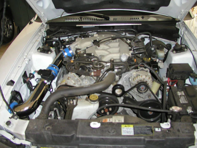

So I got my Mac CAI yesterday. I installed it today, but it seems the filter I got doesn't fit on inside the fenderwell over the pipe. Its an oblong cone filter, but when I try to install it, it hits either a) the body frame, or b) an electical box that is also right behind the fender, next to hole. Anyone else have this problem? If so, how'd you fix it? Any suggestions, should I just get a different filter?

Everything fits perfectly except the filter. I've got everything installed already, and it looks and fits great. I'm going to try to push the lower tube through the fender hole some more to see if I can have more of it stick out so the filter can fit without hitting anything.

I got it fixed. I shoved the lower pipe really hard through the fender so I had like 2.5 inches to work with underneath the fenderwell. Needless to say, it fit. Wee!
