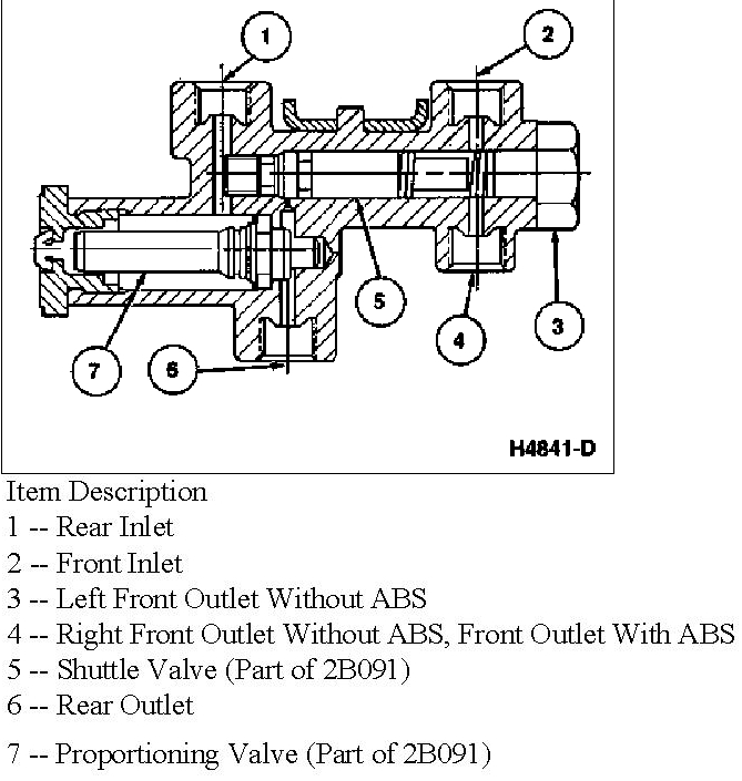

Really digging into this. How are your lines plumbed? Line on bottom of mc direct to drivers front caliper. Other two lines to prop valve.....rear line to front brakes, front line to rear brakes.

On the prop valve, the Front line (closest to the radiator) coming out of the bottom goes to the Front Right line, and the Rear line (closest to the firewall) coming out of the bottom goes to the Rear Line.... Matching this diagram....
Obviously #3 isn't used in Fox prop valves... so just ignore that one. haha, and obviously again, my car doesn't have ABS. :flag:
