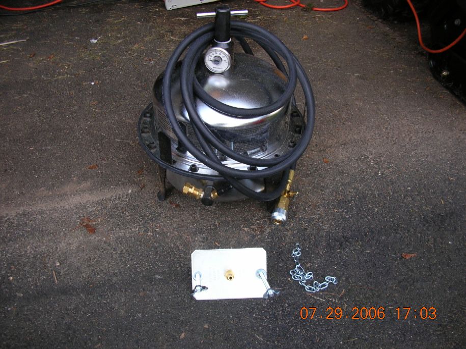

Picture of my pressure bleeder, and the universal adapter plate.
