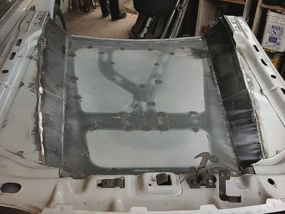

Went up and did a little more work on it.Ran out of bondo,but cut out the full amount of the cowl.Here is what it looks like on the underside.Still need to deside what i'll do for support or if any is needed and also how or what to do to clean it up some.Heres the pics for now till i get up to bens and bondo more on thursday.

looking really nice. tons of clearance.

Just throw some sort of heat shield material in there!

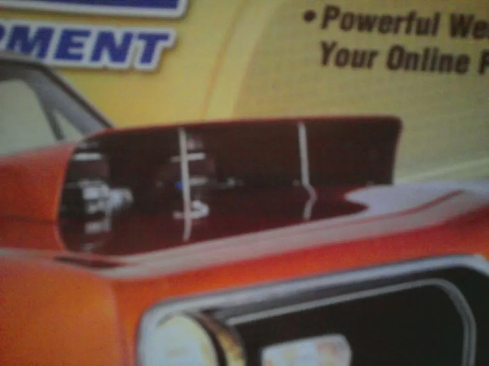

Seen this set up on summits cover page car.Might do this if i need support? peace

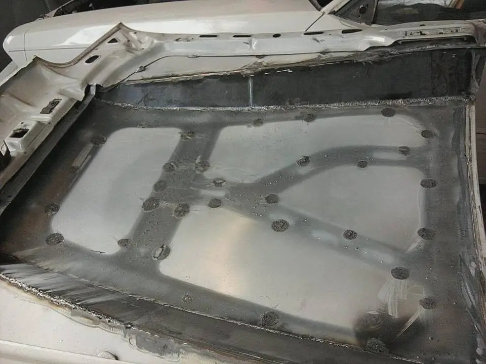

Went and spent a few more hours on it today

starting to look really good.

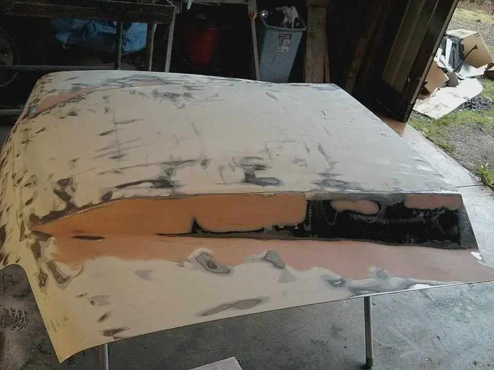

Thanks!Going tomorrow to sand the coat i put on today then see how it looks?Possibly another coat?Then off to primer!Hope to have it atleast primed tomorrow!peace

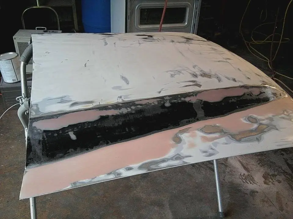

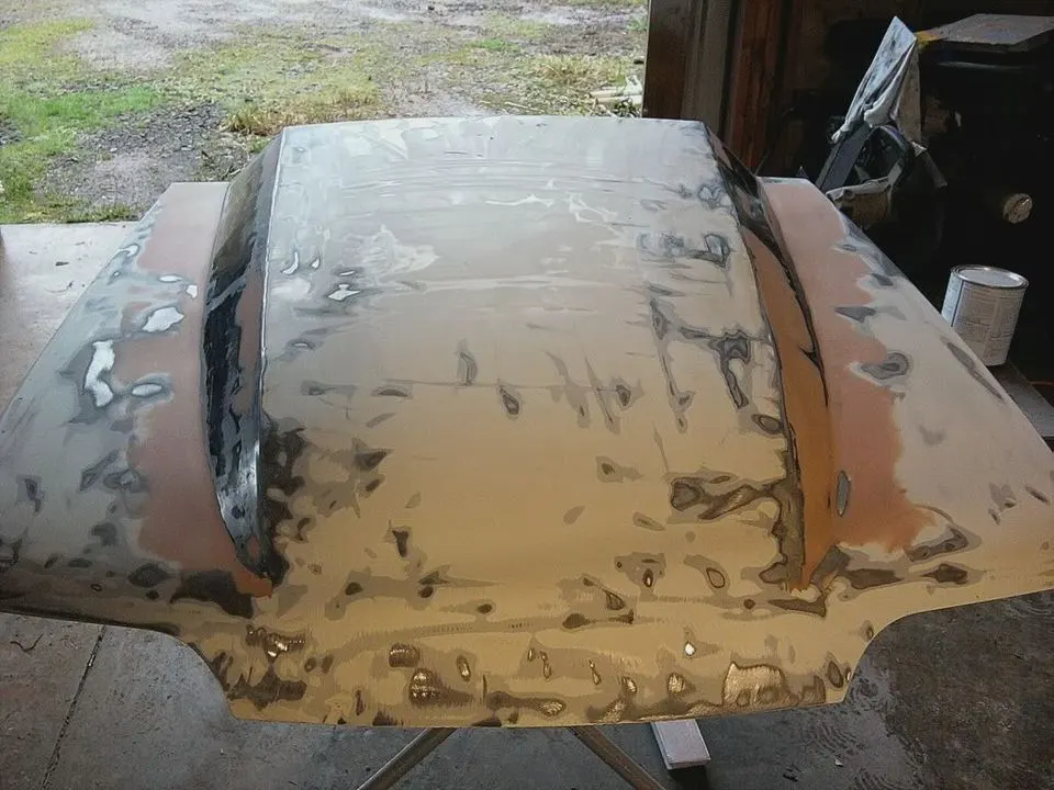

Went today and did more work on it,got it to the point (i think) it's ready for primer.So i will go prime it this weekend of 1st of next week!peace

Wow, that actually looks really good. I'll have to make final judgment once it's done and on your car, but right now I'd say it looks better than a lot of the store-bought hoods. Great work.

That hood looks great, man. Congratulations on thinking outside the box and making what 99.9% of people just go out and buy. Looking forward to seeing it finished!

OMG that's alot of bodywork, I hate bodywork. looking great.
